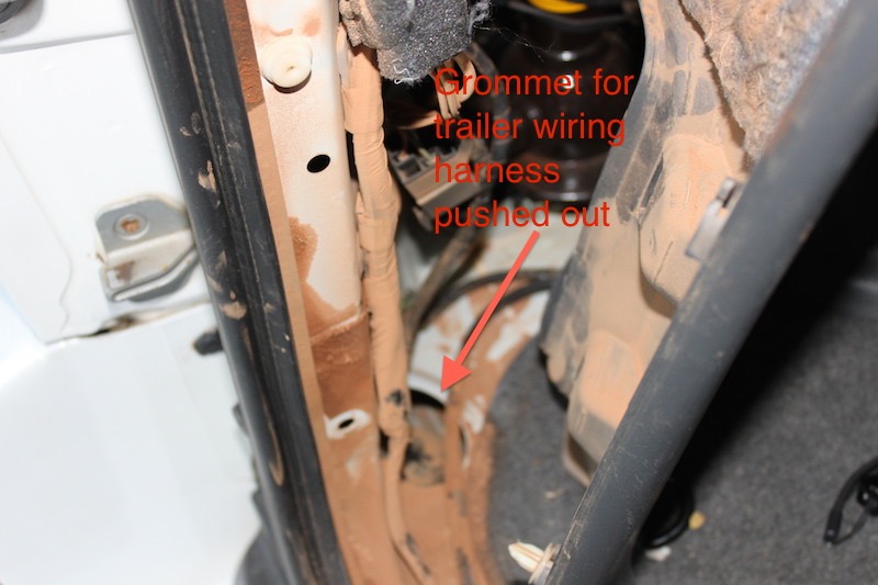

    BUT my problem is the amount of dust that is getting into the rear of the Prado. It is coming in through the grill on the driver's side at the rear near the door. So much came in you almost need a shovel to get it out. How is it coming in and what can I do about it?? Is there a way of closing that off??

    Sounds like you've lost a seal/grommet or there is dust getting in via a wiring loom. Does yours have the dual air-con? If so look at where the pipes go in behind the right rear wheel. Also look for missing bolts under the carpet for rear seats if they've been removed. Always run the fan with the switch on fresh air to positively pressurize the cabin. This will keep dust down to a minimum.

        Check where the trailer wiring comes through into the section for the jack. I had heaps of dust and found they had just cut a slot in the grommet to pass cable through. Ended up removing each grommet then sealing with sicaflex around edges of grommet .

Name:	Dust leak in Prado.jpg
