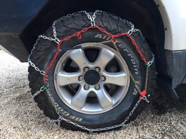

            So the chains fit easily onto the tires, Click image for larger version
ID:	653651 but as mentioned earlier do not put them on the front wheels, unless you will drive only straight. They have enough clearance for that (just) Click image for larger version

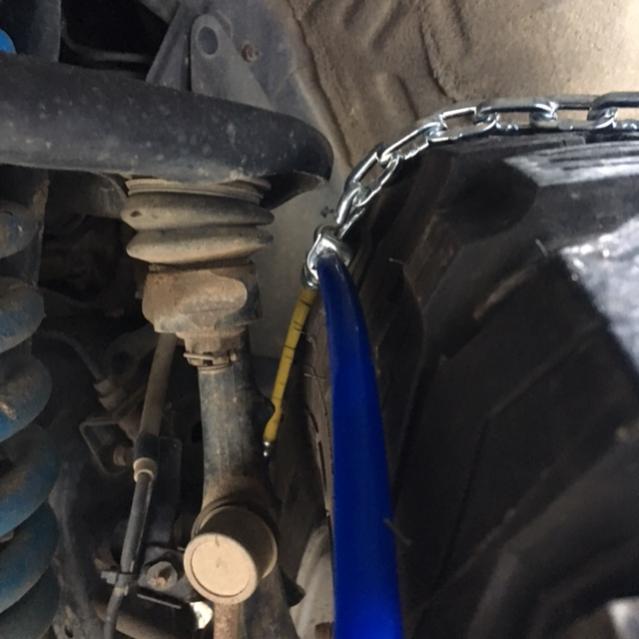

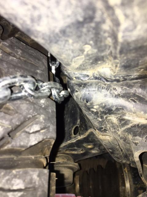

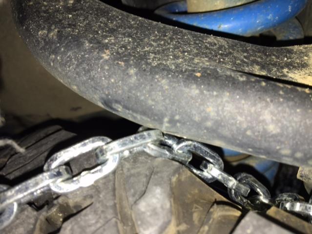

ID:	653652, but at full lock, there are issues at two places, going both directions. Click image for larger version
ID:	653653, Click image for larger version
