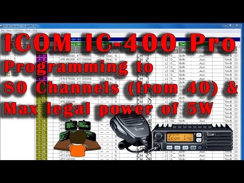

    I fitted a second UHF, the ICOM IC-400 Pro, basically the Rolls Royce of UHF radios. This is just a short over view of programming it from 40 to 80 channels, and setting the power to the legal max of 5 watts.
    great video thanks. I recently made mine 80 channel using someone else's config file, great to see what some of the data means.
