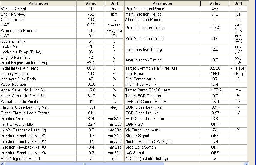

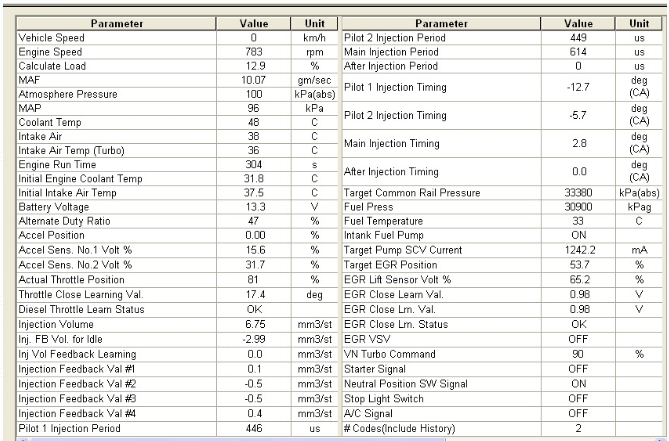

I have heavy black smoke issues with the 2009 120 d4d prado.(Took the car to 7 mechanics and including two toyo dealers and all say its fine)
But when I disconnected the MAF sensor, smoke gone.
These are the two tech stream readings first one with MAF sensor and second one with out MAF sensor.
Can some one help me.
Thanks in advance
