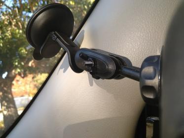

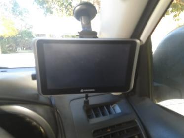

      My Prado is the 2016 GX, which doesn't come with a built in SatNav. I mounted a Navman above the driver's vent. Due to the distance to the windscreen, I bought an extension adapter for the Navman and then found I had to make an adjustable leg to support it when the going gets rough. Not the clearest picture but you should get the idea. Despite the angle of the photo it doesn't obstruct the view.
      I also have a reversing camera on my camper trailer but I've connected that into the Prado's reversing camera circuit. That puts the trailer's reversing camera view onto the Prado's main screen, so I just have the two screens.
      Click image for larger version  Name:	NavigatorLocationLoRes.jpg Views:	0 Size:	11.8 KB ID:	752819Click image for larger version  Name:	NavigatorExtensionStemLoRes.jpg Views:	0 Size:	14.8 KB ID:	752820
