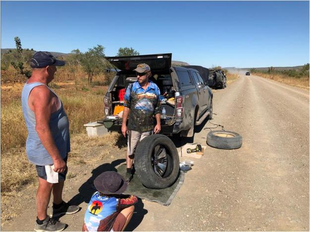

              Some tracks like the Gibb RIver Road warrant a second spare. Last year came across a couple staying at El Questro who had driven the few Kms to the Pentecost River crossing for a look. They scored 2 unpluggable flats on the way back - factory tires. We patched one to get them going. 10+ years back I scored 3 flats in one day on BFGs on the ELQ to Home Valley Station stretch. Thats why I carry the full kit on remote trips.
