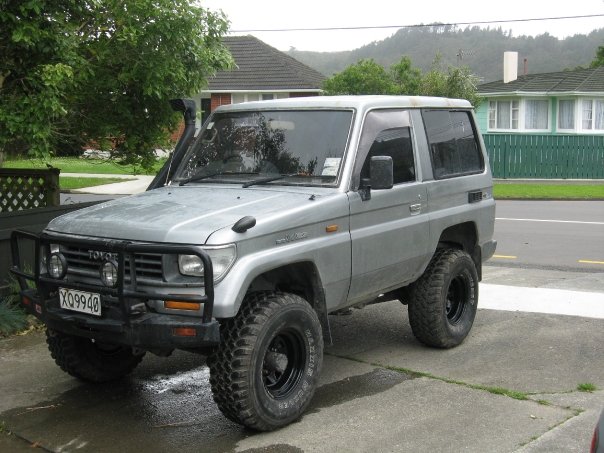

The clearance under the front looks quite low, is this because the bar and plates have been fitted and no suspension upgrade to counter the weight. Have you measured the difference from new to modified?
My 150 with Mickey Thompson 265/70/17's and a OME standard suspension (apparently you get 50mm on the 150 front end) 36lbs in the tyres, ARB steel bar, dual batteries, spotties, other small bits and pieces under the bonnet has 280mm clearance under the front end (just measured it and found some more mud from the last 2011 GTG recce
