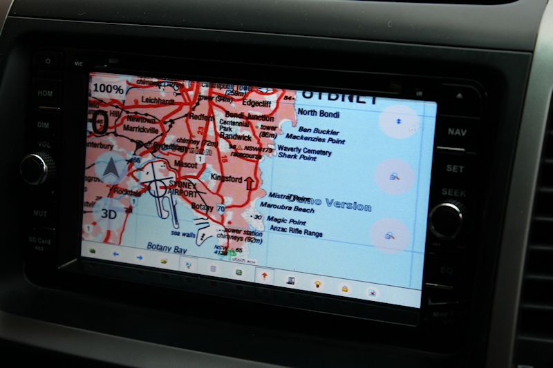

I think I have this all sorted but yet to test my set-up, anyone else out there running oziexplorer win-ce in their head units.
I run oziexplorer in my PC so have a good grounding in this software. Plan is to run the standard GPS software on one Micro SD card and have the raster 250k maps and Oziexplorer on another Micro SD. Then you swap out the cards and boot into your prefered navigation software.
1. Downloaded win-ce oziexplorer and unziped to a micro SD card
2. Converted my 250k raster maps to ozef4 format
3. Copied .map and converted ozef4 files to the oziexplorer/map/ dir.
4. Change the name of the oziexplorer.exe to match my existing default HU navigation exe boot file.
Is this how others are working it?
