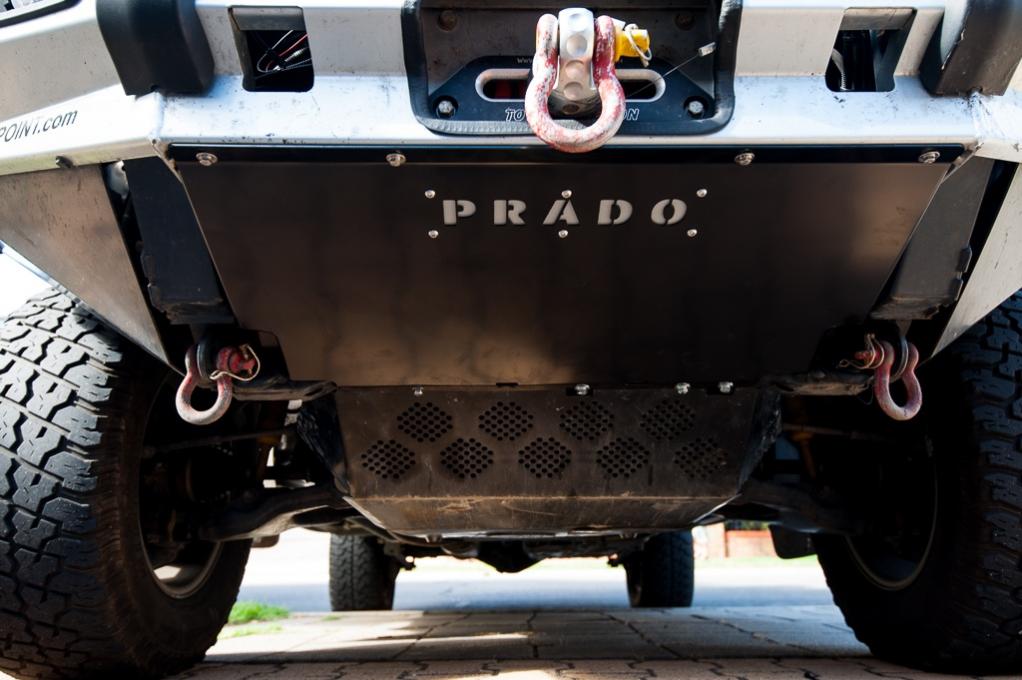

      • Amts custom plate to replace the ARB paper one is fitted. Great job by amts and I don't suspect this one will bend as easily!
