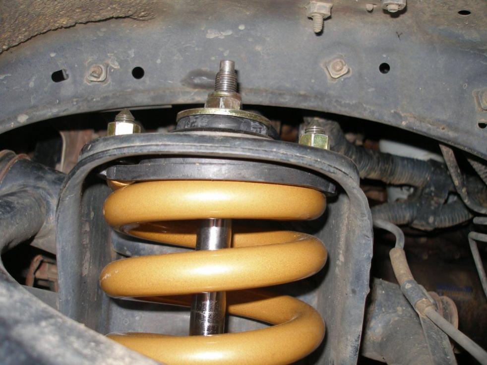

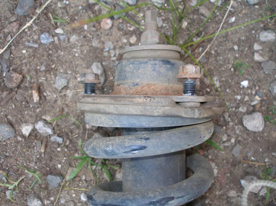

I was under the car again this arvo to re-fit old bash plates. I had a look at the top hats, and compared them to the OE items.
The TD top hats don't look like they are Toyota OE. The Toyota tops have a much deeper depression for the top of the shock to go up into. ie: the TD hats look to be of a much flatter design.
Does this make sense?
