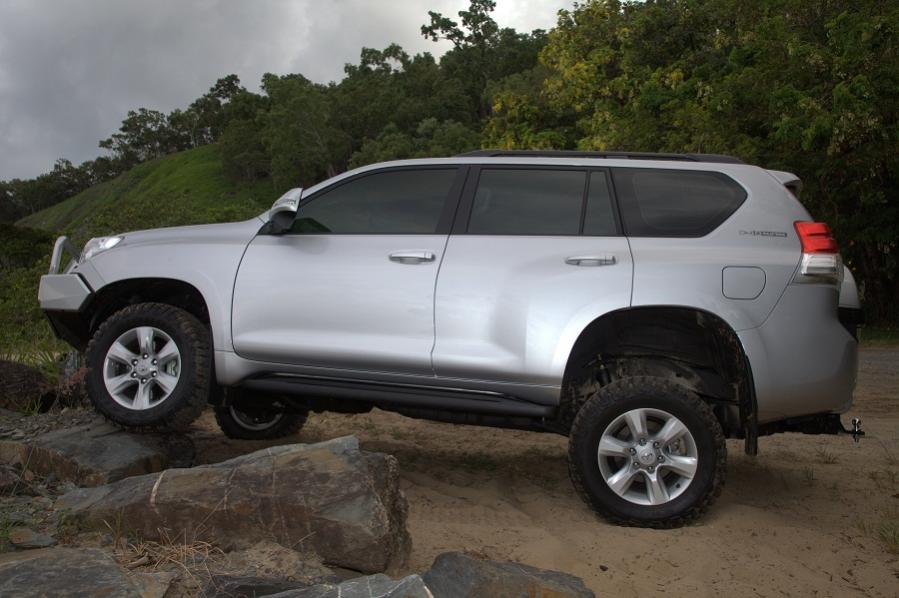

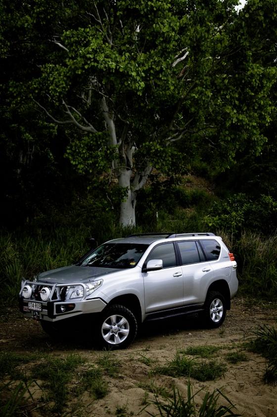

    Picked up the new rig from ARB yesterday arvo, went for a bit of a spin and to take some shots to share.
    Now to get some rubber and get her feet dirty!
