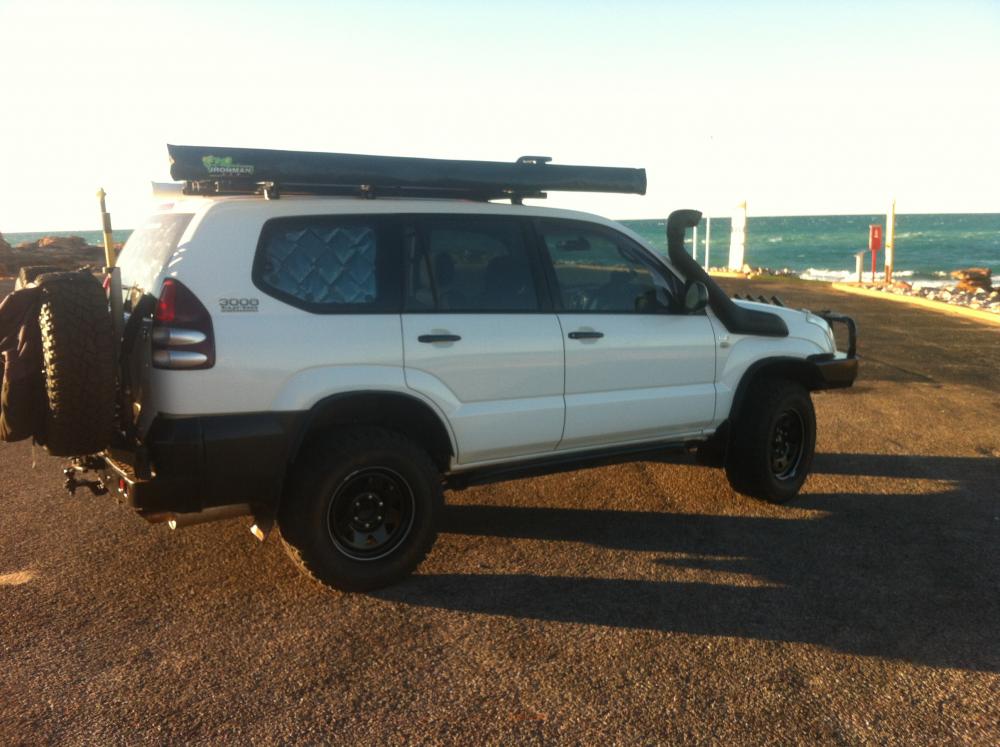

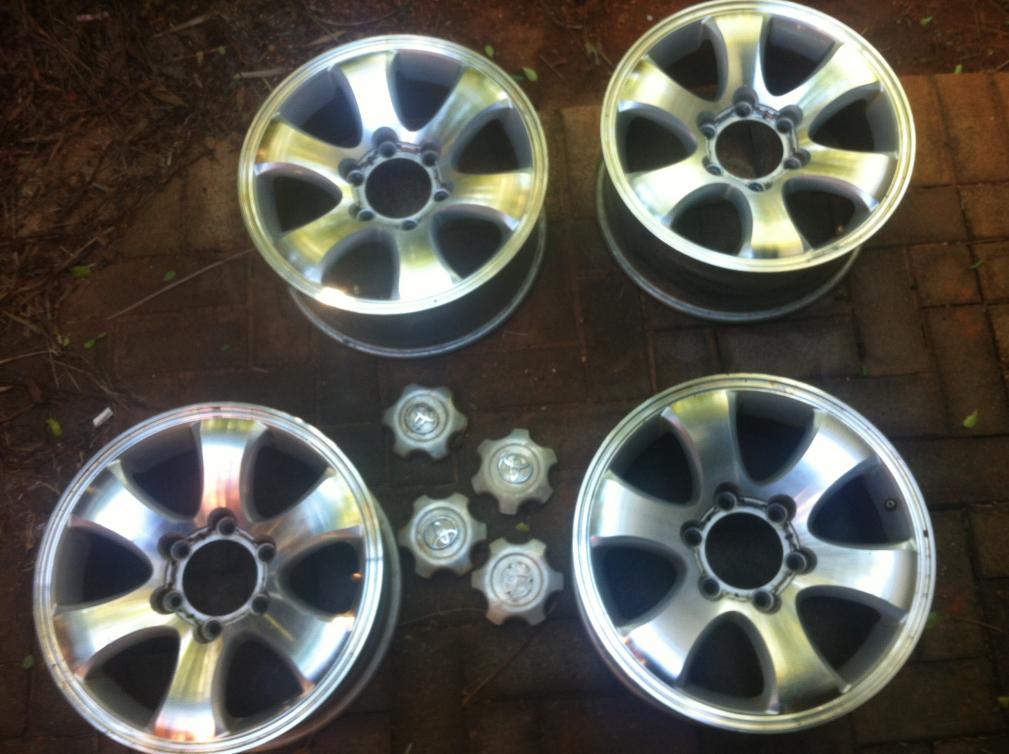

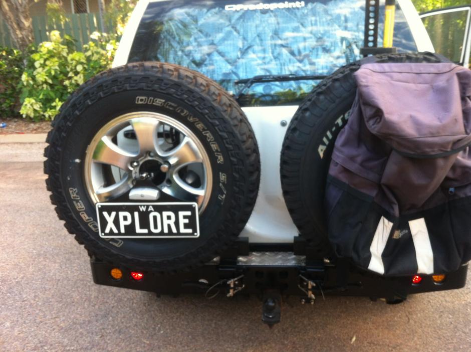

    • Found a recent pic on the phone today. Thinking about selling the alloys and fitting the King steelies all round in black. Wil also see some repairs from the latest trip. Had the rear wheel number plate bracket snap due to the harsh corrugations up on the cape road and replacement of the front wheel arch plastics are also on the agenda.

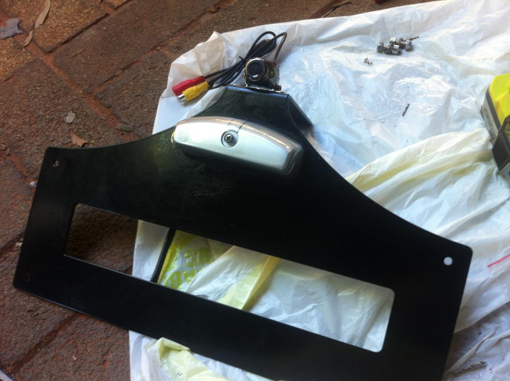

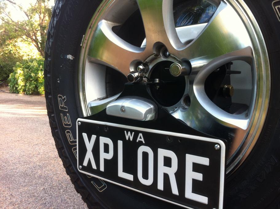

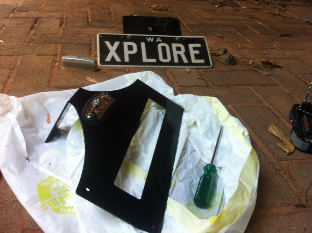

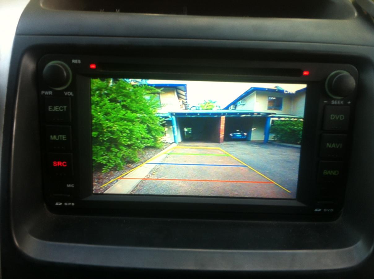

          • Upgraded the rear number plate bracket and installed the reverse camera. Set it up so that it turns on automatically when selecting reverse.

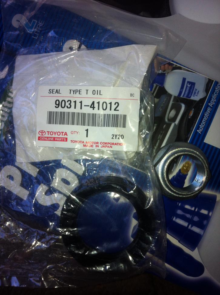

                  • Ok so had to repair a busted seal on the front of the transfer case. For others in the same predicament just make sure you let the parts department know your exact build date. Builds past 07/08 had a change in seal design. My build is 05/08 so this is the seal part number and a new locking nut;

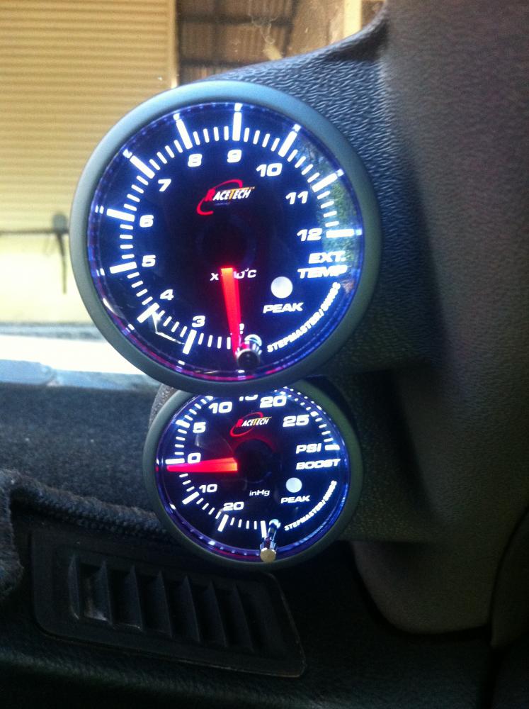

                    • Finally got around to installing a twin pillar pod and a boost + EGT gauges. Went with a brand called Race Tech. They are a smoked lense and an option of white and amber LED back lighting. I went with the white light and am happy with its display. I tapped into the fuse box underneath the steering wheel and hooked into the ignition and cigarette lighter fuses for power and display colour activation. The boost gauge at full throttle, Steinbauer on factory setting and snorkel reads a max of 18psi. The needle barely shakes at idle so all in all another nice addition. My EGT sensor is currently zip tied in the engine bay until I can tap into the dump pipe hopefully sometime this week. One thing though with the smoked lens option is that is can reflect when the window is down. No biggy as once you remember where the needles should sit it will be like the other instruments as a quick reference look. Other than that you can setup max boost and EGT levels so it can give you an audible warning and blue LED if the engine exceeds your settings.

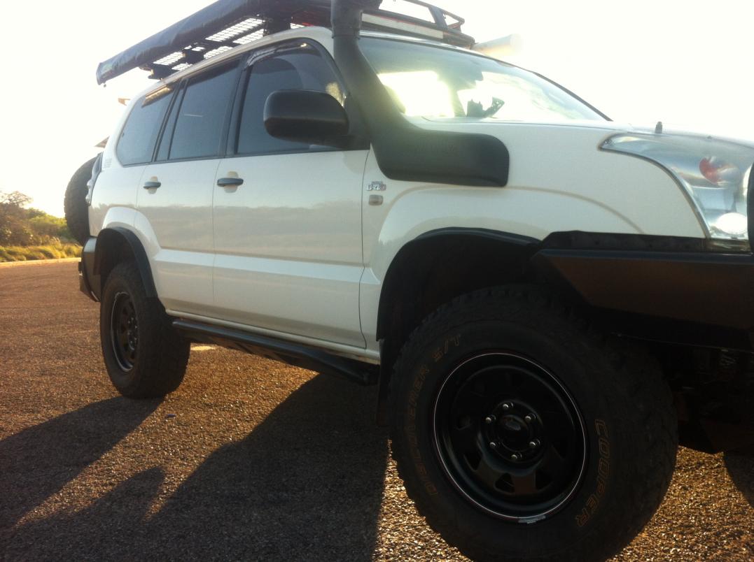

                      • After much thought and the fact I already had a spare with the same rim Ive decided to take the alloys off and bolt on some King 17" steel rims in black. Photos don't really do it justice but im very happy with the outcome. Have always been a fan of the white on black and I dare say it will be easier to 'clean' with this colour rim as opposed to the Toyota alloys. Ill have 4 rims for sale as of now and another in about 4 weeks once I get back home again and have my secondary spare swapped over too.
