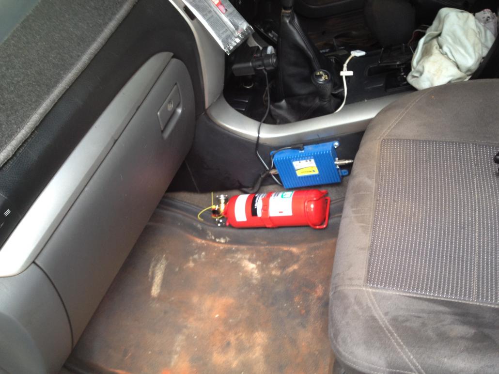

            -Installed a second fire extinguisher in the passenger foot well.

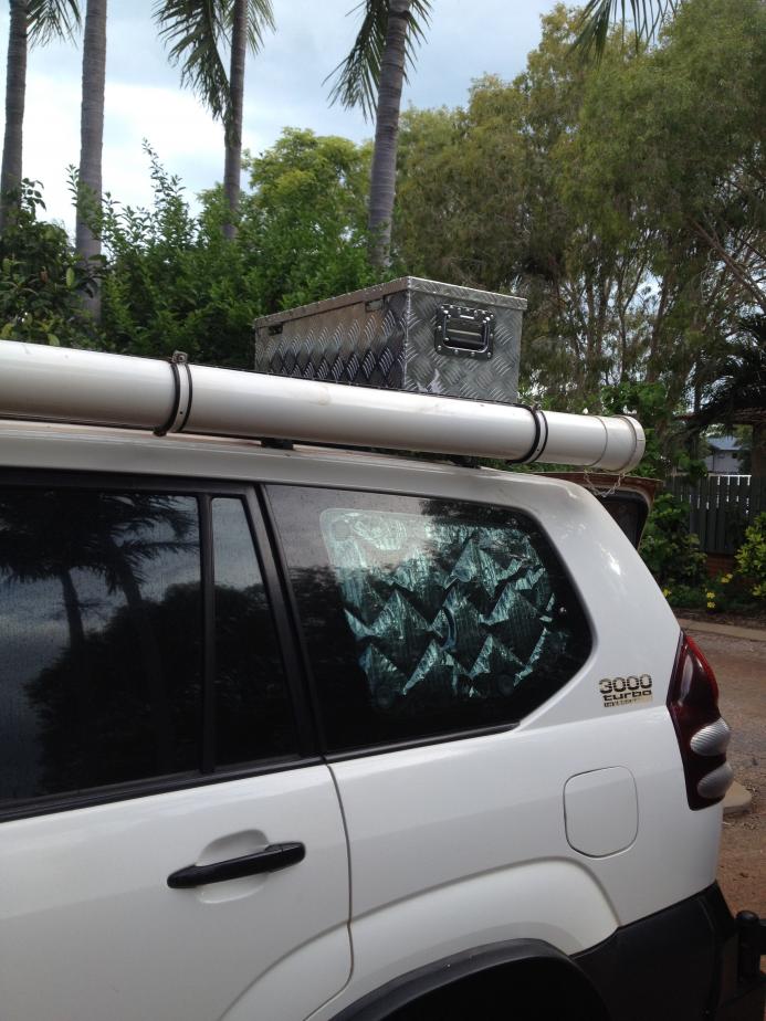

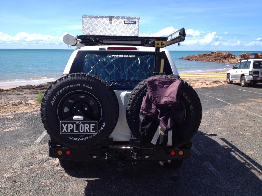

            -Made some clamps up and bolted my tool box to the roof rack. Will use this as storage for spare oil, coolant, filters etc and keeps them out of the cab. It may even house a Stihl Mini Boss chainsaw in the future.

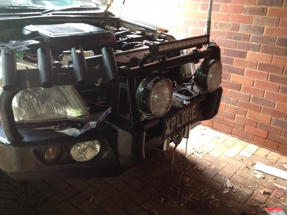

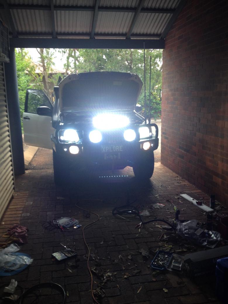

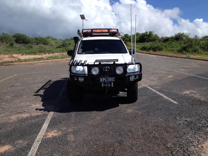

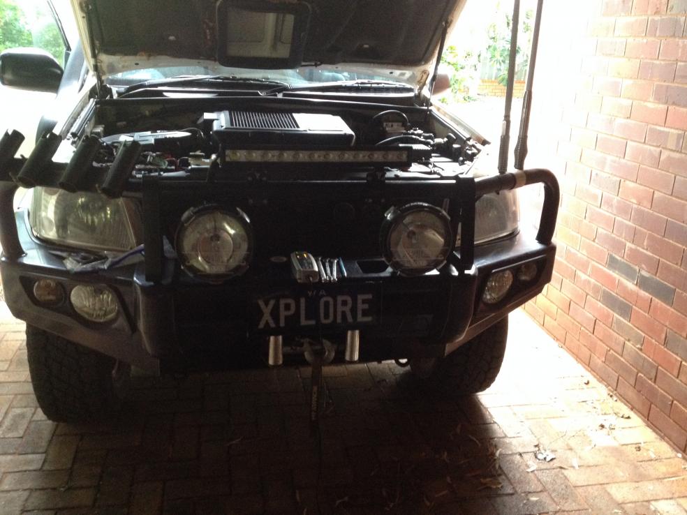

            -The Ironman store up here is shutting down so I had a quick look and picked up this 60W LED light bar for a discount. I grabbed some GME UHF mounts, gave them a quick spray of black top coat and bolted it all on. It compliments the HID converted IPF's with light output.
ID:	646182 Click image for larger version
ID:	646181 Click image for larger version

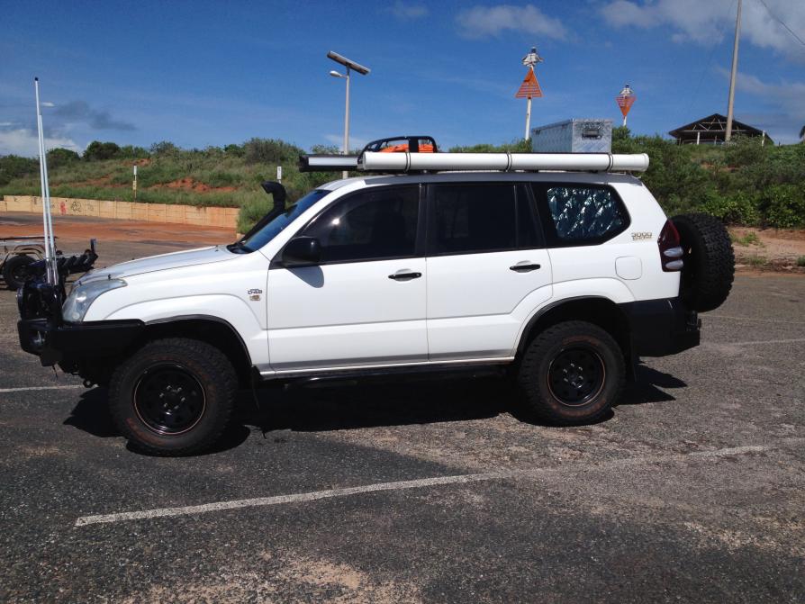

            • Gave her a bit of a clean up after a trip to Derby over the weekend. With the wet weather on its way she also copped a few cans of Lanolin.
ID:	646203 Click image for larger version
ID:	646204 Click image for larger version
ID:	646205 Click image for larger version
ID:	646206Click image for larger version

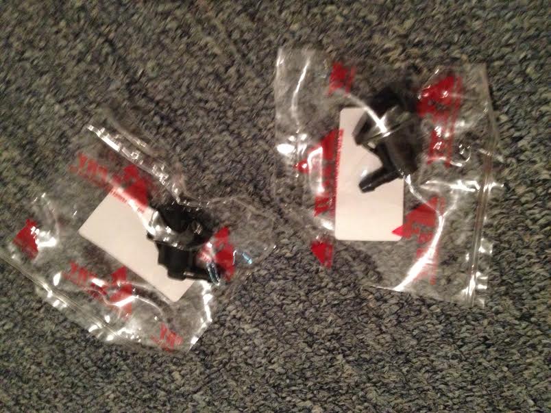

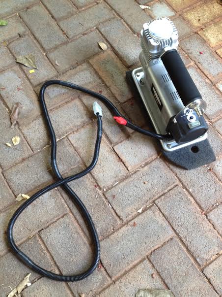

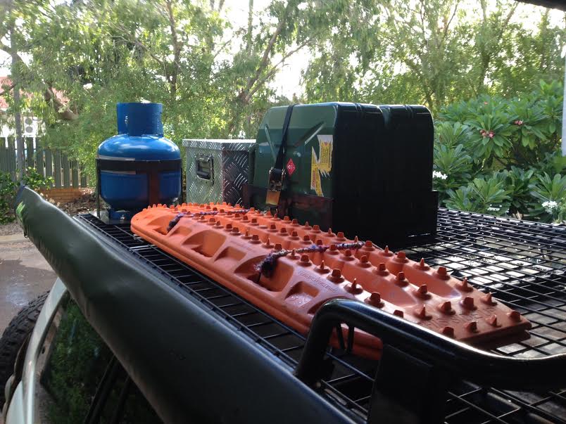

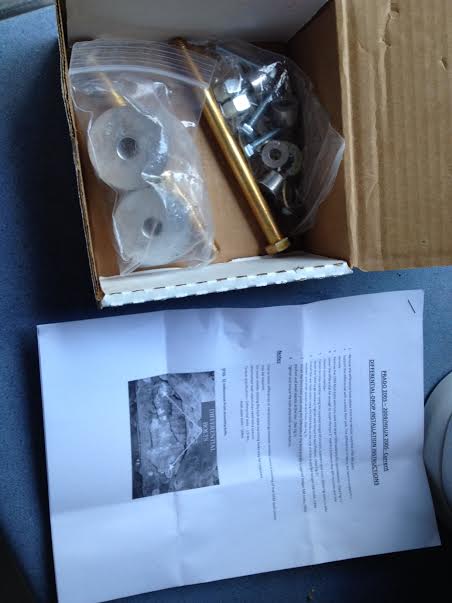

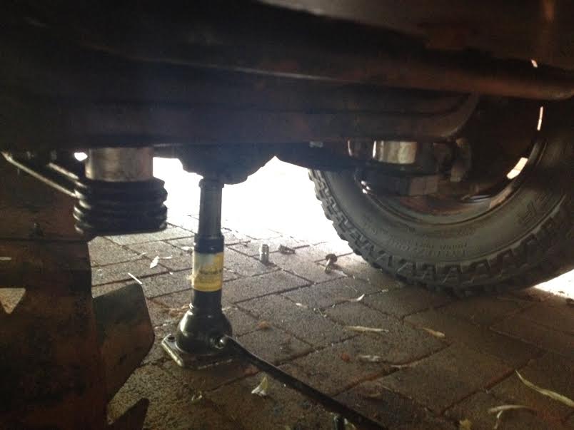

                            • Bit of tinkering today sees the install of a twin jerry can holder and 4kg gas bottle bracket to the roof rack. I also put in the diff drop kit from Ozzy Offroad/ MickL swapped the washer jets over for Hilux versions, upgraded the LED light bar brackets and rewired the air compressor that has been living in the cargo area since its change from portable to fixed. Since doing it again im thinking of now having an air tank thrown in the mix somewhere but ill put it on the back burner for now.
ID:	647836 Click image for larger version
Name:	diff drop kit install.jpg
ID:	647837 Click image for larger version
Name:	diff drop kit.jpg
ID:	647838 Click image for larger version

Name:	roof rack install.jpg

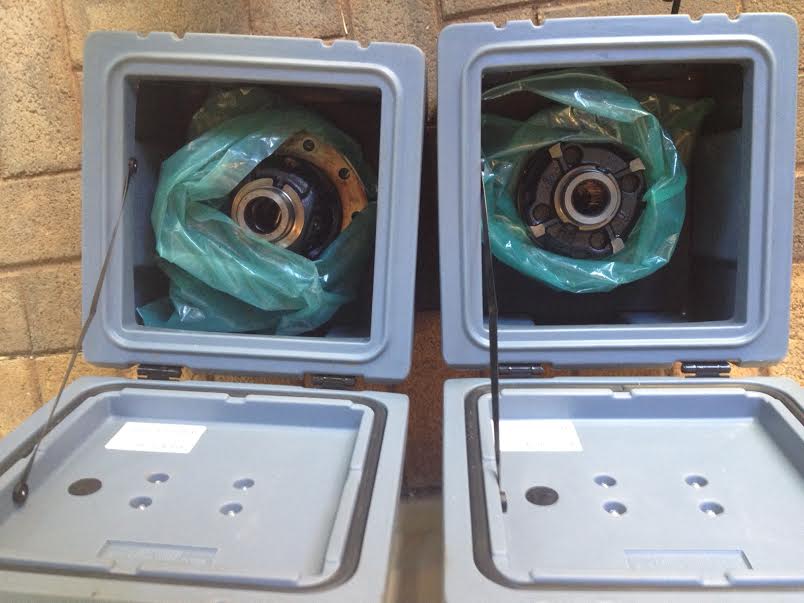

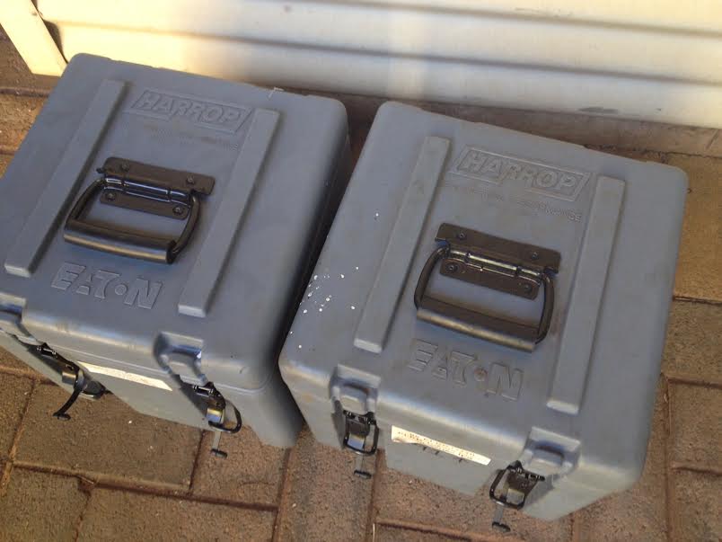

                              • There isnt much to show of the Eaton Locker install other than the original grey boxes they came in. The final switches and their position on the dash will be sorted when I get more time.
ID:	647841 Click image for larger version
