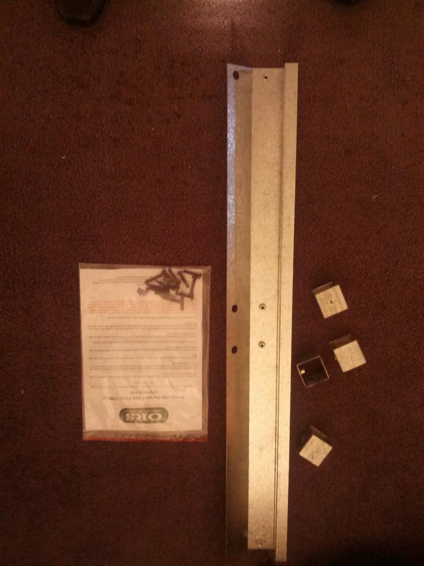

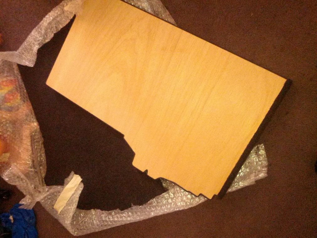

    Firstly what did I get?
    - Floor in two pieces - Left and right
    - "Cross Member" and "Spacers"
    - Screws and spikes for marking floor during install

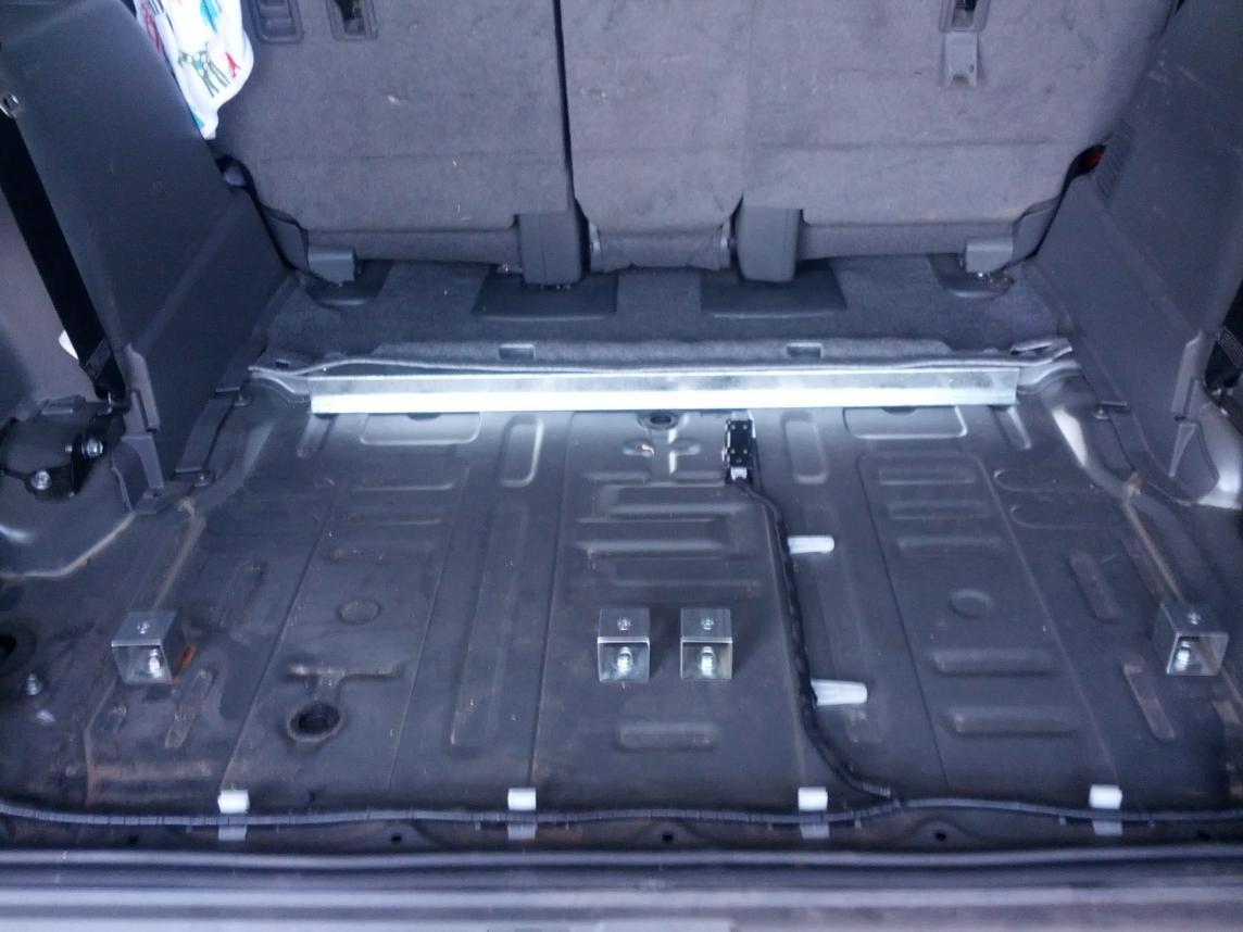

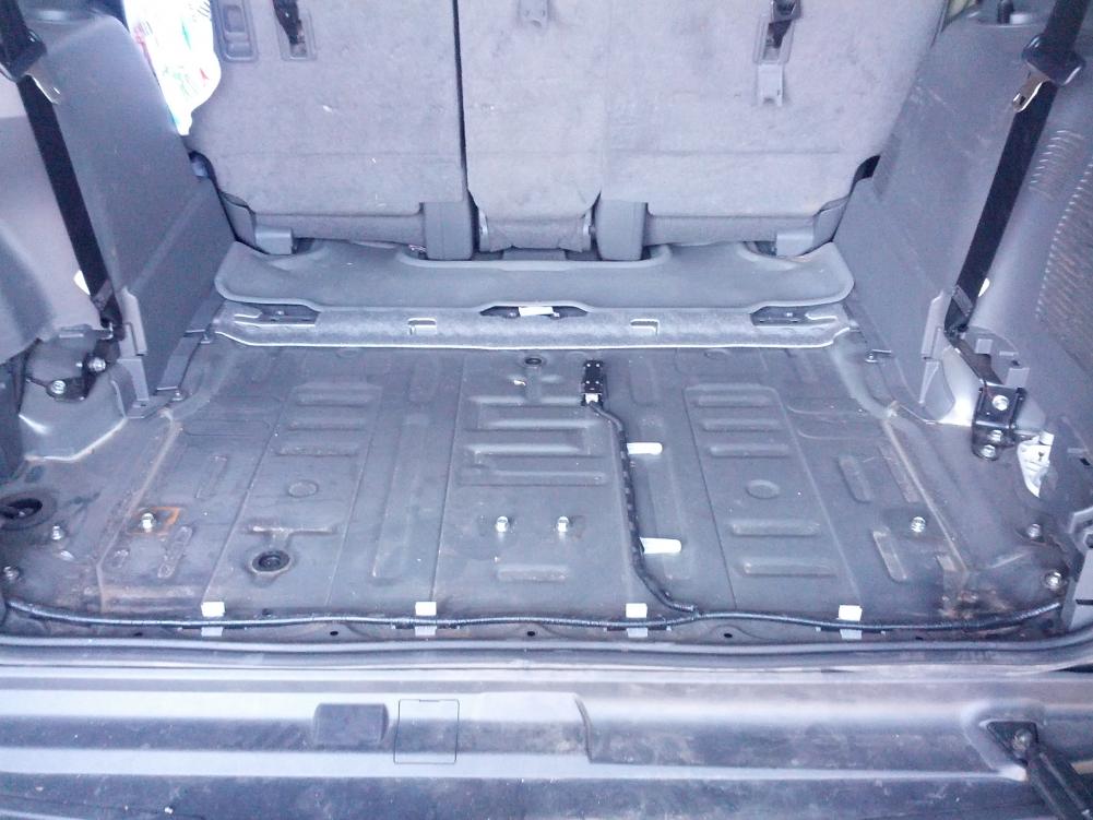

    3rd Row removed, clean starting point
    You can see I left all of the bolts installed......lucky as you need these for the ORS install.

    Install Cross member and 4 x Spacers using bolts and holes from 3rd row mounting points.

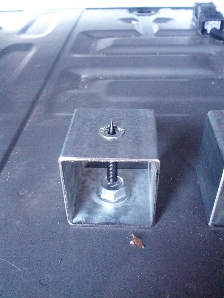

    Insert Spikes into spacers to mark Floor for drilling

      NOTE: The Spikes are to long for the cross member section as they foul on the Prado frame, so you will need to shorten them before fitting the base for marking...

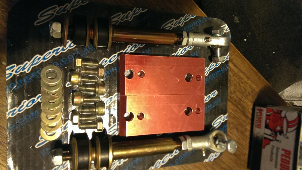

              Rear sway bar extensions and front sway bar relocation going on tomorrow night.
              Complementary stubby holder and sticker, thanks superior engineering ;-)

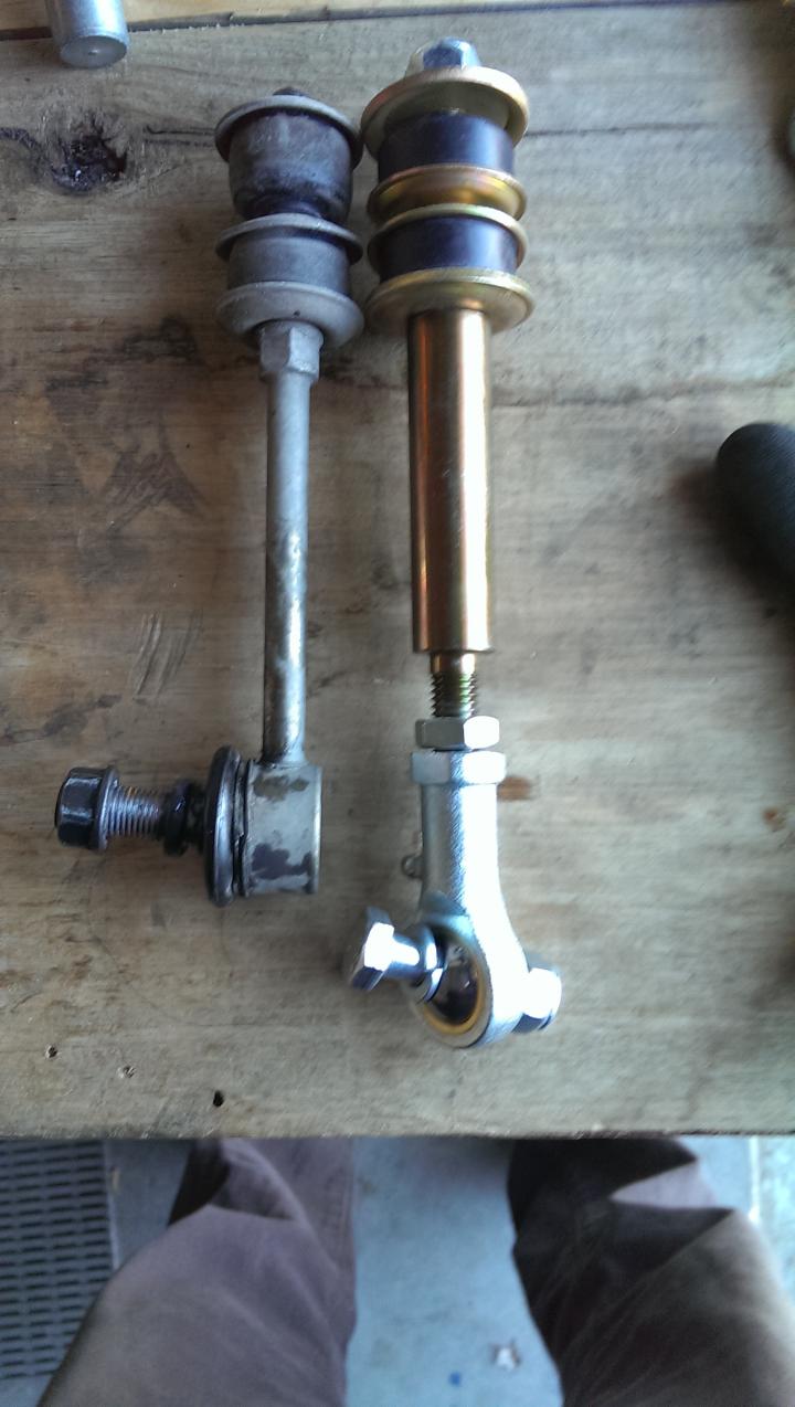

                Rear sway bar extensions and front sway bar relocation are in, took ~2 hours to do.
                Side by Side
                Rear Swaybar extensions before and after.
ID:	644693Click image for larger version

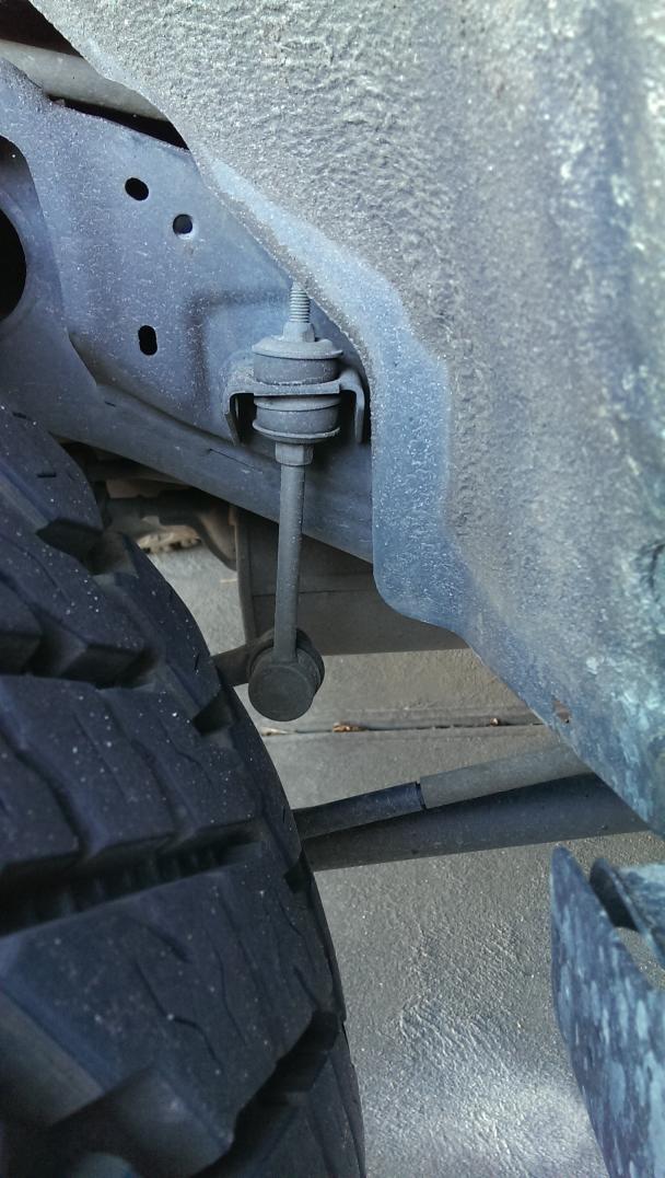

                Front Swaybar relocation (Down and forward)
ID:	644695Click image for larger version
                Went for a quick drive and noticed the following difference
                (In my non technical speak)
                Body roll I believe is the same, however there is immediate and consistent resistance to the roll where previously the roll would be more prominent at the start then restriction kicks in. This give the impression / feel that the car is a bit tighter in the corners.
                Interestingly there was no tension (or load) on the rear swaybar at all when I removed the original equipment, when install the new ones (adjusted) I had to "load up" the swaybar to fit.
                To install the front assy, I had to raise the front of the car to take pressure off the swaybar. Once this was done it was straight forward.

                          Here is another photo of the front relocation to better present how it moves forward...
