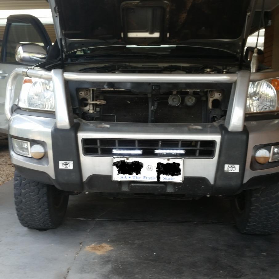

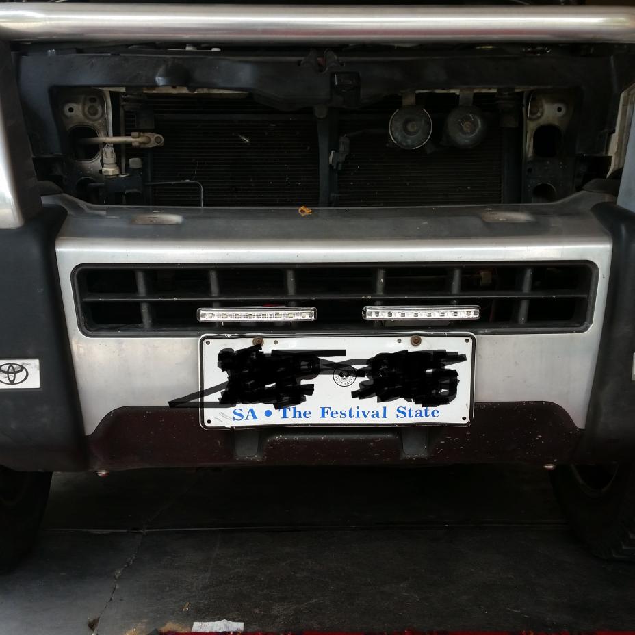

      So, I picked up a couple of cheap DRL's from Ebay the other week and got around to installing them today. At this stage they are just temporary. Famous last words.
      Working out where to put them was the 1st thing to sort out. I decided that the 'grill' above the number plate of the sovereign bar was a good spot.
      FYI this is not a legal fitting position as they need to be at least 600mm apart.
      Found it
      • The reference axis of the lamp must be parallel to the longitudinal axis of the vehicle (i.e. The lens of the lamp should be vertical to the ground and perpendicular to the direction of travel).
      • The centre line of the lamp must be parallel to the ground.
      • Lamp must be visible from 20° inboard and outboard, as well as from 10° above and below the horizontal axis.
      • Two lamps are required for motor vehicles.
      • Lamps must be mounted no less than 250 mm and no more than 1500 mm above the ground.
      • Lamps to be mounted within 400 mm of the widest point of the vehicle and no closer than 600 mm together.

      • I'm sure I've seen quite a number of factory fitted DRL's that don't meet the second point.
        Greg - 08 D4D Prado,
        • D4D - where did you find that info
          • I got that data from Hella, this is more local
            http://www.tmr.qld.gov.au/~/media/Sa...ons/VsiG20.pdf
