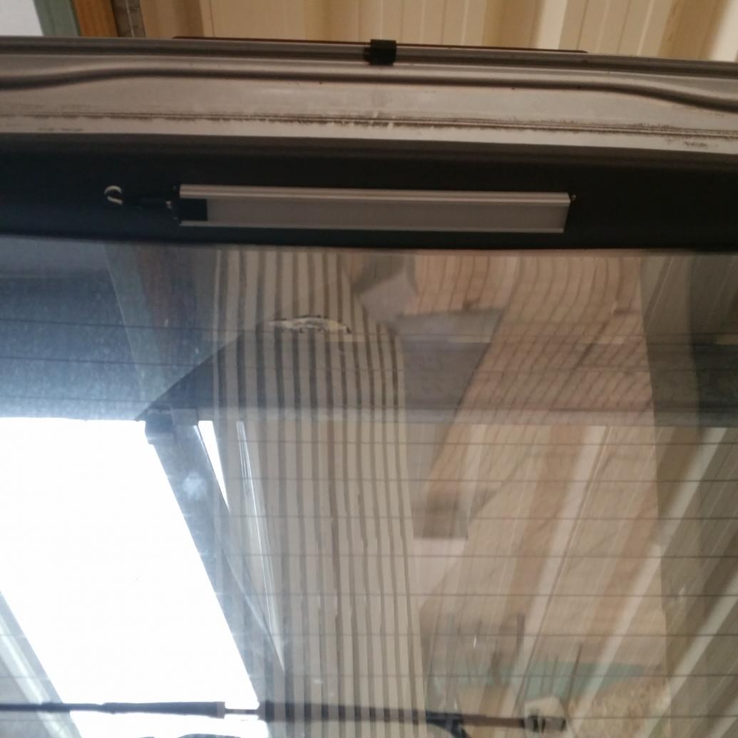

  • So, I found that my rear door table was only being used every now and then, and when it was, only part of it. This meant that a redesign was called for. No pictures of the table yet, but I installed a light strip on the rear door in anticipation of the finished table.
    This time the power comes from the cargo courtesy light. I had hoped to have the door light come on whenever the door was opened, but I couldn't work out the switching so I have left the operation to the switch on the light. It's just a Jaycar LED light all of 280 lumens, but it should do the job.

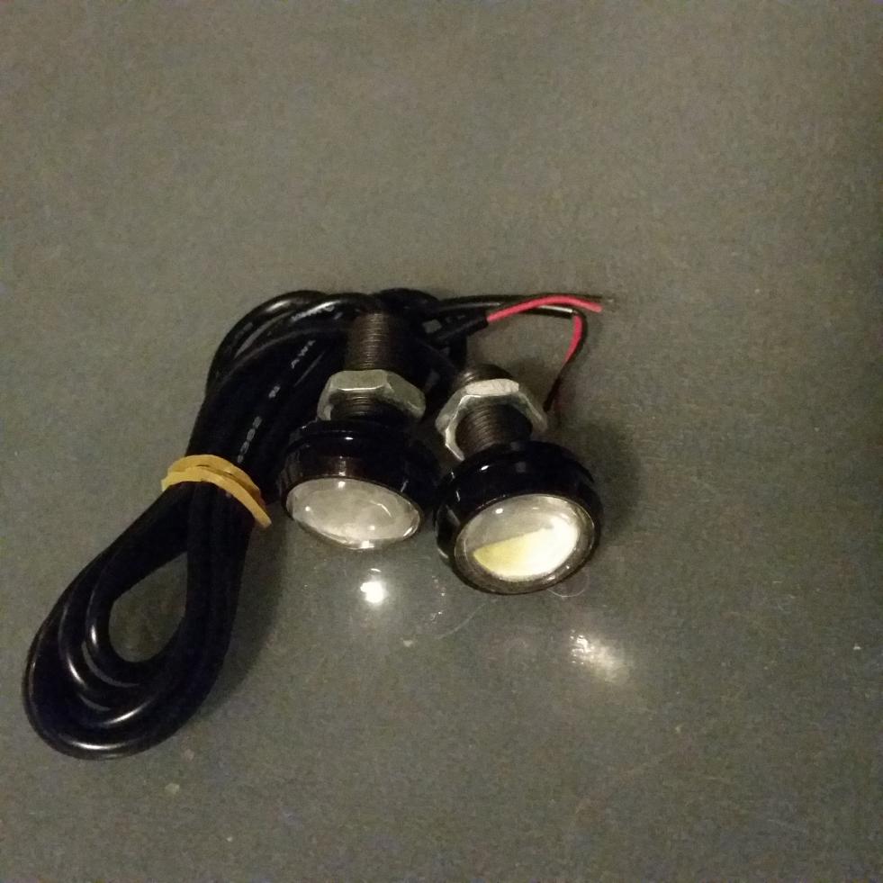

    • These are the lights that were installed in the cargo area. Need to find a home for this pair now as I bought 2 sets.
