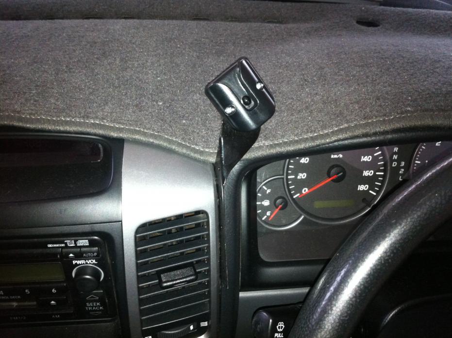

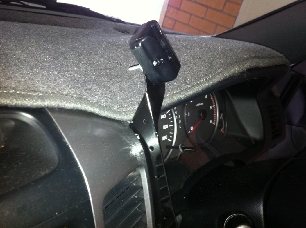

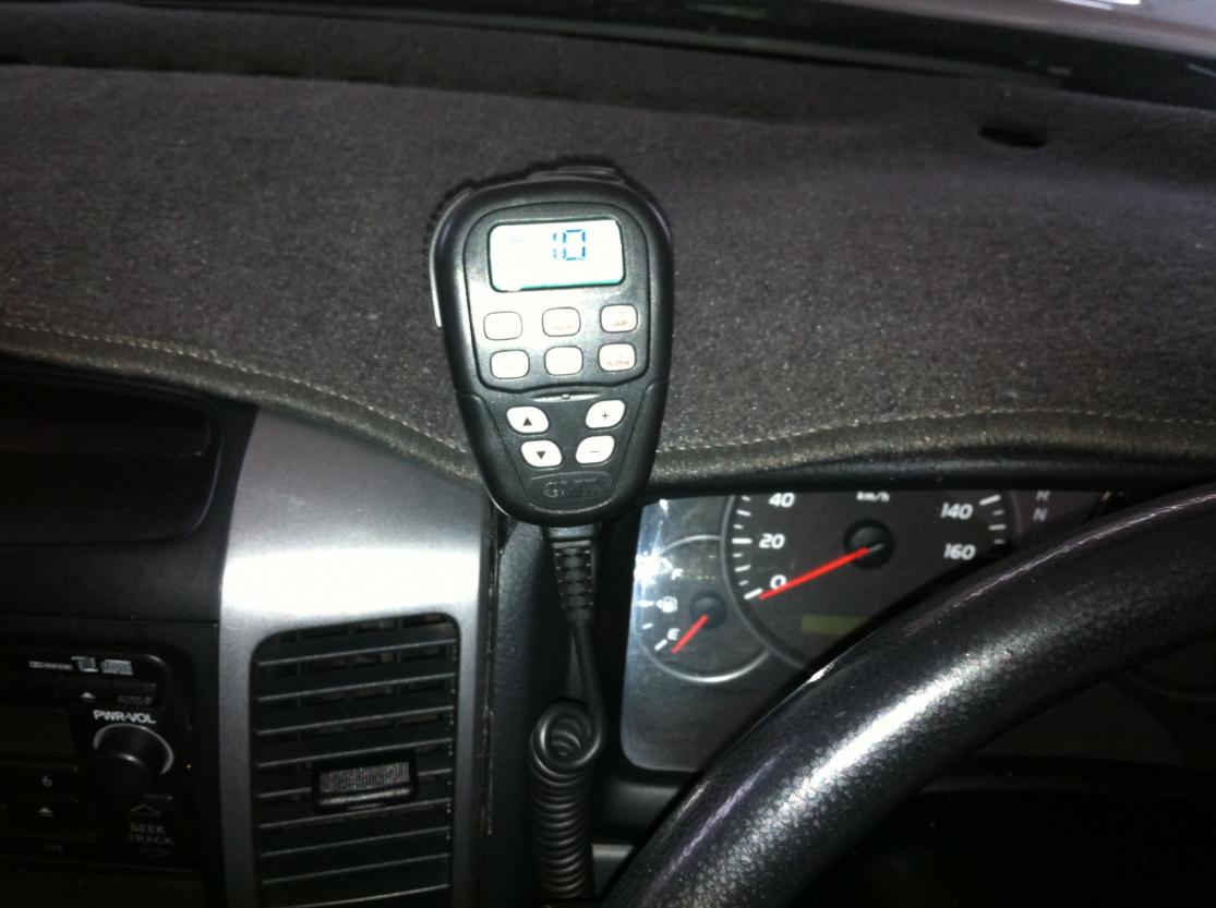

    Well I finally get the mic mount for the UHF sorted. On one of my Bunnings trips I remembered seeing someone on here use a joist bracket. This was a great idea because mounting doesn't involve drilling or adhesives. It's just a 2 second operation that involves sticking it between the silver panel and the dash surround. Once trimmed and shaped, it was painted and put in place. It's been there for a week now and hasn't moved one bit. :-)

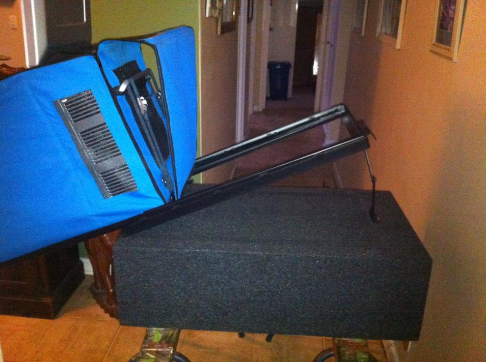

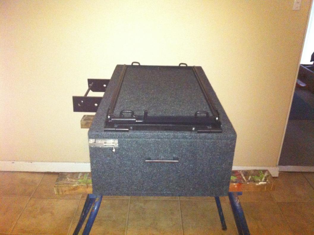

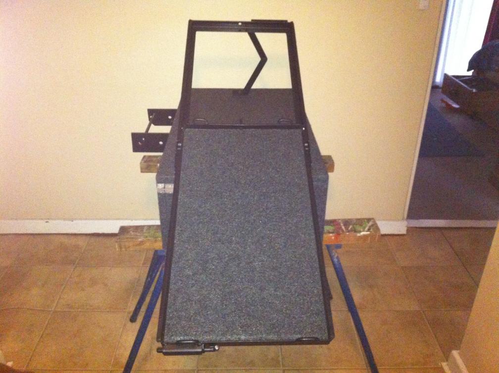

            Drawer is now finished and I'm happy with how it turned out.
            I had Trek Tech make up one of their tilting fridge slide as the wife is short and will not be able to see in the Engle when it's in the car. These things are a good piece of kit as they don't take up as much room as the drop down slide. It's well built and should last until the 2nd coming.
            All that's left now is to mount it in the car tomorrow morning and check there isn't any rattles. I HATE RATTLES!!!!!
                Question Gramps do Trek Tech have a website? How much was the slide?
                Hmm looks like an option for my second beer fridge
                Good to see the getting ready for the GTG
                • #83
                  Yes they do have a website, it's very basic with mostly photos. From talking to them, they seem to do anything from slides to fit outs.
                  My slide is for a 40L Engel so was $495.
