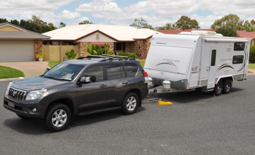

    Here are a few pics (not much to see really) stock. I will take some pics of the dual battery setup etc. and post as well. Can't wait to get her home and dirty after the facelift!
Name:	Prado and Van - Comp.jpg
ID:	658762Click image for larger version
Name:	Prado Eungella - Comp.jpg

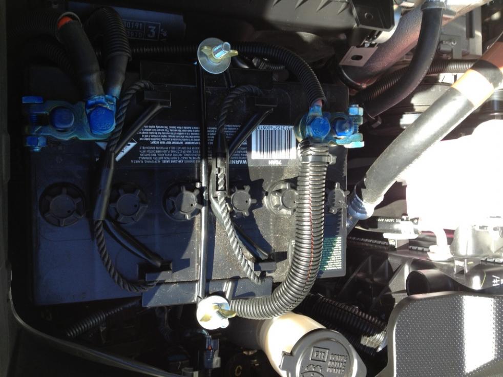

              Dual Battery
              I thought I would post up a few pics of the Dual Battery set up I installed.
              It's a bit rough and won't suit everyone, but it does the job I wanted better than I expected. The Set Up consists of the Following components:
              2 x custom (me) made mounting Brackets - $0 as I already had it!
              Redarc BCDC1240 Charger - $393 online
              Offroad Downunder Battery Tray - $175 online
              Exide ED50 - 70AH Battery - $150
              200amp constant Load solenoid (links both batteries via a switch inside to start car if Main Batt is flat) - $90 online
              60amp Manual Reset Circuit Breaker - $120 online
              Some 25amp circuit breakers, some 6B&S cable to run to Anderson Plug on Rear, some Twin 6mm cable to run to Cargo area for additional 12v plugs, 12v plugs for Cargo area, some battery cable to connect Dual Battery and a switch in the cab for the start link - Approximately $150 - $200
              Total = $1,078 - $1,128 approx. I was quoted double this by certain 3 letter 4x4 accessories outlets.

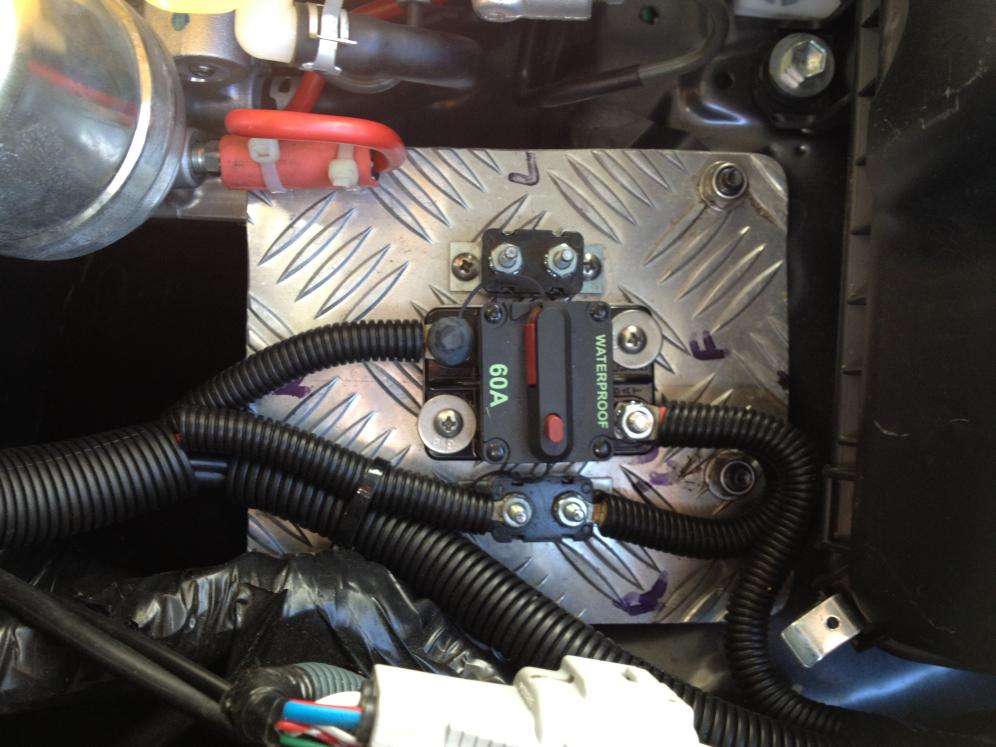

              NOTE - DO NOT use Checker Plate for the mounting bracket! I did, as I thought it would be stronger, however mounting the Circuit breakers on an uneven surface was a nightmare. Use a piece of 5 - 6mm flat aluminium.
              Bracket and Manual Reset circuit Breaker on Driver Side Behind Airbox

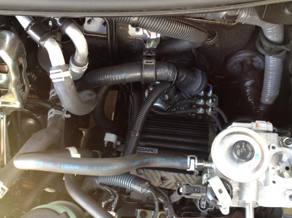

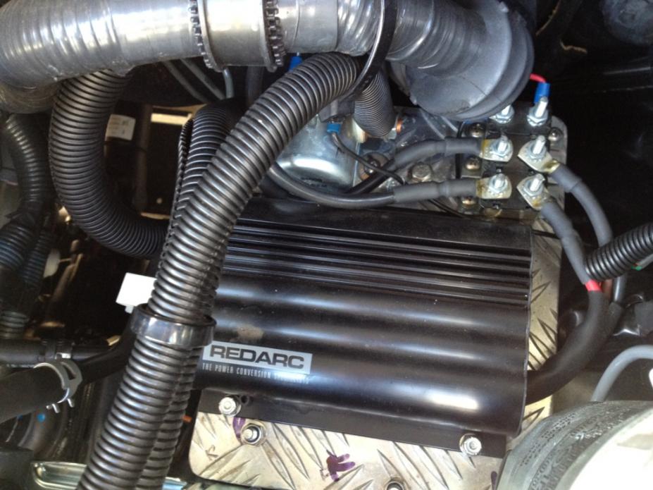

              Redarc BCDC1240, Start Solenoid and Circuit Breakers - mounted on Passenger side on top of inner guard.
Name:	IMG_0273 - comp.jpg
ID:	641944Click image for larger version
Name:	IMG_0274 - comp.jpg
              Dual Battery
Name:	Dual Battery.jpg

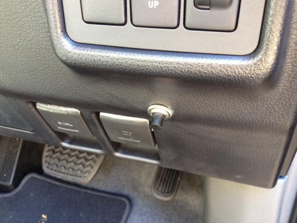

              Link Switch inside
Name:	Start Switch.jpg

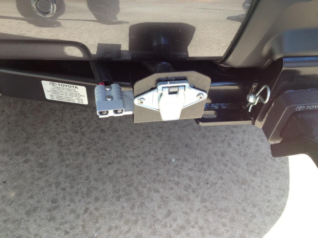

                Anderson Plug - Ran 6B&S to this rather than twin 6mm cable to ensure less voltage drop to Van.

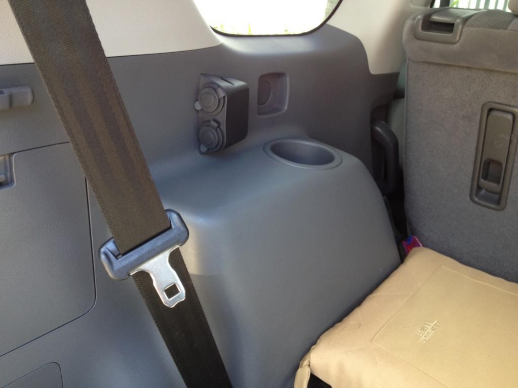

                12v outlet in Cargo Area
Name:	12v in Cargo.jpg

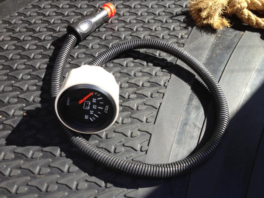

                I did not install a battery monitor as I really do not need it. For camping, I made up a tester out of a VDO Voltmeter, some twin 6 and a cigarette lighter plug. I just plug this into the 12v outlet attached to the Second battery in order to check it a couple of times a day when the fridge is running. I can get enough of an idea from this whether I need to go for a drive or set up the solar panels.
Name:	VDO Voltmeter.jpg

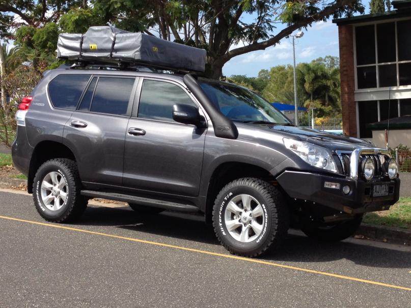

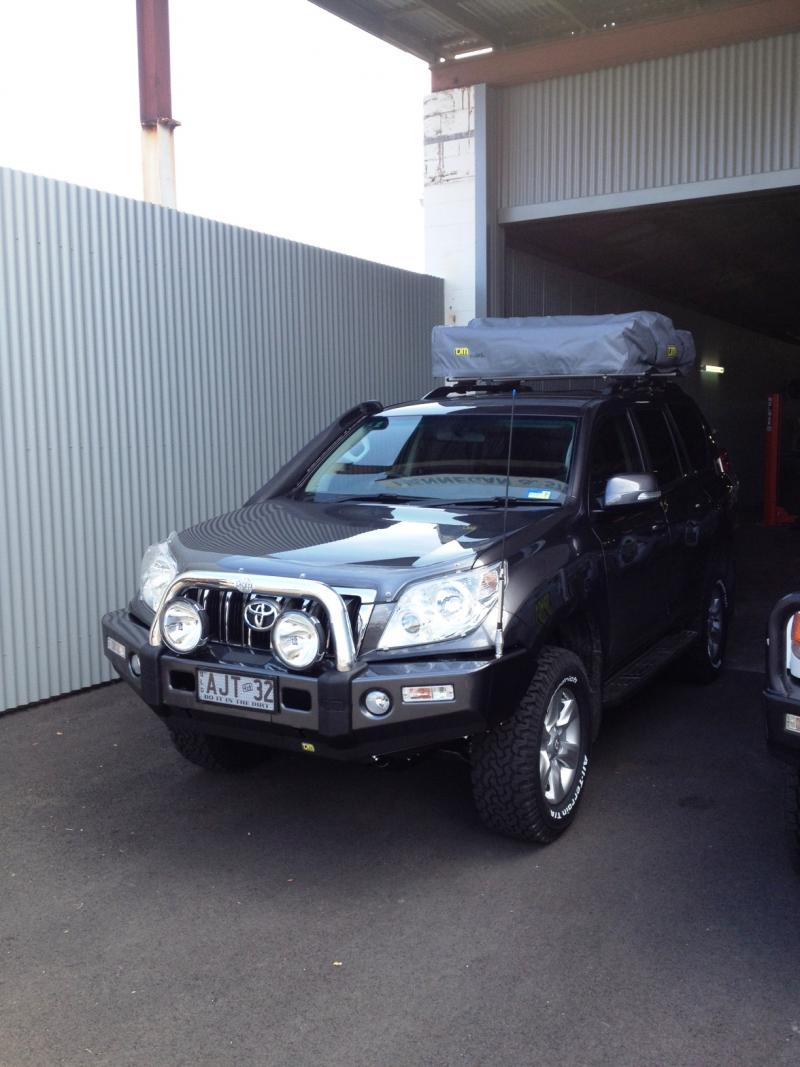

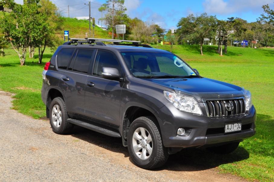

                            Just picked her up and must say I am very happy with the new look.
                            I have only driven for about 40k so far but the suspension and tyres seem to work very well and the ride is exactly what I was looking for, not too harsh and still precise - Very Early days obviously, so time will tell.
                            The quality of the install and the service I received from TJM Rockhampton was excellent.
                            Now I can't wait to get her dirty, might have to venture up the sandy tracks at 5 rocks this week-end!
                            Here are the first pics (on my iphone unfortunately):
ID:	642018Click image for larger version
