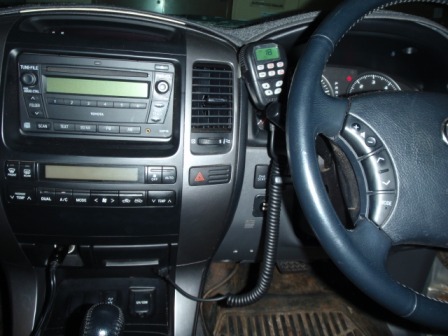

          • Mounted the main unit on the spare braket up under the steering (under the dash).
            Ran the extension to the mic out below the ash tray.

            So now installed as neet as I will do (although there was some concern when I was caught attacking with the drill and large bit).

              • Was worried that it might be a bit quiet, mounted under the dash, but it is surprisingly loud.

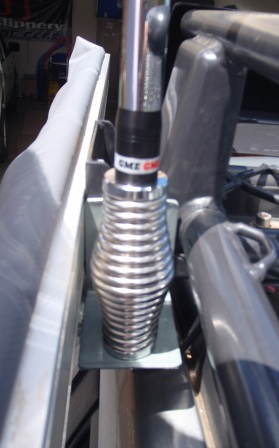

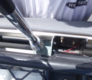

                • Finally got the antenna installed on the rack. I was planning to mount it on the bracket that holds the awning, but the spring wouldn't fit, so instead of shifting the awning out I made up a bracket to go onto it.

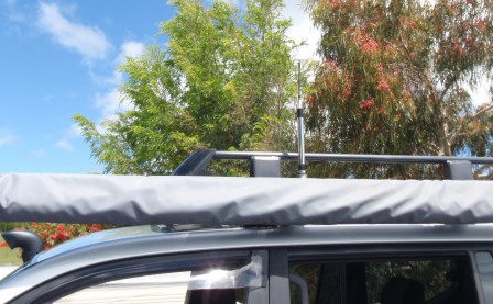

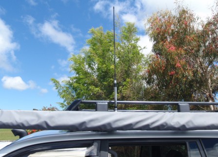

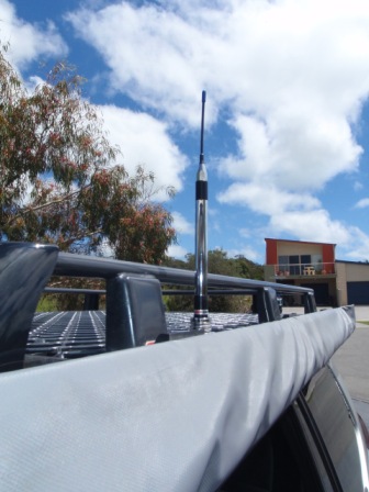

                  • I can just get the Prado into the garage with a stubbie whip on (plus the stubbie keeps me below 2.4m tall so can still get into most "height restricted" areas in Tassie).
                    The stubbie suits for around town and most situations, but I can swap whips to the 4018 when needed.
