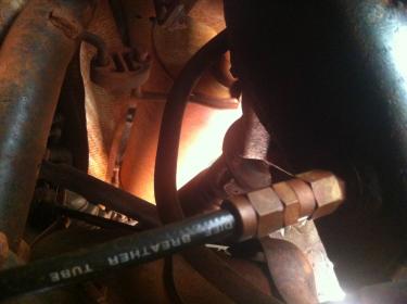

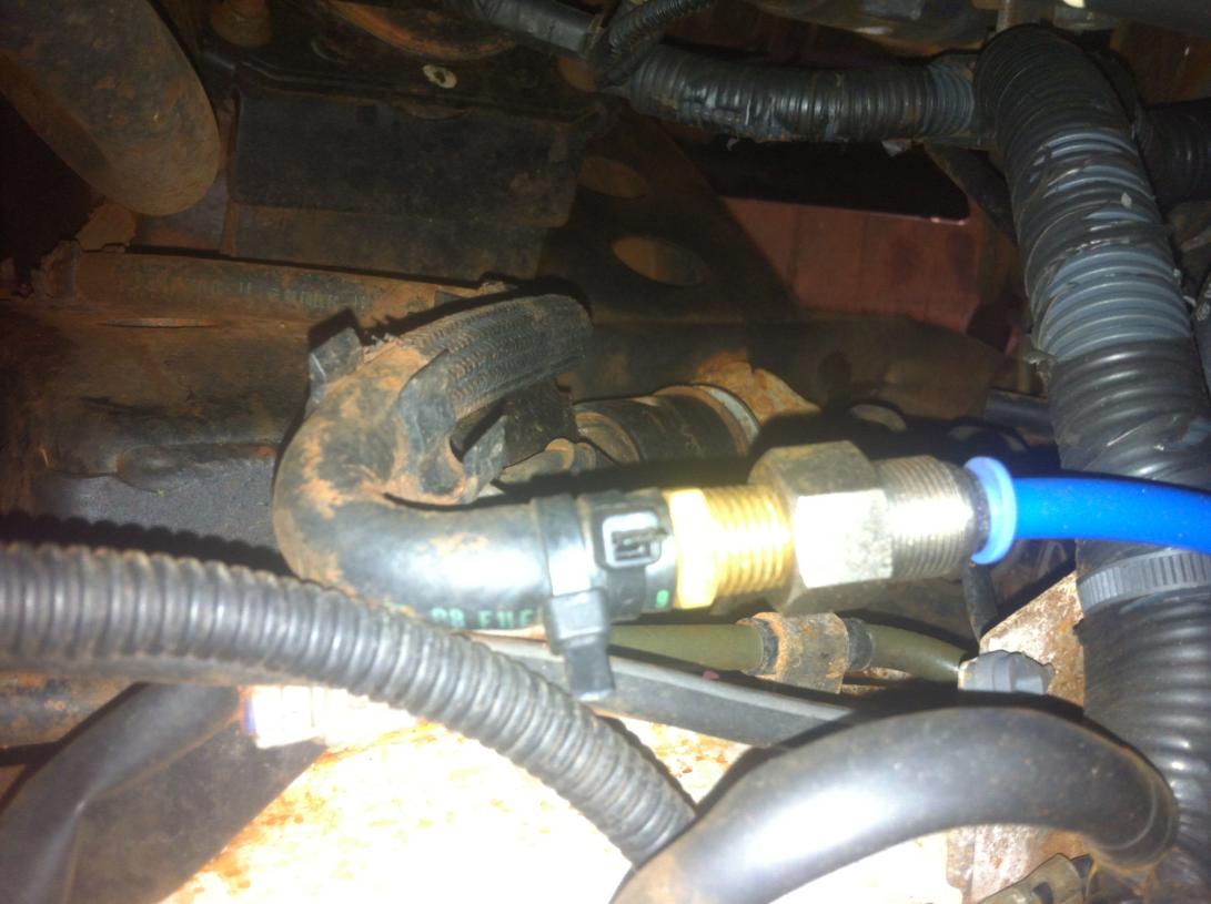

          • Hi Smithy,
            Mate like mjrandom has said, its easier to join into the original front diff breather pipe and extend to the desired location. Ill be back under my rig tomorrow so will take a few pics for ya.

              • Front breather join. Prety straight forward, I removed the old breather,inserted a brass barb and then screwed in the new joiner and hose. Same deal with the rear diff but its a straight screw in barb to hose setup, cable tie hose off underneath the rails until you get it to the desired location in the engine bay.
                Front join.
Name:	Front Breather.jpg
                Rear diff.
Name:	Rear Breather.jpg

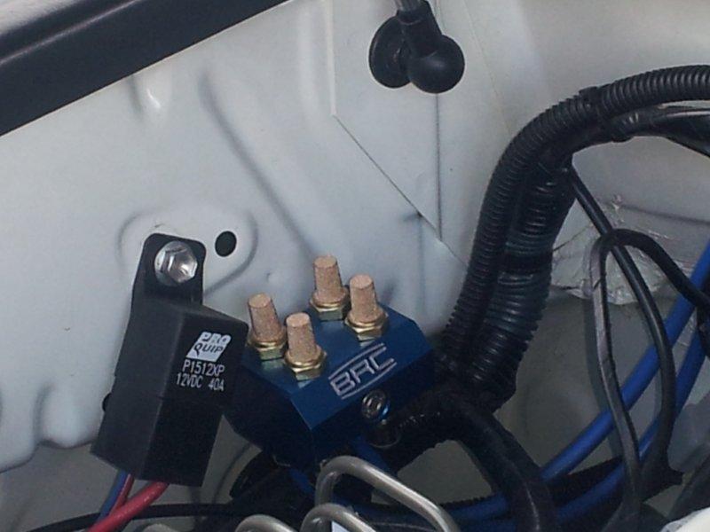

                Filters in engine bay as high as i can get them on the firewall.
Name:	Breather filters.jpg

                • Well, after some words of advice per above, I finally managed to get the Diff Breathers done. A big thankyou to mjrandom and Dueller120 for your assistance!
                  I don't know why I though it was so difficult. The rear diff took a bit of messing around, but was pretty simple really.
                  Interestingly when I pulled the OEM breather off the rear, it sucked a lot of air in, due to the one-way valve.
                  I'll leave the Transfer Case and Gear Box for later, as these are definately going to take some time...

                      Will let you know how I progress with mine when I can get back from work! I like how neat that filter bracket looks.

                        I like the BRC mounting block too. The kit probably cost more than a personalised job, but it has everything I needed, including cable ties, so was easier than sourcing parts. The rear diff attachment screwed straight in, so hopefully the transfer case and gear box will too...
