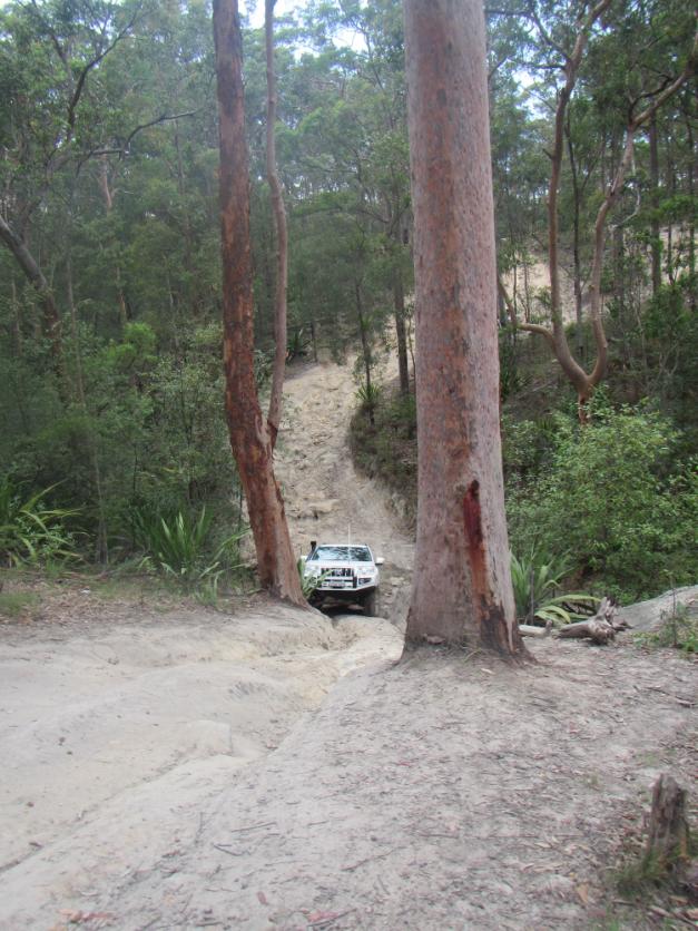

    Big Whitey Today (about a month ago on the Killingworth Loop out of Newie...)
    Yes, I do use it as a 4WD (just not as much as I would like to)

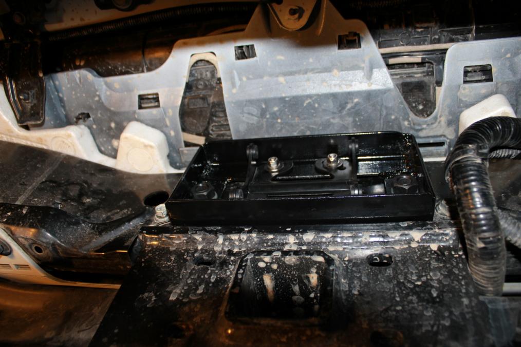

      Compressor install behind rear fuel tank
      I purchased an ARB CKMA12 compressor, just needed somewhere to put it. Engine bay was out due to catch can, second battery and pre-filter. I was going to mount it behind the plastic trim on the LHS below the cup holder, but when pulling the trim off the mounting points didn't look strong enough, so I went looking for other ideas.

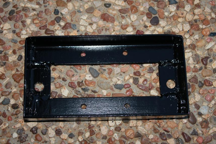

      Bracket (I don't weld, I join steel, theres a BIG difference...)

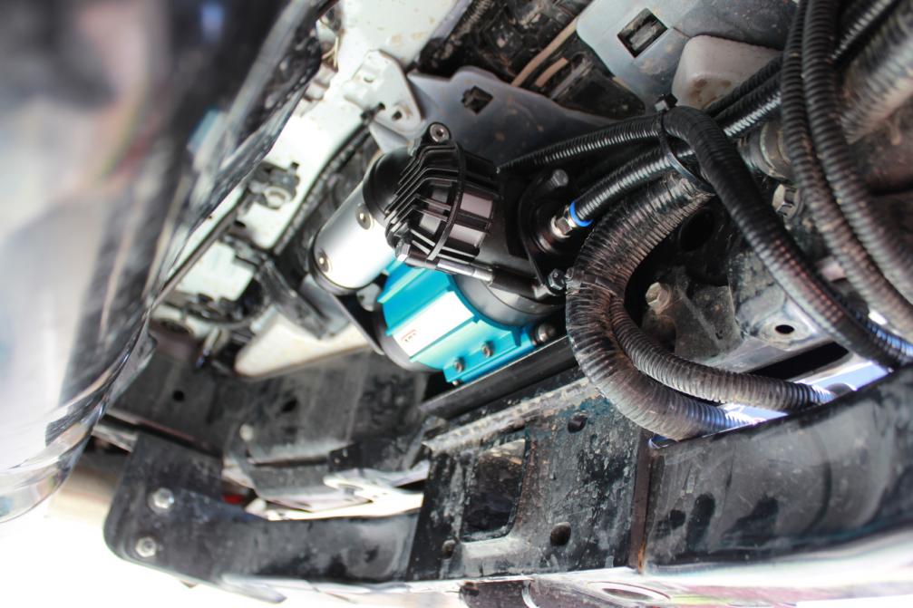

      Compressor mounted to chassis above tow bar with wiring and air lines

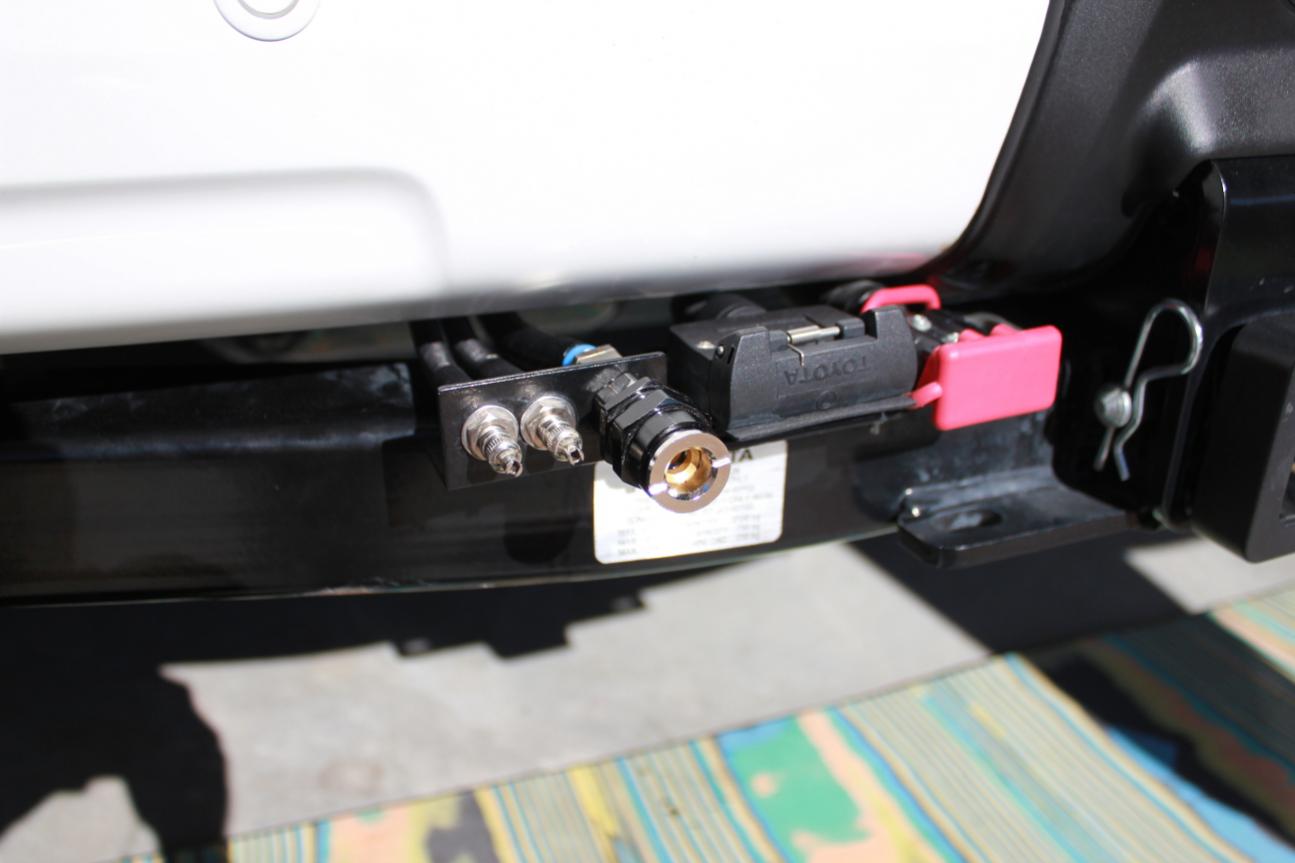

      Air hose attachment, air bag fill points, anderson plug all on an angle bracket off the tow bar
      I know I need a smaller "quick connect" for the air hose, but I spent enough on this project so I just used the ARB supplied one. A job for another day.

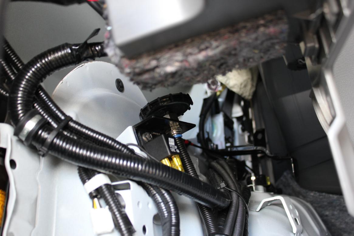

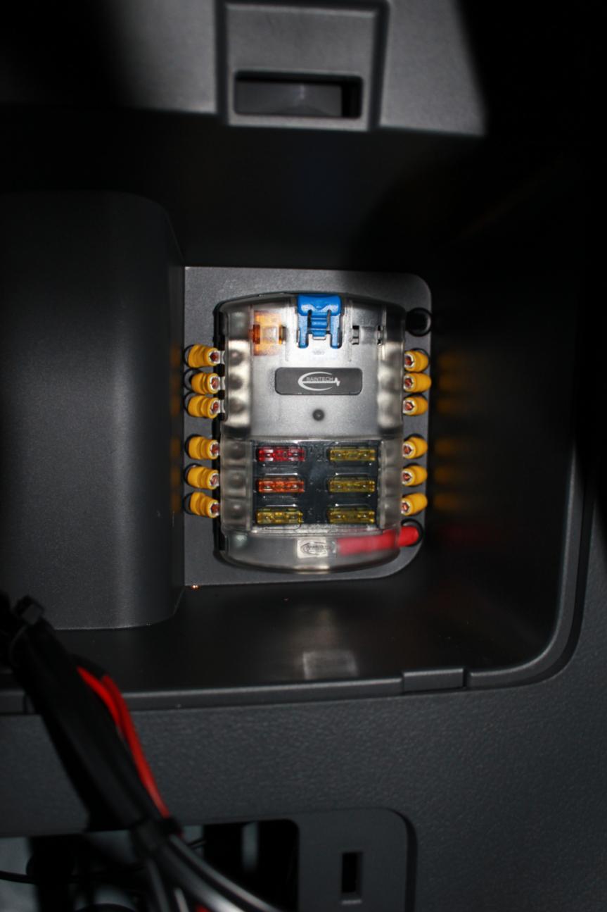

        Rear fuse box, has 6BS twin run from Aux battery, fused in engine bay and terminated here.

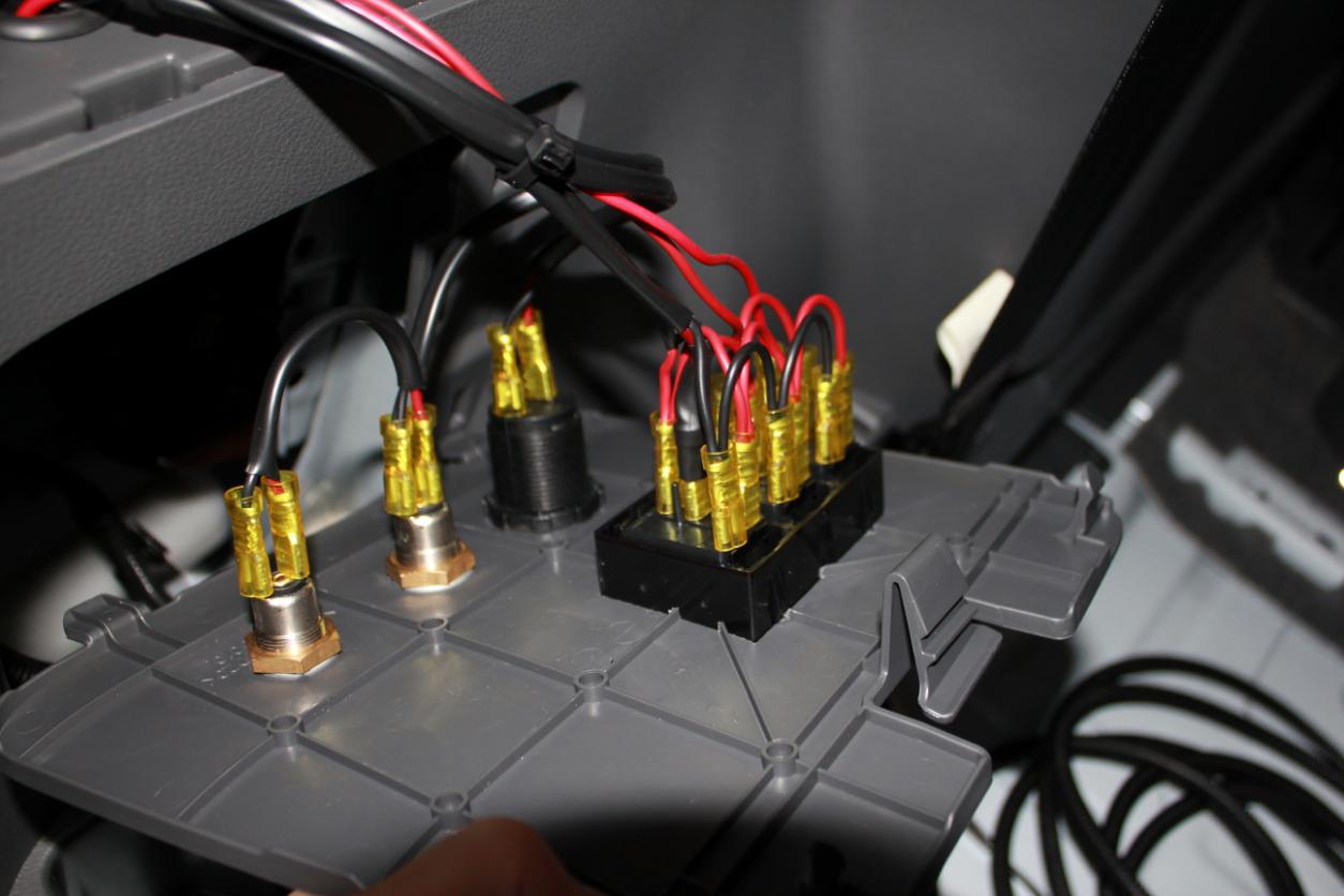

        Back of switch panel

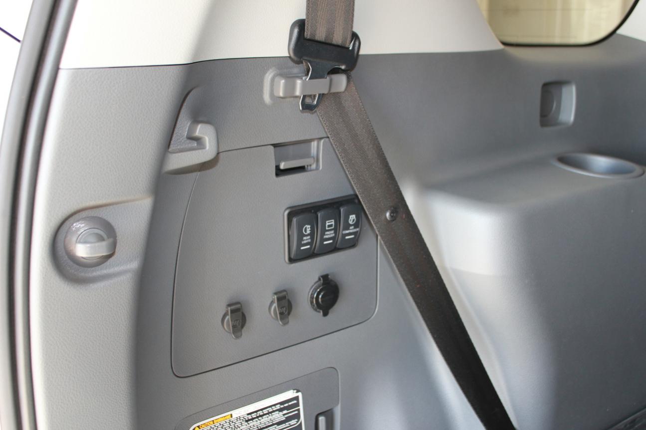

        Switches and sockets, the switch internal lights are hooked up to the "Rear Light" switch (for when AMTS finishes his light bracket for the spacer) and light up when that is on, they also have a red indicator that comes on when in use. Fridge cord is hard wired to fuse panel and switched via a relay off the "fridge" switch. Pretty happy with how the switches turned out.
        I purchased all my switches from www.otrattw.com (not through the GB), can't recommend these guys enough.

              Very nice. Neat install. From memory you will need 20mm hose or thereabouts for the suction to the compressor. When I had the twin head compressor in the winch space I used some reinforced hose and a unifilter off a 150cc motorbike. 2 x 1/4" BSP (close enough to NPT for this black duck) to 1/2" hose tail and then 1/2" hose to a 3/4" tee with corresponding hose tails on two sides and a 3/4" hosetail on the other and then 3/4" to the airfilter.
              What you should do is run the compressor without the 2m of hose but with the filter on and time how long it takes to pump a couple of tyres up. Let the ocmpressor cool and then do the same test with the extended breather. If it takes longer (lots longer) then it is likely you are starving the compressor of air and should increase the inlet size. If you were local we could do a deal on the bits I don't need anymore but I don't have 2m of hose.

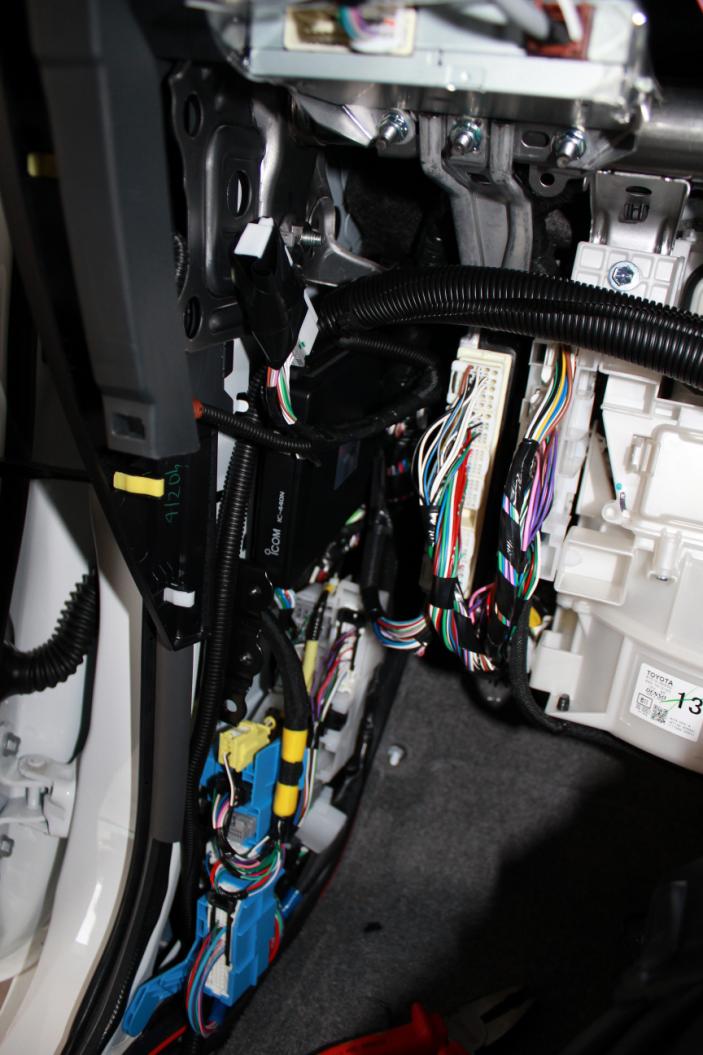

                Power is run from the rear fuse panel (you can't really see it but there is 4mm twin in conduit stuffed under the carpet. On a side note, Yes you can fit 2 x 6BS TWIN cables in the cable tray but it requires removal of the center pillar plastics during installation and some support lugs cut off the bottom of the scuff plates (but it has power cable to support it now ). It's stretching the phrase "yes it fits" to the limits, but that's what life is about isn't it?

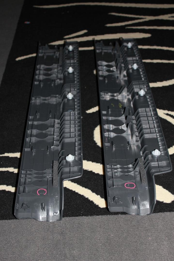

                Modifications to Scuff plate, the one on the right is the un-modified one, spot the difference? I purchased replacement front and rear scuff plates for the LHS as they have a tendency to break the plastic clips on the end and don't clip down properly, probably due to the amount of cable I have stuffed in there. When I have finished my mods I will put the new one's on and leave them there.

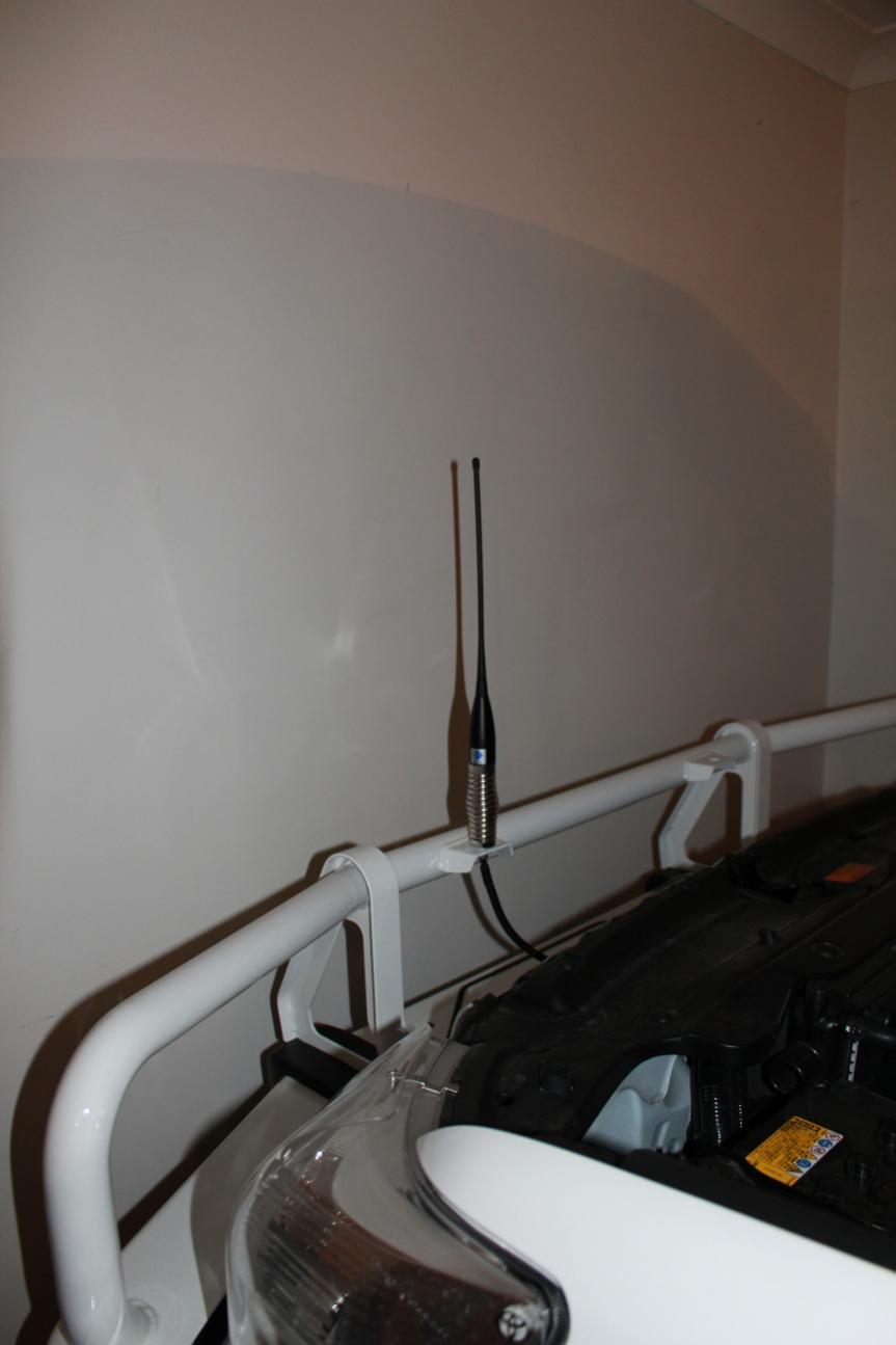

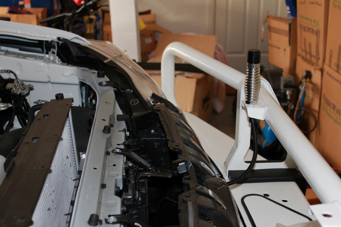

                Antenna cable run through the grill and tied up along the front underneath the bit with rubber lugs in it. This is all covered by the big black plastic trim piece.

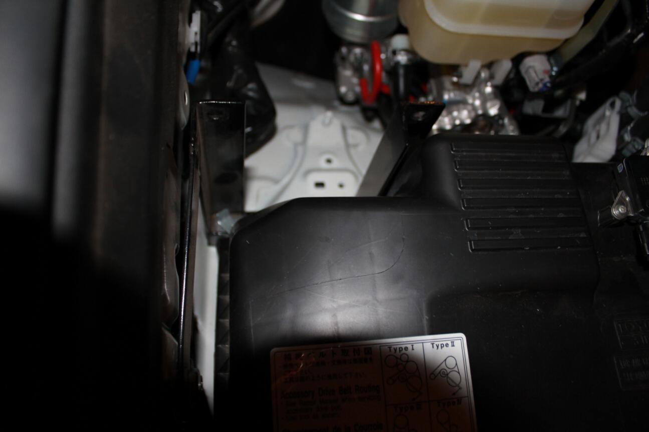

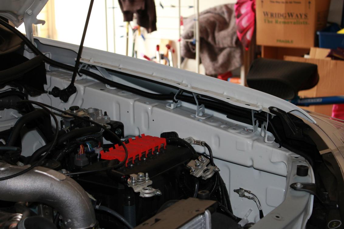

                The "Red" things are my under bonnet fuses, I will post some more pictures of these when I take some photo's of the battery install.

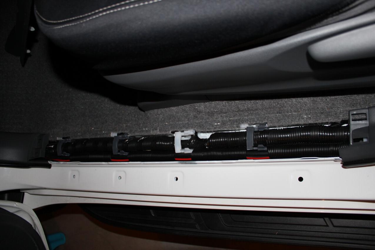

                      I'm amazed, I struggled with one!
                      Love to see that fuse block in detail, can you post a supplier/part? I want to tidy up my feeds off the battery. I bought the Protector fused terminal but the factory cables are too tight and would need some modifying so I have parked it at the moment. So I have the 6B&S to the DC DC charger, twin 6mm2 cables to the ARB compressor, Spot lights, voltmeter feed and something else 'hidden' around the battery box. Not to mention the manual cct breaker for the DC DC feed.

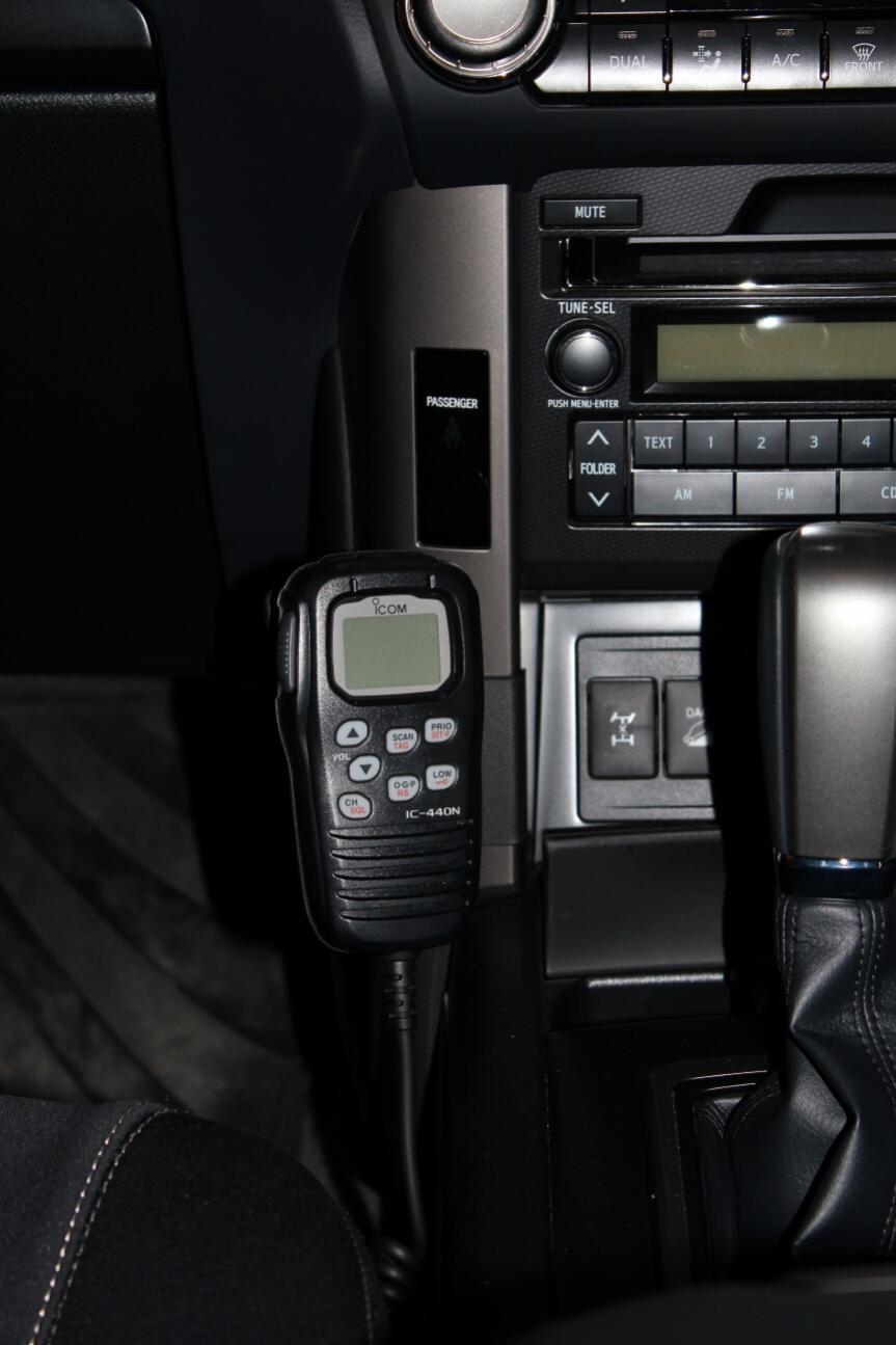

                          Icom 440N Hand-piece

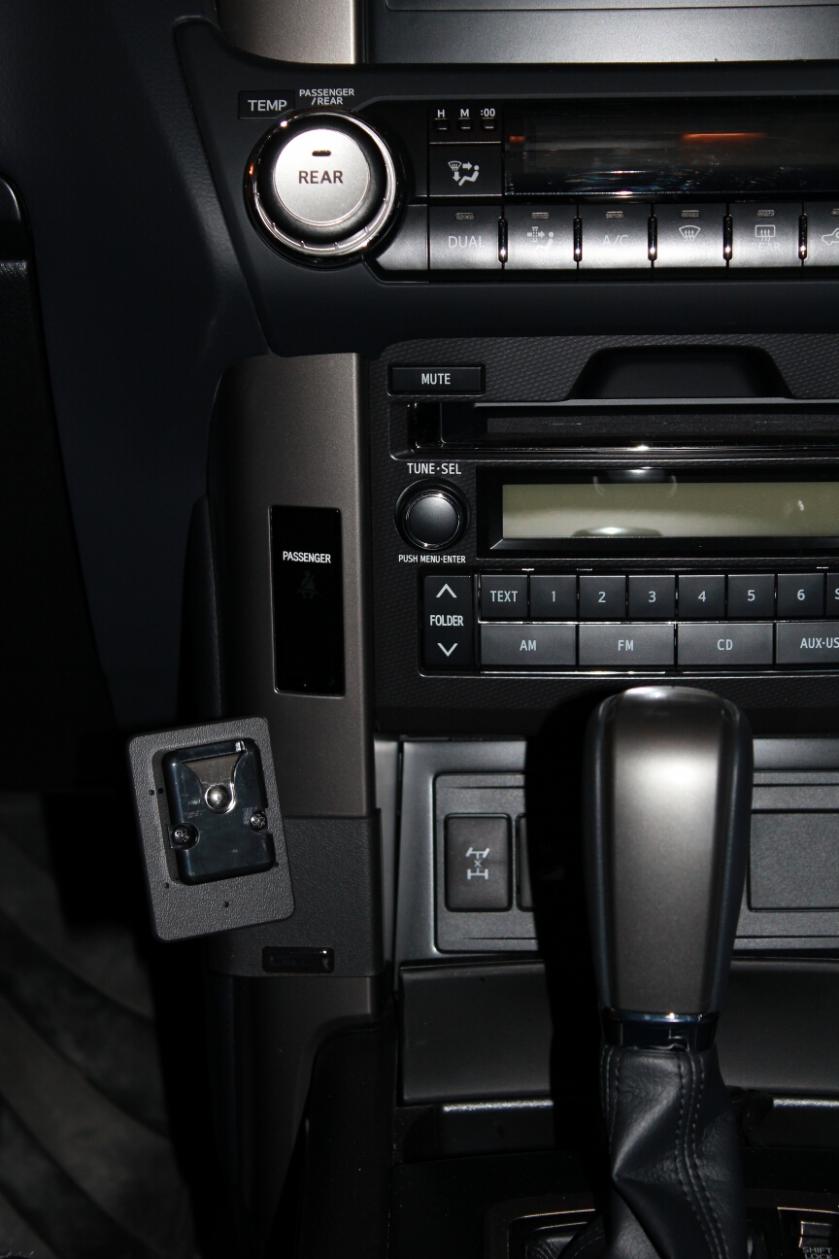

                          Click-On Mounting Bracket with hand-piece clip. Mount is available at http://www.holdmyphone.com.au/Prado-...html?addcart=1, definitely not worth the price they charge but it keeps the install neat with no extra holes drilled.

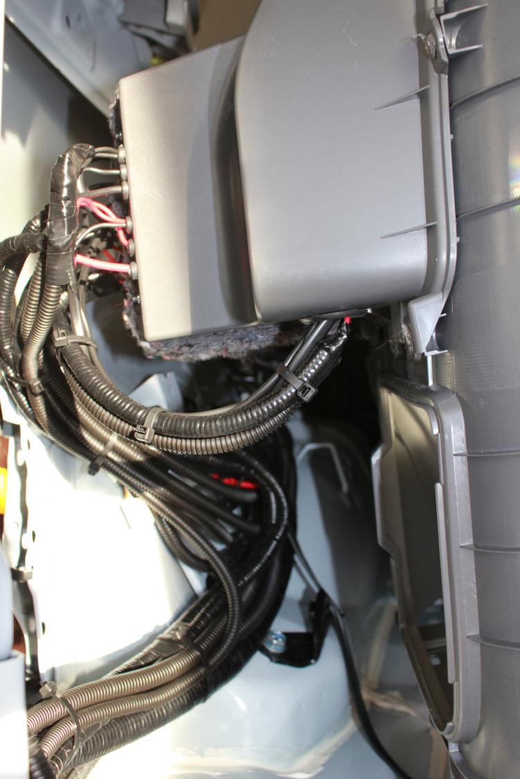

                          I don't have any pictures, but the hand-piece extension cable runs from the main unit, under the scuff plate (as I said, it's mighty crowded in there) and is stuck under the passanger seat rail with double sided tape. The flexi-cable sits nicely out of the way along the console but due to the location of the plug, you don't have to stretch it too far when using the mic.

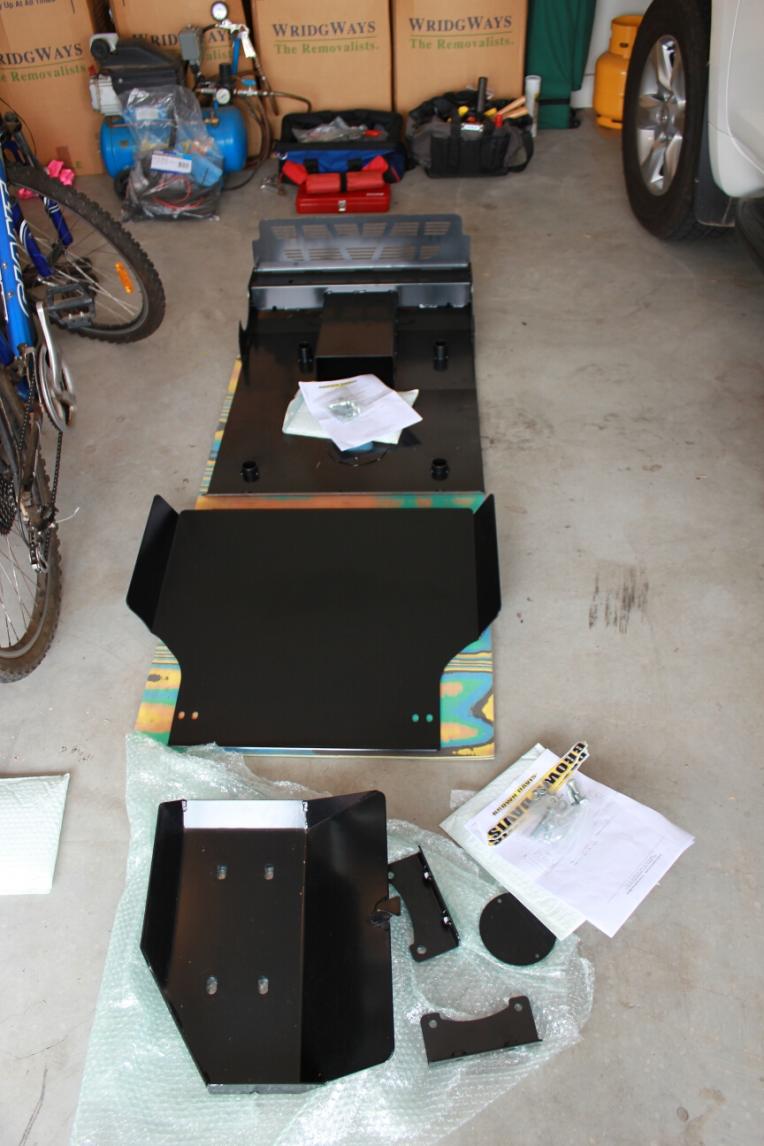

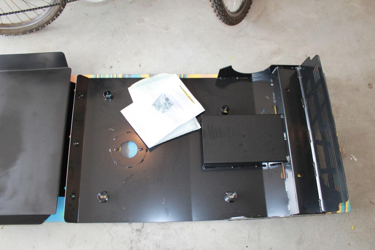

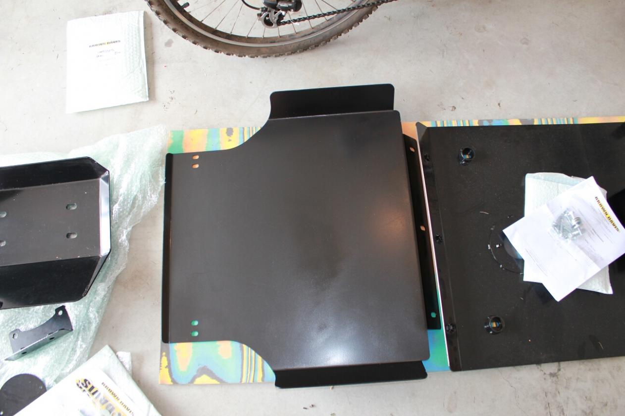

                            Brown Davis Bash Plates
                            After looking at all the bash plate options (and getting sick of waiting for AMTS, sorry Andrew), I decided these plates offered the best protection of all vital components. After an extensive search around Newcastle (I called one shop), I came to the conclusion they were not available locally so order through a dealer in Melbourne and couriered up. While the set is nothing more than expensive bent and welded 3mm steel plate (about $1K for the 3), I consider it cheap insurance so didn't hesitate handing over the coin for a quality product.
                            Full Set

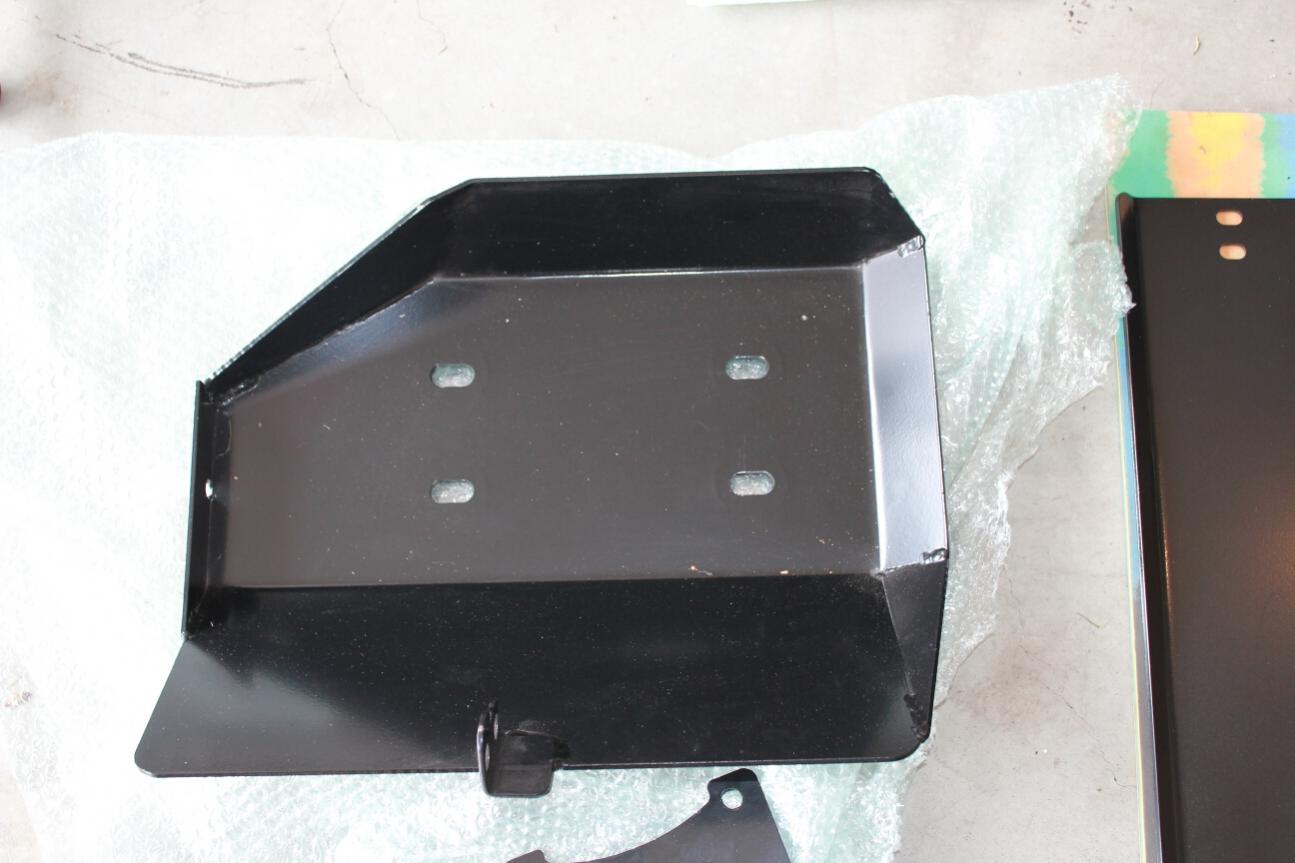

                            Transfer Case Plate
                            Transmission Plate, received a few battle scars to the top of the powder coat from shipping so I touched up with a spray can before install to prevent mud sitting on top of the plate encouraging rust
                            Front Engine Plate, notice how it comes up at the front, this matches up to the radiator for extra protection
                            These plates are a credit to the quality of Brown Davis' work, apart from a minor logistical issue (they sent two identical brackets for the transfer case plate when one needs slightly wider holes, nothing a phone call and express post package couldn't fix) they fitted up perfectly with all holes drilled in the correct places for the vehicle and HT nuts, bolts and washers supplied. The plates even match up to the piss weak centre skid plate that comes from the ARB bar, although ARB bent my front plate to fit it back to the OEM bash plate, it now as a concave curve in it since the BD ones are on. I will get a stronger plate made up with the correct bend one day to replace the ARB one, but probably wont bother until it is damaged beyond repair as it's more for looks and doesn't protect anything now the BD plates are installed.
