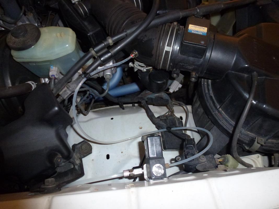

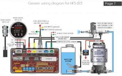

            Some pictures of the Aquamist install. This system uses Pulse Width Modulation to activate a fast acting valve. There is an output on the Xede supercharger ECU that can drive it or you can simply wire it across an injector + and -. Haven't decided which I'll do yet.
            5L tank with low level float and 160psi constant pressure pump installed in rear side compartment (next to drawers).
            Wiring of the HFS2 control module above glove box.
            Installation of the Fast Acting Valve into engine bay. Yet to plumb in it and the injector into intake.

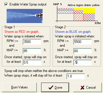

              Looking good. If it can wire up to the xede I wonder if you can then control it's spray quantity/timing vs rpm/load. Connecting up a laptop and adjusting is fun stuff!
                The Xede water spray output is mappable by setting 2 stages of RPM vs MAP. The Aquamist works by creating a set point (pot) to turn on the flow when the set point is reached. It is based on % duty cycle of the injectors. By combining the 2 triggers you can see it is infinitely tunable

                        Water methanol system install completed. I decided to go with the standard Aquamist activation method, which has a settable trigger point on injector duty cycle percentage. I've set this to around 30% IDC. Thus the jet activates before mid loads and around 2000rpm, just in time to stop that notorious ping. Of course light loads and the system is dormant. I've yet to put this back on the dyno but I expect some interesting results, judging by the right foot

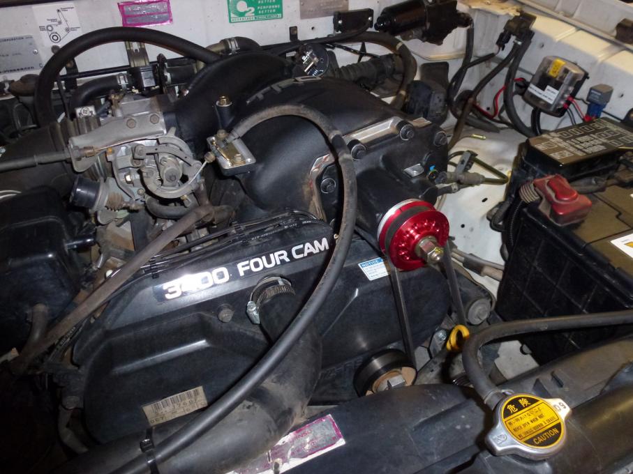

                        I also installed the smaller supercharger pulley, 2.2 inch as opposed to the original 2.37 inch and......................whoahhhhh nelly !! I can definitely feel an improvement in power and torque. The improvements I've made has changed the whole nature of this vehicle. It is in diesel V8 territory now as far as towing power and is fantastically drivable.
                        I also installed an extra fuse box you can see on the first image. This to tidy up the wiring of my driving and hunting spots, plus also fed the water methanol injection pump. Where did the charcoal canister go I hear you say ? What charcoal canister ?

                          Looking good mate! Will you be keeping the resonator box on the air intake?
                          • #28
                            Probably Glen, unless I stumble across an easy alternative to blanking the holes. No use going to the aftermarket intakes as they are a waste of time and no gain over the standard set up. I'm about done with the old girl now, and hopefully have another project in the making.............*cough* Bavarian Motor Works M635csi :drool:

                              Appropriatly sized freeze or welch plugs will do the job of plugging the hole in the rubber hose nicely. Use the flat side inwards and a hose clamp to hold them in place on the lip.

                                The tube is an unusual size but a perfect fitting $5 replacement is waiting for you at a wreckers somewhere... it'll just need some trimming! Look for a Cressida MX83R with 7M-GE engine.
