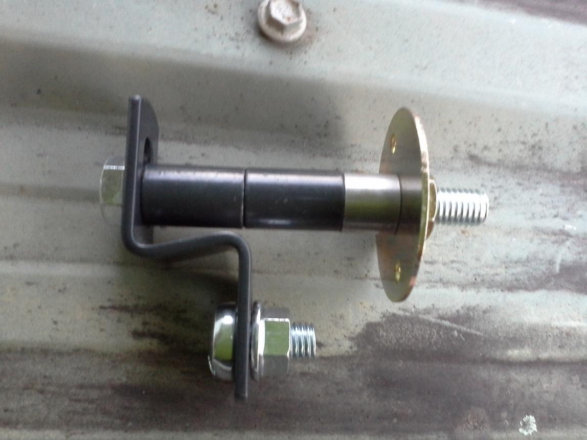

I picked up the Autosafe Cargo barrier that was on ebay this week. Great seller, with a really nicely tricked out Prado 150 himself, who had to get a custom 1/2 barrier made up to suit his new draws hence he was selling the full size barrier he had installed previously.
Barrier came with everything inc. the fit kit and instructions however i could tell straight away that this 'kit' wasnt going to be a simple bolt on job. Well half of it at least.
The top mounting brackets were an easy 5 minute job however the bottom mounts, well they simply do not and will not work at all. Autosafe supplies a couple of "Z" brackets to mount off the tabs welded on the bottom of the cargo barrier and they are then said to be fixed to the car via the wheel arches. This is all well and good except the plastic trim that is inside the car contains a large void area and the metal wheel arches themselves are a good 6-8 inches away from the interior plastic trims.
To make it a little worse, on the drivers side where the rear air con duct is, (not sure if it is an inlet or outlet - but i mean that little vent down at foot level towards the front of the drivers side interior wheel arch panel) well that is exactly where the drivers side "Z" bracket would bolt through if i tried to fit is using the supplied brackets.
So best i can tell, even if i made up some longer brackets myself, all i could attach the brackets to, would be the plastic trim (and use large 'mudguard washers' to spread some of the load). Far Far Far from ideal.
I tried calling Autosafe today but after i explained the problems with the proposed fitting method as per their kit and instructions i was told their installer isnt in today so i will have to call back tomorrow.
Id love to hear from anyone who's fitted a barrier to their 150 Prado - regardless of brand, how do the lower brackets attach to the car? Ive read all the threads here on prado point and seen all the pictures but i cannot clearly tell how and what the bolts are attached to on the side interior trim panels. Surely they are not just bolting to the plastic trim with a big washer??? Is an internal bracket made up to 'bridge' between the metal body of the vehicle and the trim to take the load etc.....??
Any help would be greatly appreciated. I will update this thread when i hear from the installer at Autosafe tomorrow hopefully. Im a little dubious about what is done, the bloke today confirmed i have the right kit and nothing has changed. But the fact remains that their instructions are wrong, and cannot / will not work as written.

Not a 150 I know, but my Autosafe barrier in my 120 has brackets that attached to the rear tie down points. The top uses a bracket attached to where the grab handle is. The beauty of this system is no drilling. And it doesn't move at all.
Maybe the 150 had to be different due to the rear seats folding down into the floor.NOW FOR SALE!!! - 2004 Silver GXL 3lt 4spd Auto - ARB Bullbar, Safari Snorkel, Redarc Dual Battery System, Cooper ST MAXX, Dark Tint, IPF900XS spots, Raised Bilstein/Kings Suspension/Firestone Airbags, Autosafe Cargo Barrier, Sandgrabbers, Rola Roof Rack Stuff, Insect Screen, Dust/Wind Deflectors, Sheepskin/Black Duck Seatcovers, GME TX3510, ARB underbonnet compressor, Allied Hammer Rims, ARB UVP, [url="http://www.pradopoint.com/showthread.php?18043-Rock-sliders-steel-side-steps"]AJ Sliders[/url]
Hi Madkore, thanks for the thought - yeh i saw how the 120's were mounted and honestly i think id prefer that to the 150's but i havent seen any manufacturer use the floor for the bottom brackets on the cargo barriers they all seem to use the side rear wheel arch area.
I called Autosafe again today and spoke to their installer. I mentioned my thoughts and he said that i needed to drill through the lower air vent and "if i drill in the right spot the Z brackets will work and they will be mounted through the metal wheel arch not just plastic".
I mentioned the mounting bolts for the Z brackets were only 30mm long, and again he said if i do it in the right spot thats all i'll need. I cannot for the life of me picture any position that the Z bracket could be put in (they are only very short brackets - couple inches long), to make them work and get close enough to the actual wheel arch behind the plastic trims in the vehicle... And im not to fond of the idea that i need to drill a hole through the vent..
Ill hopefully get this sorted over the weekend when Michelle isnt using her car.
