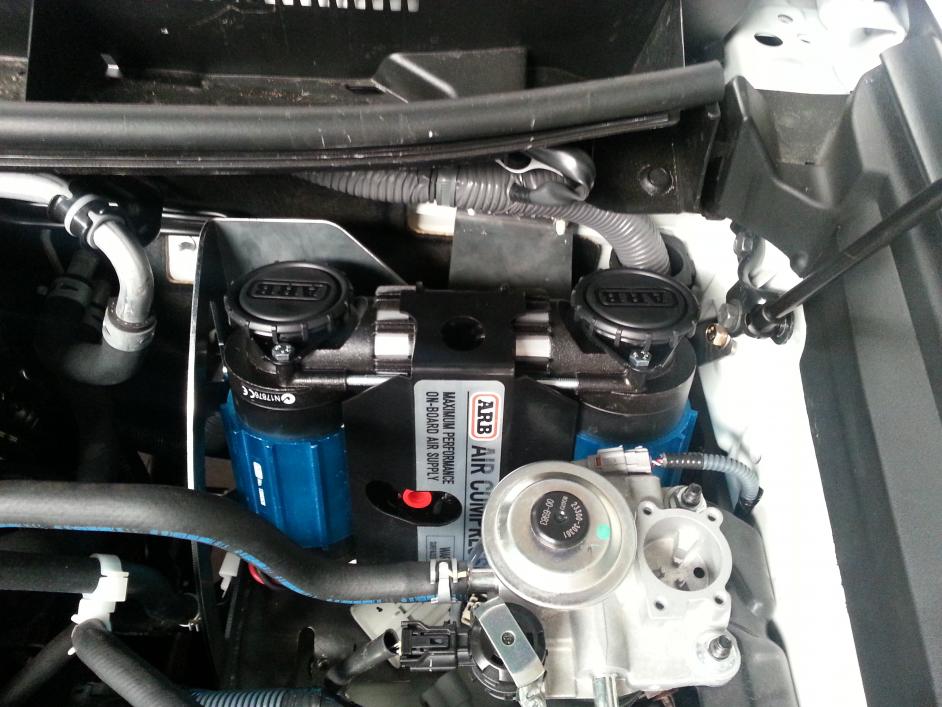

              Made up the compressor mount this weekend. I'll adjust the cad model to make it all in one part so the next one will be a bit prettier. Snug fit for the big compressor...
                  [ATTACH=CONFIG]13535[/ATTACH]
                  Wow I would never have thought the twin head beastie would fit up there. Nice work. Are you switching it locally or back in the cab?
                    Unfortunately I have to wait until the 20th to get the arb bits fitted. That will be the most noticeable changes. 4wd and camping show in the meantime...
                    Switching the compressor from the cab. Don't really trust switches under the bonnet to not get full of crap. Air on board has switches coming soon for the 150 prado so they look like oem switches. They have heaps of switches for the 120, but they are slightly different. As nice as the carling type switches are, I'd like to keep it looking all neat and tidy. Conveniently there are 3 spare slots in the center console, so compressor and 2 lockers if/when they eventually get fitted.

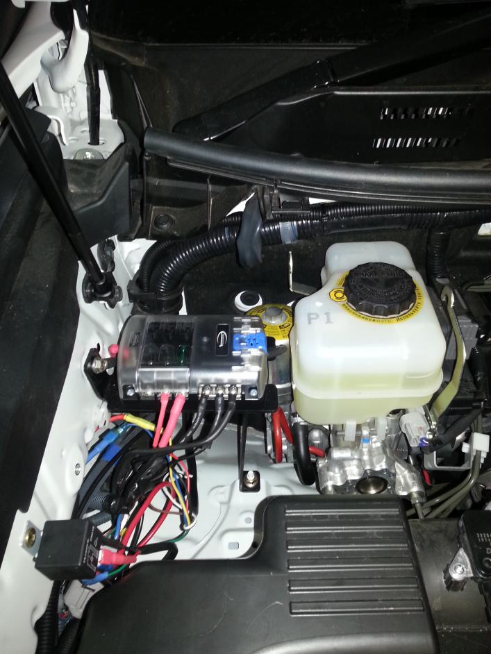

                    Also fitted a bracket for a 6-way distribution block on the driver side of the engine bay. I'll chuck up some photos of that later too.

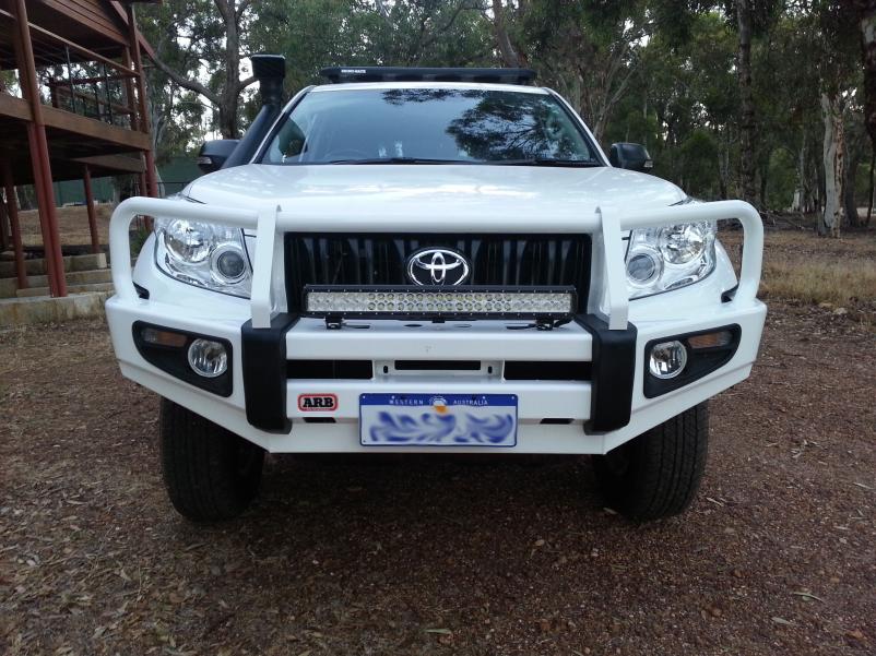

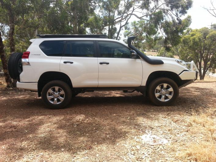

                        Picked up the car this weekend after ARB has done their part. Looking much better, but something really needs to be done about those rims/tires... like Dick Cepek Gunmetal 7 rims with 275/70/17 Mickey T STZ's. So, front and rear bars fitted. Snorkel installed. Sitting up a bit with OME suspension (no more waterbed suspension). And very happy with the pioneer platform.

                        Spent the day hooking up the front led bar and fog lights today. Waiting for an ebay shop to get their new switches for the 150 prado before I do anything permanent in the cab.
Name:	2013-11-24 18.57.00.jpg
Name:	2013-11-24 19.01.15.jpg
                        Still need to wire in the UHF and the rear light on the kaymar bar. Surprising how long all the wiring takes when you're trying to make it all neat.
