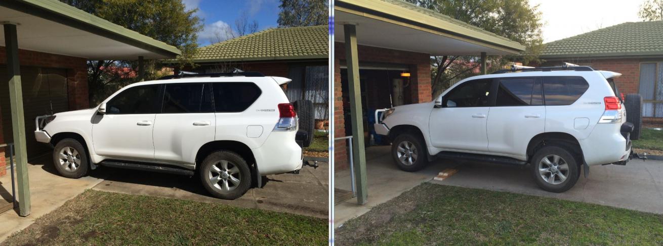

  • A sneaky before and after shot...
Name:	Before and After.jpg

    • So much better with the lift! Looks great.
      Had mine done 2 weeks ago and now all the standard Prado's just look silly to me. Super low and quite boring.
      Horses for courses I guess...
      • Originally posted by lordsword View Post
        They definitely look more aggressive with the lift...the rear tyres do look tiny now

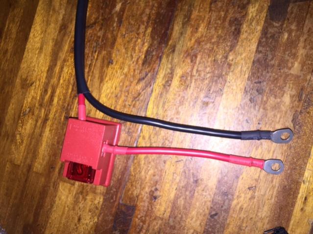

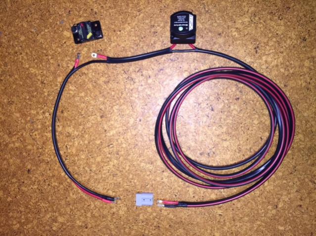

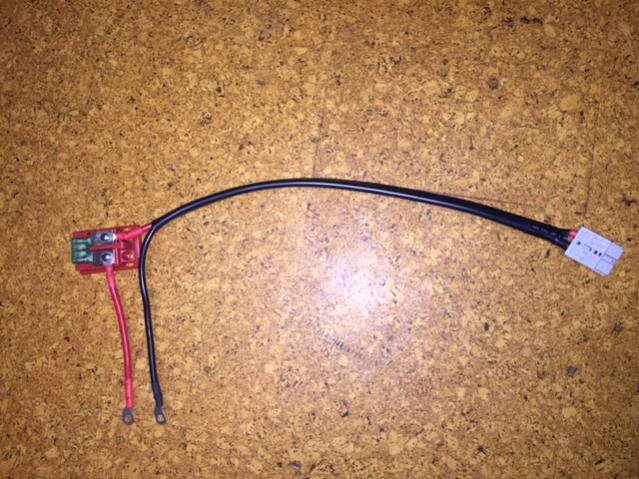

          • I received a couple of "sneak peak" photos of my dual battery gear last night:
Name:	Dual Battery 1.jpg
Name:	Dual Battery 2.jpg
            Spilsy
