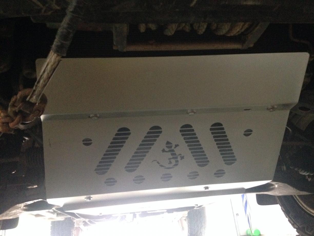

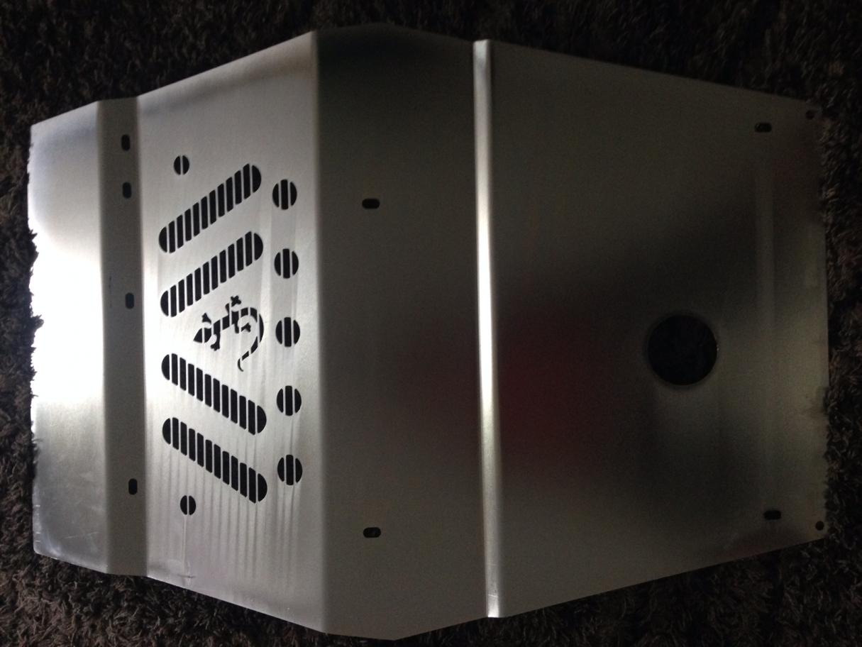

            Thought I better update my build page a bit.
            Fitted some Bushskinz bash plates. The OE Foil was a bit busted up.
            Very happy with the choice to with bushskinz. They are a bit on the heavy side but thats what you get with 4mm steel. Most of the others are only 3mm.
            I would buy them again if I needed to
