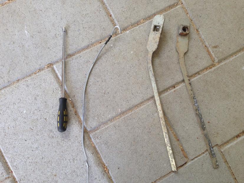

    Also when I was doing the top bolt on the recover point the nut fell forward into the chassis and is sitting in there and it's got a rod attached to it. I couldn't get them out so they are going to rattle around like crazy. So I'm going to have to take the bullbar off I think to get them out.
    Can you use a big magnet to tease the end of the rod back up to a point you can reach it? Have a look in the recovery point threads (there's a couple) to see how others have done it.
      Hey fido
      Well thing was I got hold of it. I just couldn't get it out the hole because the rod connected to the nut isn't just thin so u can bend it easy. It's a about 10mm wide and 5mm thick. So they must have poked it through the front of the chassis. I will have a crack at it again tomorrow.
      I will also try find out how others got theirs out though to see if I can make life a bit easier.
        This might help :- http://www.pradopoint.com/showthread...l=1#post418894
          Thanks heaps Fido. Sounds like it's not too hard to get it out. Will give it ago tomorrow. Let you know how I go :-)
            Well thanks to You fido I persisted a little bit and got both the nuts out. Only took like 10mins I think. Pulled the rod end out first then was able to bend it around and get the but end out. I had an extendable rod with a magnet on the end ( came with my king chrome tool box). Never had a use for it till now. Then once I move it up so I could see it I then hooked it and pulled it out the hole on the side of the chassis right where the tyre is.

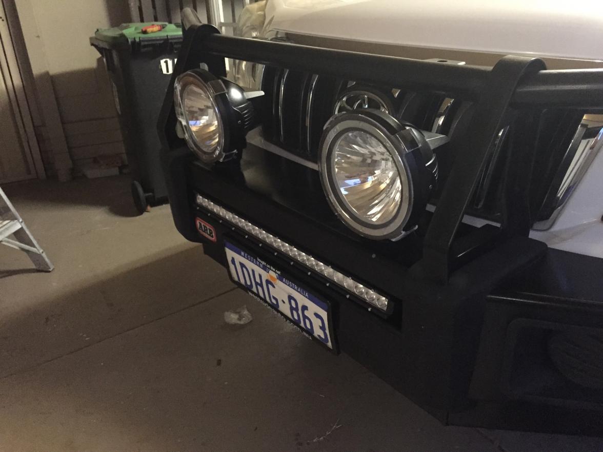

                  Havent done anything since last post but i have ordered my self a set of HID spot lights and a 26" light bar. The spotties will be going in the normal spot but the light bar im planning to put in the bullbar.
                  On the commercial arb bars (Non winch) They have a big long slot just under where the spot lights go. So im planning to put it there. Probabaly not the most ideal spot but i dont want to be looking at the light bar on top of the bullbar. I got a slim line one which is i think 50mm high so should just fit in. Shoud give it a nice look too i think. Should get getting it this week so then i can fit it on the weekend and then post some pics up.

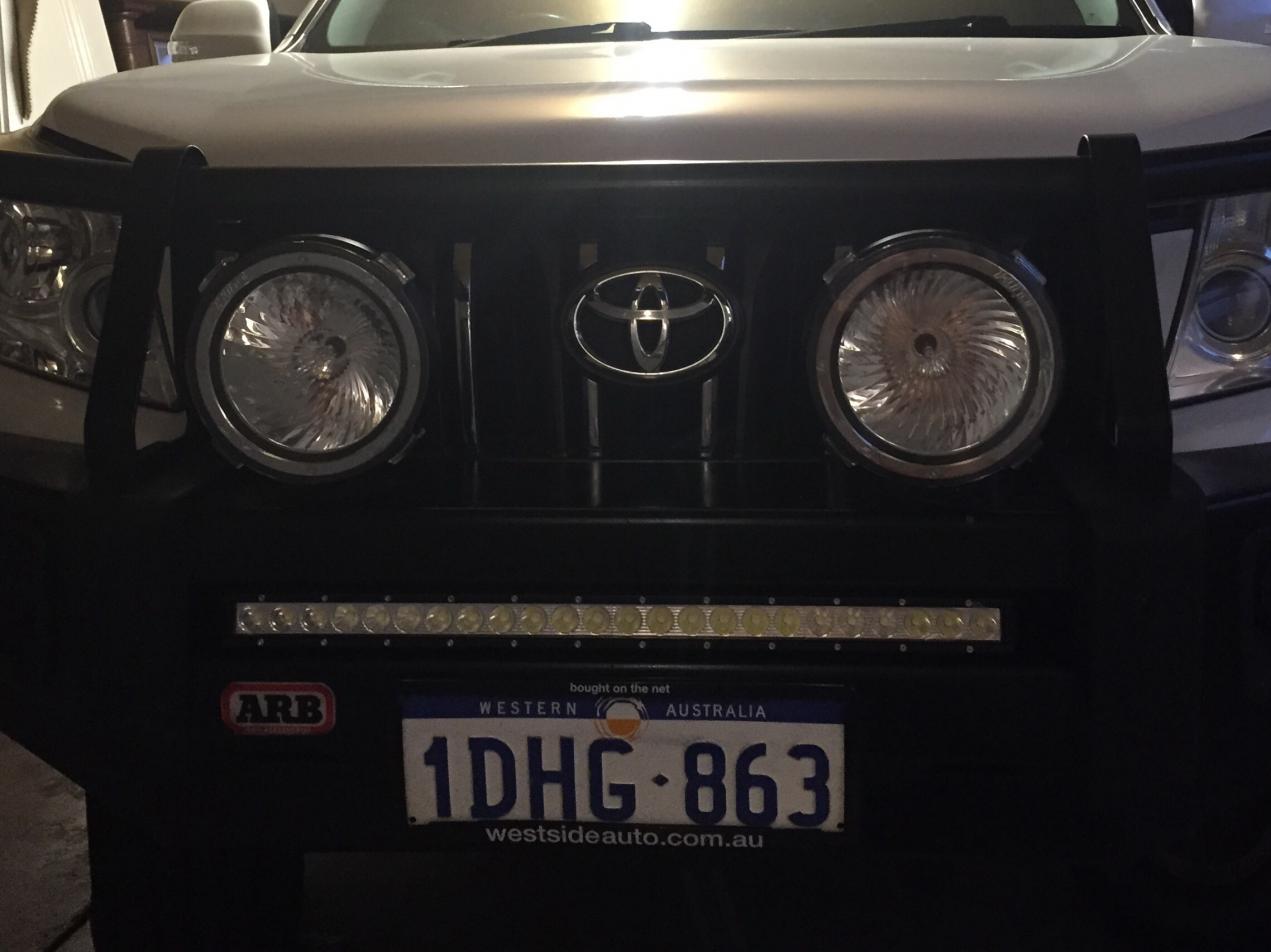

                          Well I got my HID spotties and light bar yesterday. Fitting them on the car already. Just have to wire the spots up the the high beam still. The light bar will just be switched from the dash and not hooked up with the high beam.
                          Fits well, and I like the way it looks and that it doesn't stand out but it obviously does close up that gap so it won't really get any air flow from there. But decided I'm going to get a new bash plate that has some nice vents on it like the ones from Brown Davis to help with air flow to the radiator. If air flow affects the cooling then the light bar will have to go.

                                Mattfunk that's purely for legal reasons hey? I can still easily do so I just got the light bar more so for on tracks at night rather then having the spots on.
                                Either way I have them hooked up now. Can still change the light bar to come on with the high beam. The light bar is good. Throws a heap of light out. Real nice spread on it too. The spotties how ever I am not so happy with.
                                The spotties give off a lot of light. But the mounting/adjustment on them is shocking. They have a teeth system on it which is good so once it's there it can't really jump out of place. But being done teeth you can't get a good adjustment. Mine are either too low or too high. I had to put a packer under the mount to get it to shine in the right spot. And it's not easily adjustable because the one and only bolt the camps the spotties down is what you have to loosen to adjust the angle.
                                I got these online from BAP Off-road. I recommend everyone to stay clear of them because all of their spotties look like they have the same mount. And they do not sure they way it adjusts on any of the pictures.
                                I have tried to get a refund or get them swapped for something else but they won't have a bar of it even though there is a 30 day money back guarantee. So better to stay clear.
