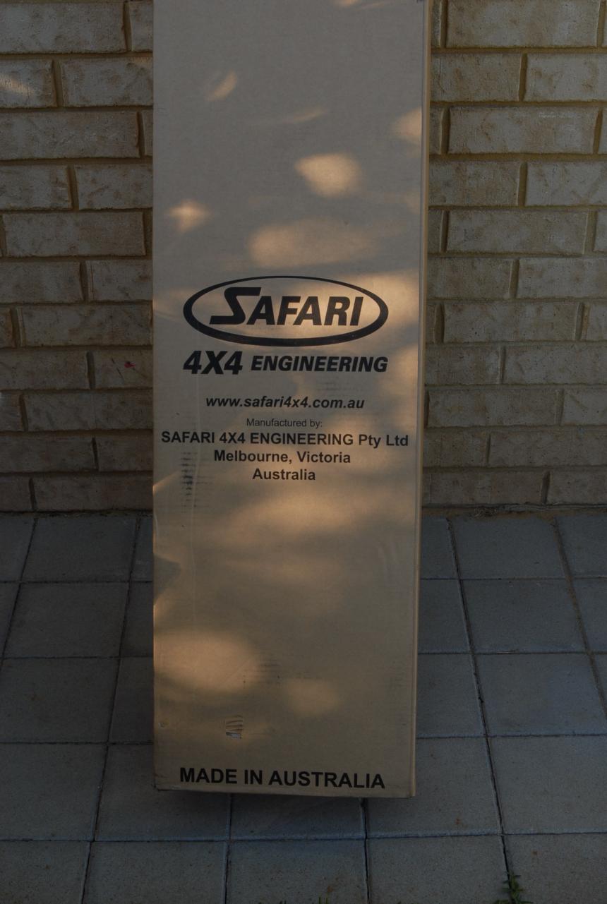

              It's been a while since I've done much to my Prado as I've been busy building an off road trailer. Now that is done it's back to playing with the car.
              Had big box from Safari arrive at work a couple of days ago :-), so that will hopefully go on this weekend.
              Also bought a diff and gearbox breather kit and a GME TX3500s UHF. I've started making a roof console to mount the radio in (pics soon)

                It was a hot one here in Perth today, but I got my snorkel fitted.

                The whole thing took me about four hours, I found the instructions from Safari detailed and easy to follow.
                The biggest drama I had was removing the inner guard lining, after spending about ten minutes trying to get the first two plastic clips out without breaking them, I gave up and cut them off. When I was done a re-attached it by drilling next to where the clips went and using self tappers with a washer under the head.

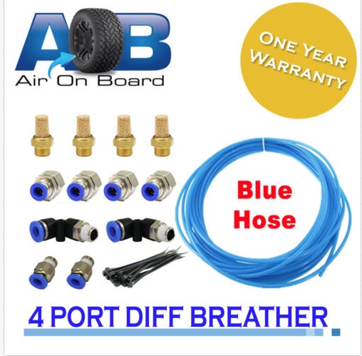

                    Hi Mark, where did you get the breather kits please

                      Hi brogers,
                      I picked up one of these kits of eBay. Click image for larger version
Name:	Screen Shot 2016-02-28 at 7.14.05 AM.jpg
                      Cost me $42, I just need to make a bracket to attach to the firewall.
