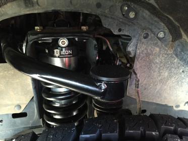

      Just out of the workshop and then about 2 days later . I have some of the rear aswell but they're not ok this phone. I'll get around to a proper update soon.
        Hey mate, any luck with pictures and feed back on the Icon Shock / coil set up??

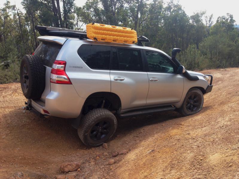

            Just a little flex in the rear showing a little shock...
            So how do the Icons go? Well, in a word, brilliant. All round the rig feels much more planted than the soft wallowing whale of a thing it was from the factory. After coming from a relatively tight little euro, the stock suspension in this felt like wading through soggy Wheatbix.
            On the road, it's compliant and firm but not too firm. It swallows up bumps like they're simply not there, doesn't dive under brakes even with the bar & winch up front, is relatively flat around corners (considering it's height & bulk) even when being somewhat spirited but doesn't give you a bone jarring ride.
            Off road though is where these things really shine and in particular high speed bumps/corrugations. In situations where it use to bounce around like along the beach or across dunes etc, it's now a little like you're wafting across it on a cloud. No porpoising or bouncing wheels into the air, just control. Corrugated roads are a similar story. Sure, you still feel it but what a difference.
            The other point of note is the fade or rather, lack there of. On a recent trip through the Gascoyne/Murchison region, fully loaded we were skirting around GVM. I was shocked (no pun intended) to say the least at how well these performed. Even in mid 30s with all the weight on board and after 50km of corrugations, there was no noticeable fade. Considering I only went with the Stage 1 kit that doesn't have remote reservoirs, I am very impressed.
