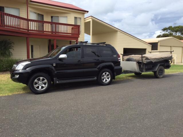

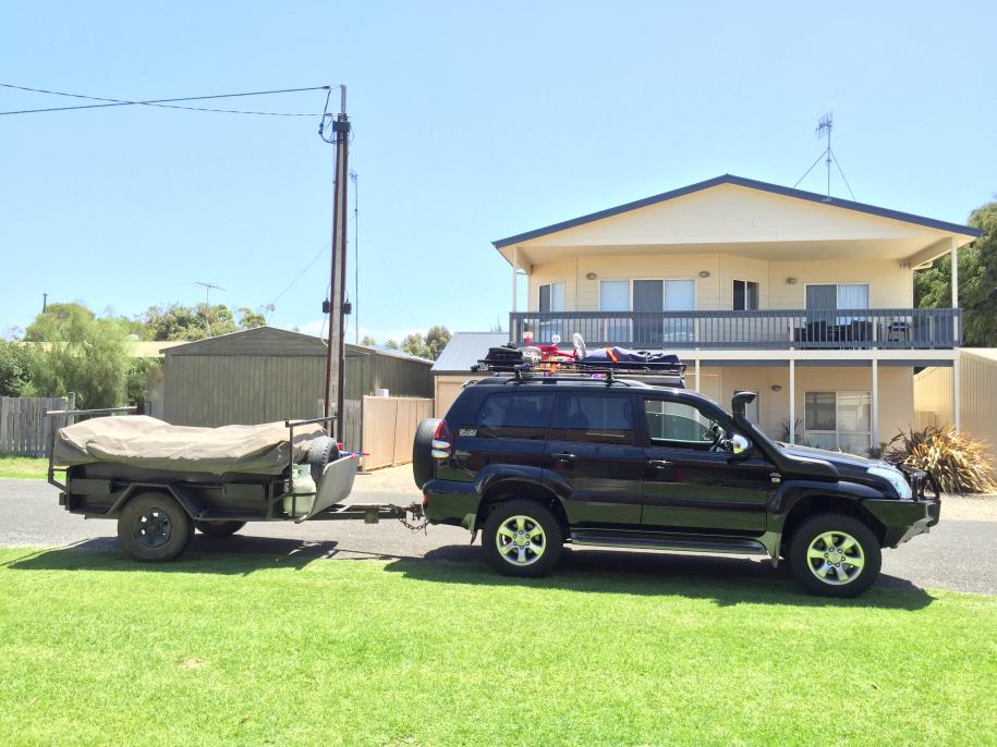

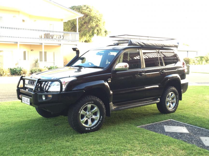

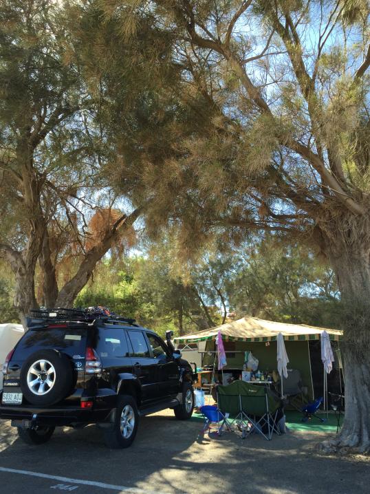

    here is a before and after pic of my new Black D4D with the camper attached with full stock suspension sag.... only mod was roof racks but we picked it up on a friday and next day we were off camping...happy days! and where its at the moment... so far very happy and very capable..!

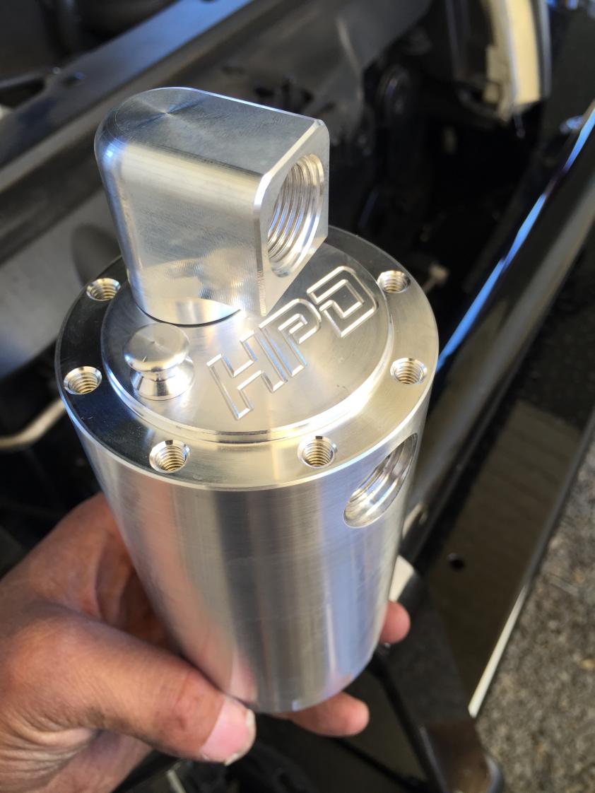

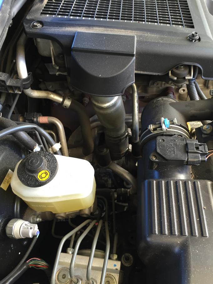

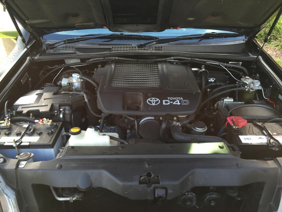

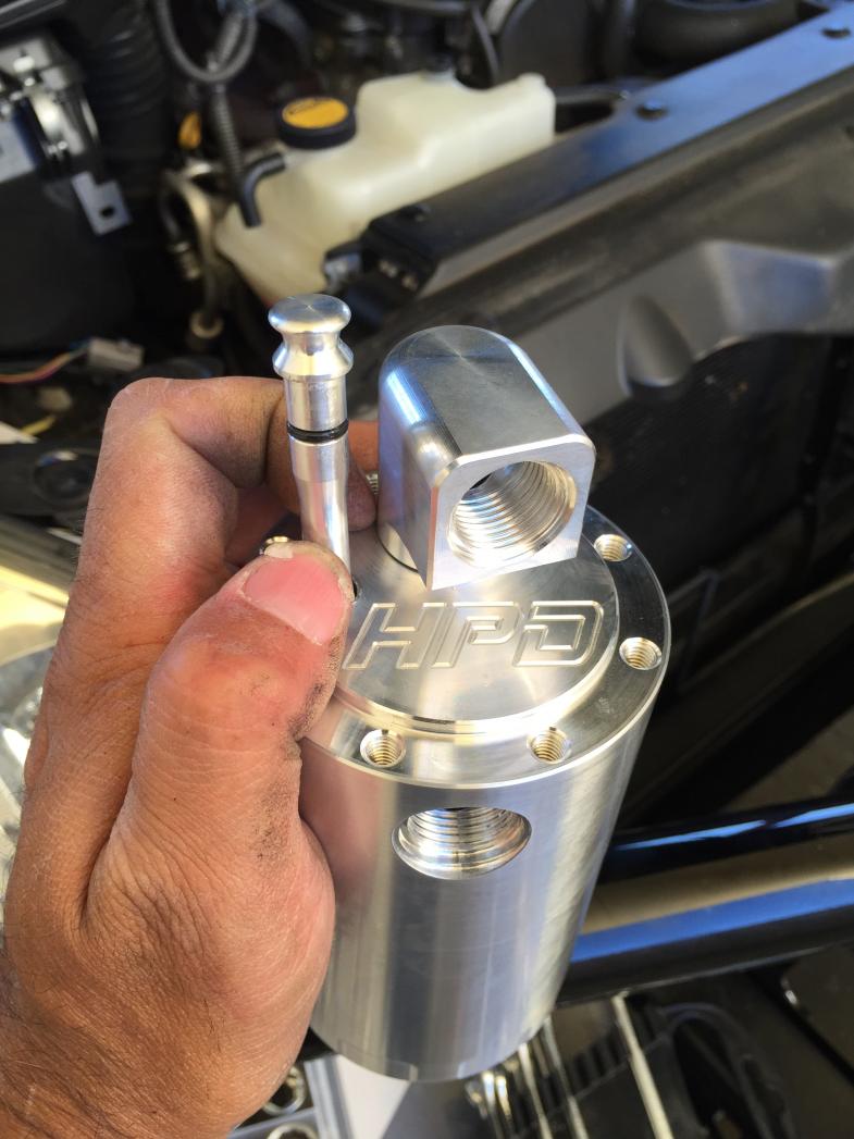

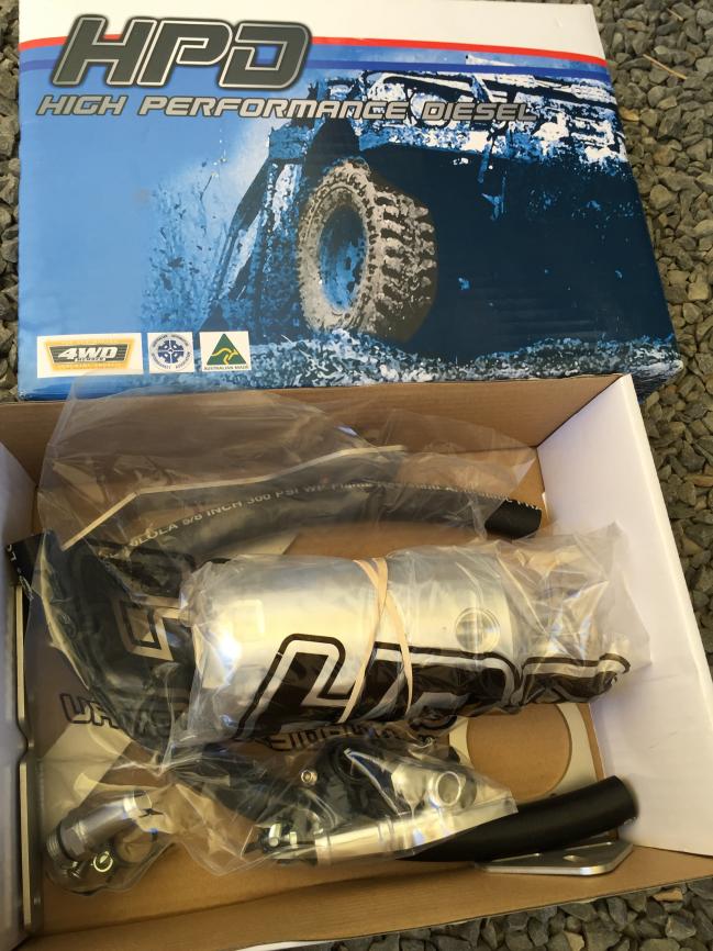

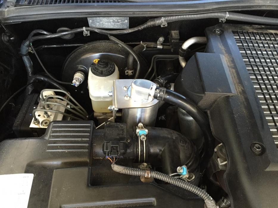

    OK first mod done was the oil catch can by HPD diesel herein Adelaide. its a little more expensive but i chose it due to the brackets to mount it in the engine bay up in the drivers side so i can still fitt a duel battery plus the billet alloy finish and it has cool things like a dip stick and easy un screw bottom to empty the oil out. plus i had one in a previous Patrol 3'0 so i know the importance of these things and also its fully legal and is pretty straight forward rather than the effort involved in blanking the EGR,
    Black mica 06 D4D GXL. , kitted out to take me where we need to go to feel free......

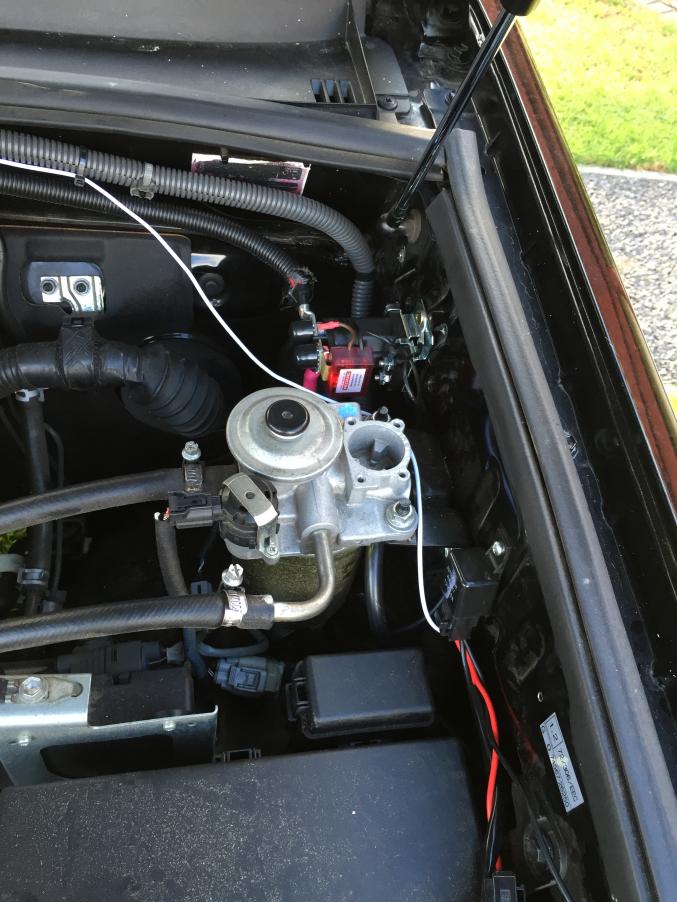

      finished product,, nice and neat

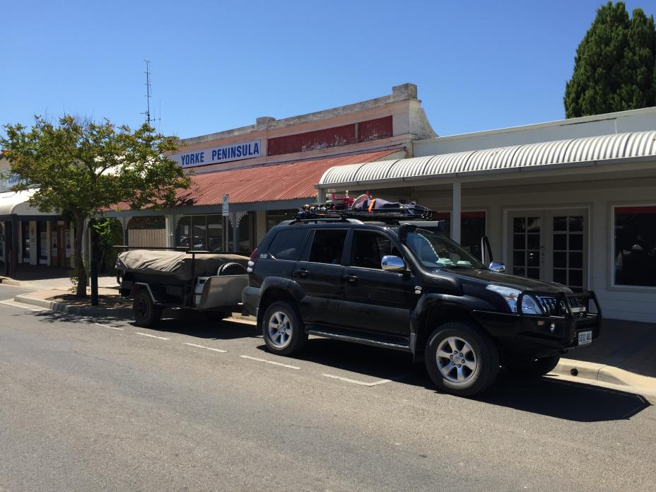

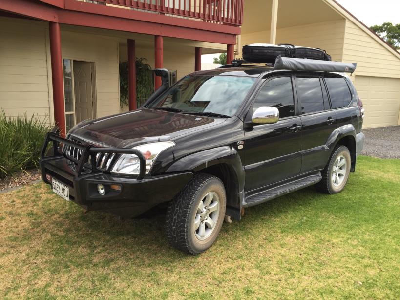

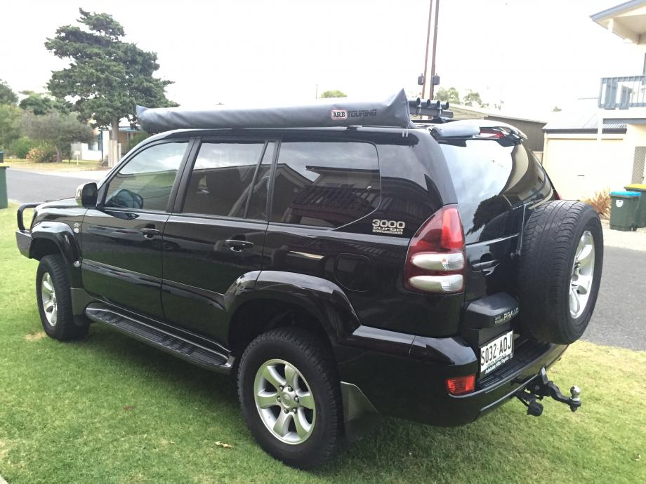

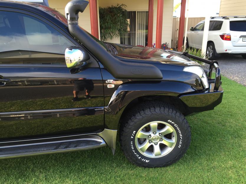

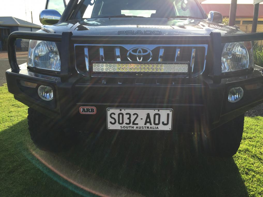

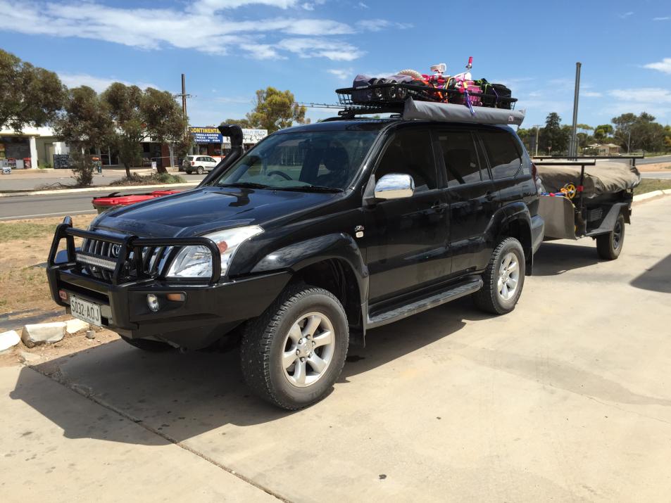

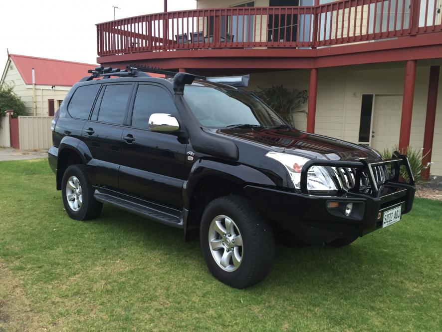

        next step was the part where it turns from soccer mum car to looking for like an off road rig... booked her into ARB here to fit a Deluxe bullbar, colour coded in black mica and also a safari snorkel... last Prado i was running a Sov bar and Ironman Snorkel. good gear but the Safari snorkel is pretty good...was a toss up between Air tec which hugs the pillar but seeing though the bar is ARB made sense to just get the Safari one. No spotties as theyre too bloody expensive from ARB ($900 fitted for LED).. also put on my old awning from my 80 series cruiser i just sold.
        Just got back from a trip to Marion Bay in the Yorke Penninsular here in SA hence why shes all dusty... no better feeling than getting back from a good trip with a dusty wagon!

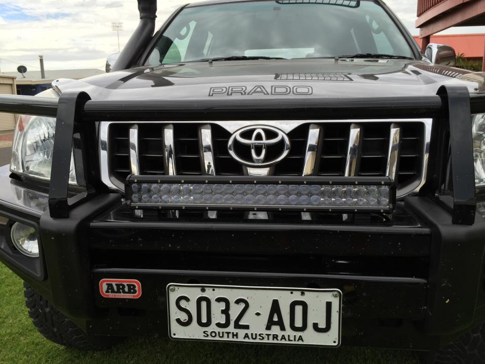

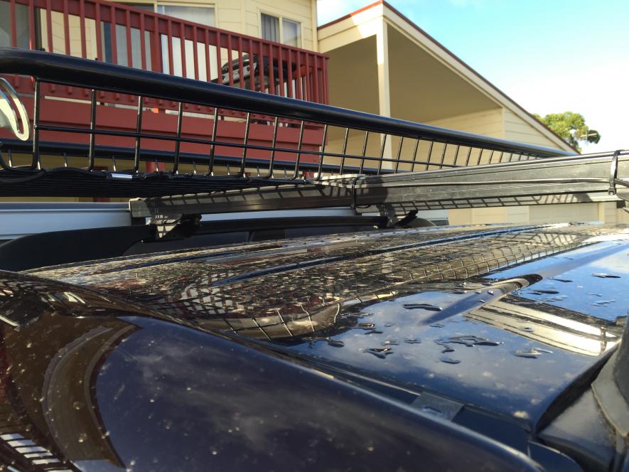

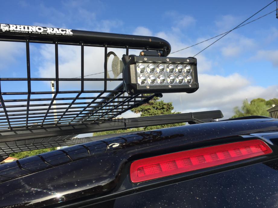

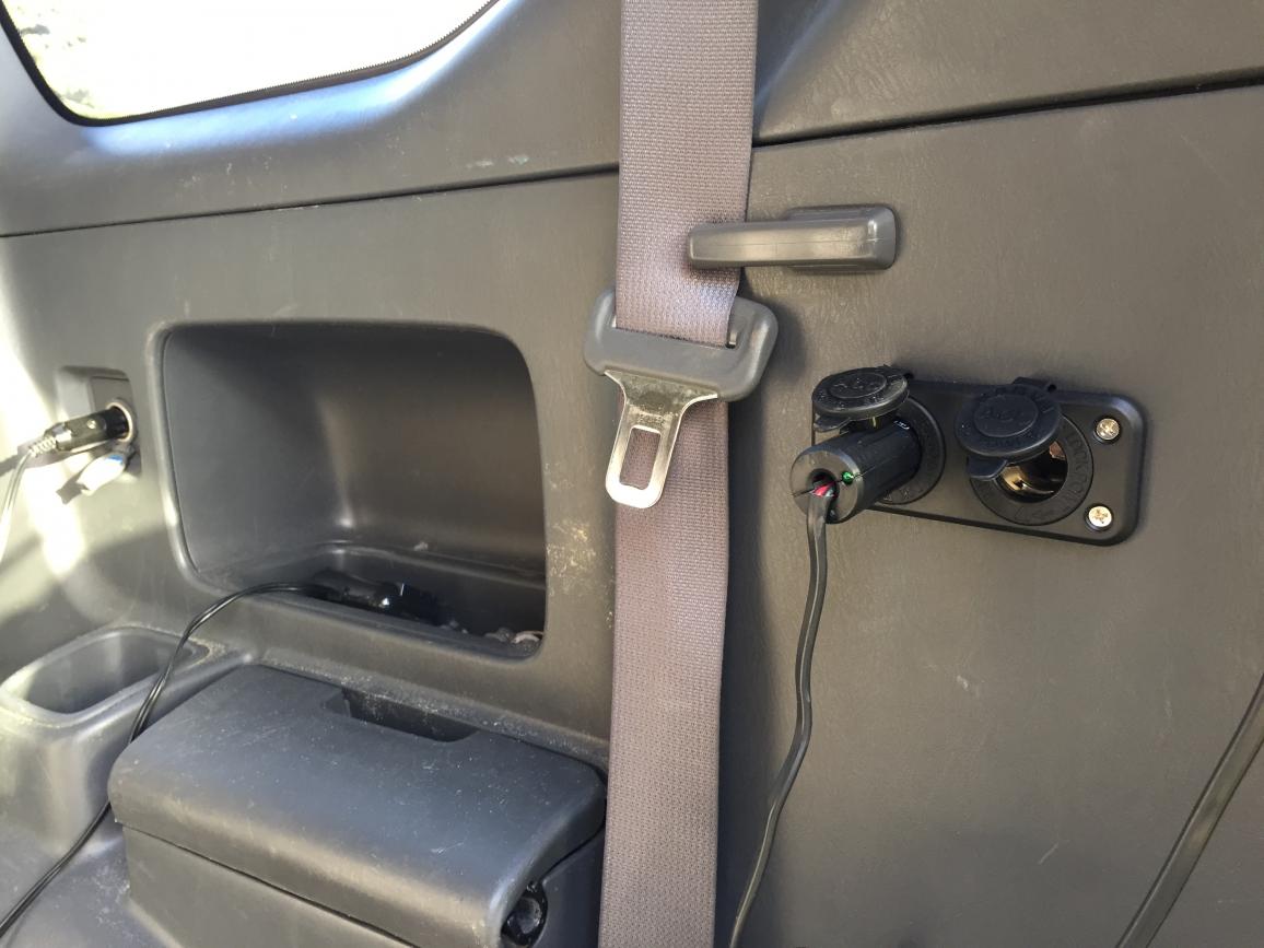

            next thing on the list is some LED lights. I got a cree one from Ebay, 144w and 6500K lumens for $79 and a rear work light for $35. being 35w is pretty good for seeing in those late night/ early mornings at the boat ramp.. nothing worse than trying to back, launch and load in the dark... i just fitted a 12V plug to the rear light so i can just plug it into the rear 12v socket in the rear which runs off the starter battery. its pretty simple that it works when the cars on and was pretty uncomplicated to set up. I just fitted it to the Rhino nanna basket on the roof so its nice and high plus its cheaper than the $380 Kaymar set up!

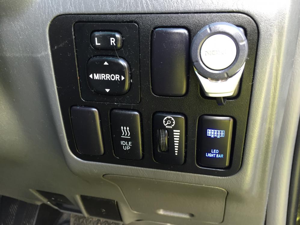

            The front light bar i got a Toyota switch type loom from ebay so the switch on/of switch looked factory... nice touch and easy to install.

                  loaded it up with the Camper and the kids for a trip to beautiful Moonta Bay... really no sag at all with 100lts of fuel, 3 of the kids, dog, gear and 1300kg of loaded camper on the rear.......

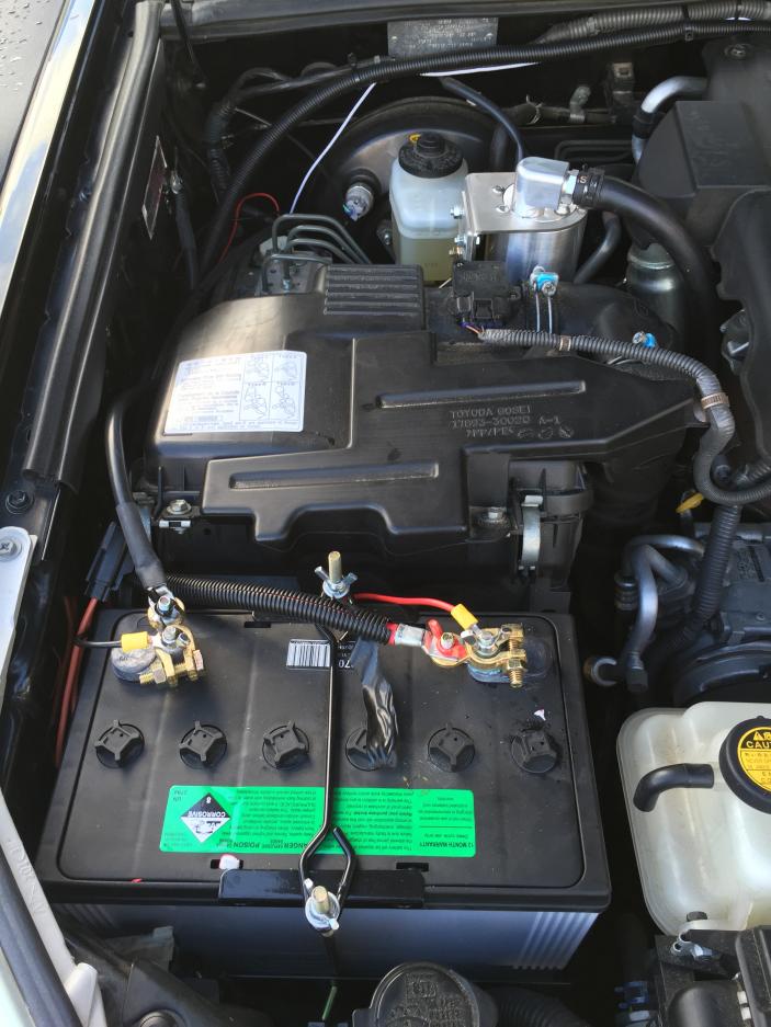

                        ok so after a few trips minus a duel battery set up and no fridge it was time.... i contemplated a portable 12v battery like the Baintech type but for roughly the same price if i install the kit myself its better to have the set up in your car 24/7 to keep the battery topped up and running a current through the deep cycle battery..(they dont like going flat).... i got a 90amp/hr battery plus the Smart Charger from Red Arc and the BOSS battery tray/ kit from FNB 4WD in Mt Barker. they have a web site plus sell on Ebay too.... excellent tray and solid as a rock. neat install if i dont say so myself....but ive done a few now,,,,,haha
                        *note that dodgey white wire is from the LED light bar soon to be relocated to the deep cycle...

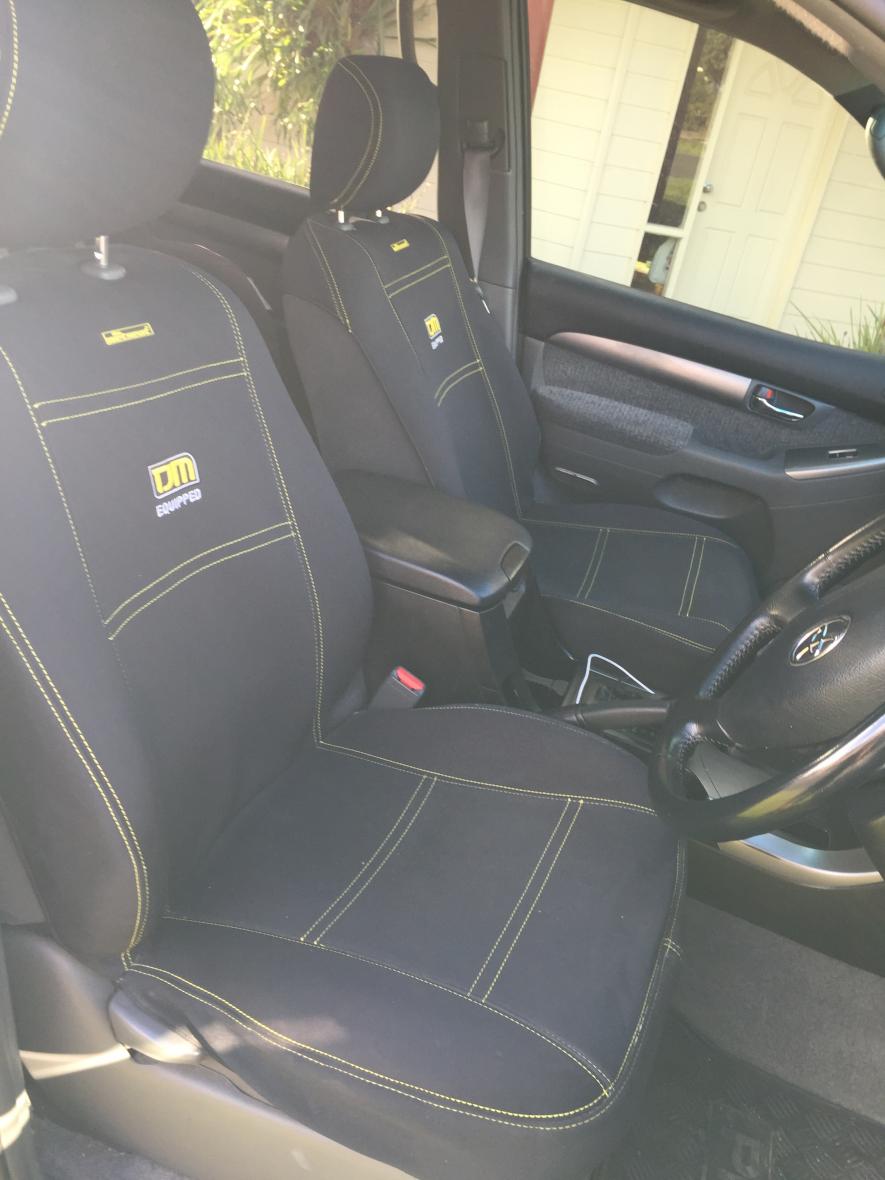

                          another great mod is the TJM wet seats.. neoprene and water proof.....which means sand proof and kid proof...great if you spend time in and around water like us..!

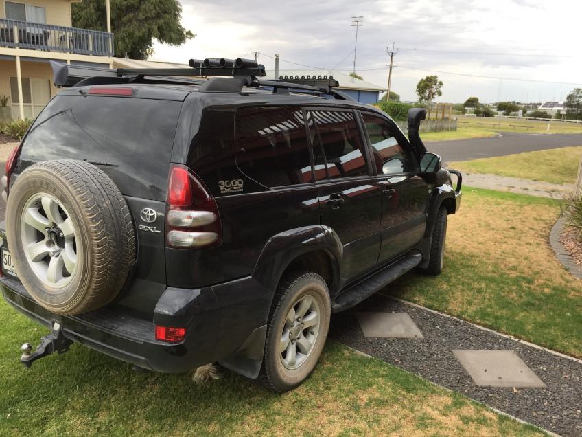

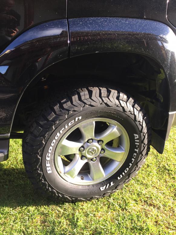

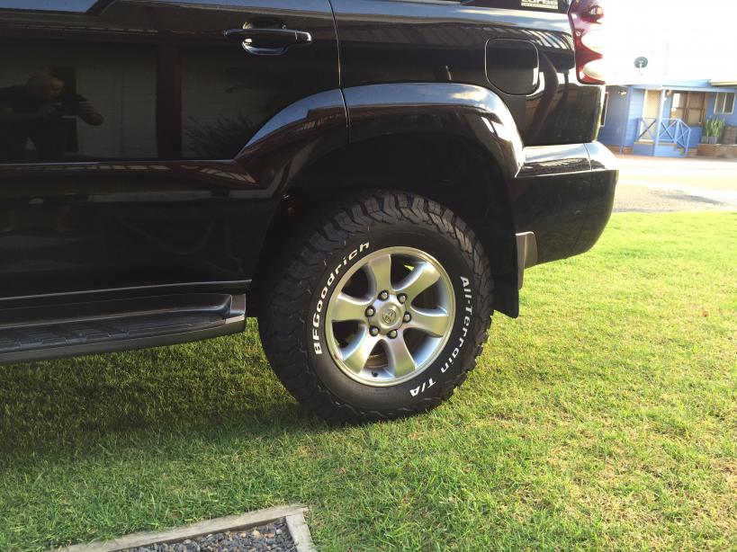

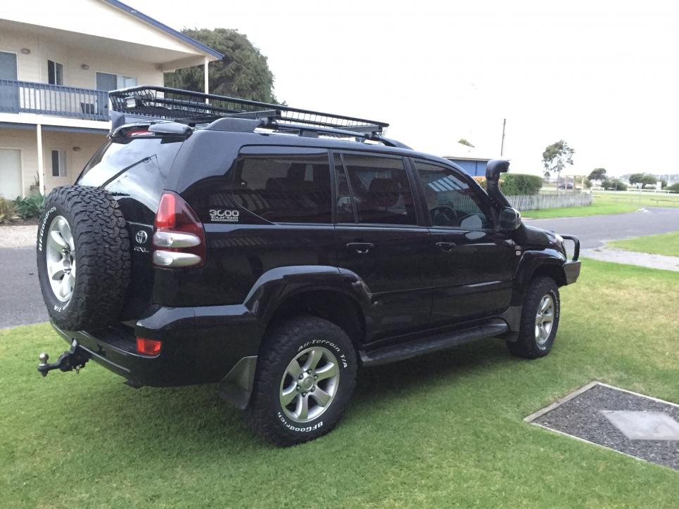

                            Time for some new rubber.... going up to the 265/70 size and wanted good quality...after having nearly ever good tire on the market from BGF KO to Dueler 697LT, Mickey T ATZ 4 ribs, goodyear wranglers, Cooper ATR, i decided on BFG KO2. had them on my 80 series which i just sold so know them well. Tough tire with a better design than the last... look great too and pretty quiet on road.
                            think they look great... had to fit spacer on the rear door which was the dog bone type from TJM for $26... bargain.

                              was tossing up going 275/65 but ended up going 265/70.....both look good but i guess 265/70 is more common?? dunno they dont look too big but are slightly over whats allowed here in SA maybe? dunno i figured taller profile allows a bigger footprint length ways when running lower tire pressures and gives more lift too so functionality over fattness wins!
