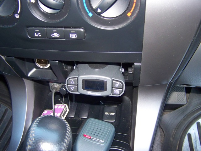

    Youre brake controller is easy to fit, it just takes time. The hardest part is getting to youre brake pedal switch, then running a feed brake cable from the cotroler to the tow bar. Other then that its just power from the battery and a negative. Good luck anyhow, Zook.

      Cheers Zook, sounds straight forward.

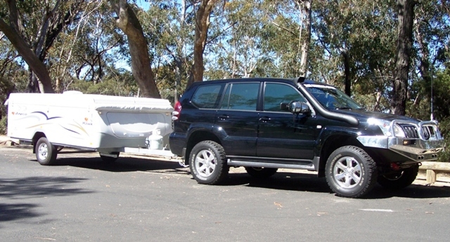

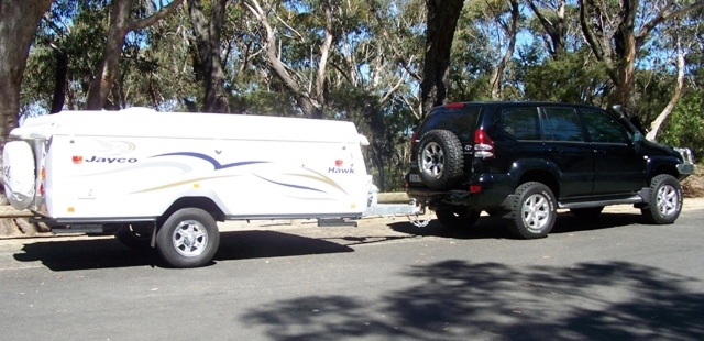

              Latest additions:
              - Tekonsha P3 brake controller - unreal, highly recommended

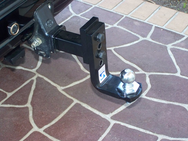

              - Drop hitch - to lower tow ball height
              - and the jayco Hawk (am I allowed to include that??)
              Will add photos of 1st 2 on the weekend.
              Cheers and happy touring :lol: :lol: :lol: :lol:
              [attachment=1:3pvuc0uj]jayco1.JPG[/attachment:3pvuc0uj]
              [attachment=0:3pvuc0uj]jayco2.JPG[/attachment:3pvuc0uj]

                Looks Good, PradoBB. you gotta be happy with the mobile home.

                    Added, Hayman Reece drop hitch. This is also recommended for those who have the Jayco style CTs as it gives a little extra length which means you can extend the bed with the vehicle still connected to the CT.
                    [attachment=1:3u4w4aq9]drop hitch.JPG[/attachment:3u4w4aq9]

                    A Tekonsha P3 brake controller to keep everything legal and under control.
                    [attachment=0:3u4w4aq9]brake controller.JPG[/attachment:3u4w4aq9]

                      How ya going Prado BB?
                      Like your setup. prety close to what ive got but no bull bar and im white.
                      in some of your other picks your hawk looks like its got different boots on, if they are could you tell me the size & did you change suspension on the hawk to fit them.

                        Hi SteveMc, originally the hawk had the standard 14" alloys and road tyres. I have changed them for the jayco 15" and mud terrains. The axle is now underslung - therefore allowing the 15" wheels to fit without rubbing. The hawk also sits level when hitched to the Prado.

                          Thanks for that Andy i thought it looked alot higher than mine :| was thier any problems with brake lines
                          and the corner legs?

                            No problems with brake lines, the legs were a little short post the lift, but I scored some longer ones cheeply second hand and it's no perfect.
