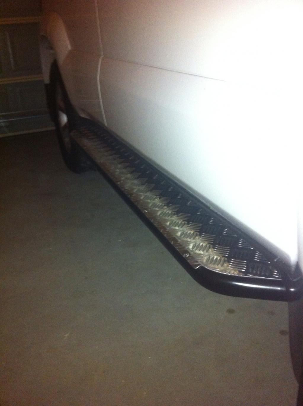

        • AJ120 Rock Sliders Fitted
          So happy with the quality and ease of fitting only took 1hr to fit. And look great thanks again Andrew LEGEND !
