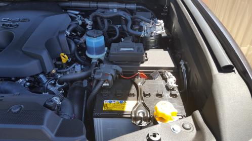

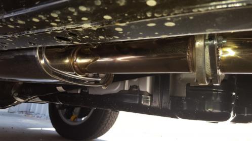

                          Just some more pics of the new Prado - suspension back/front and engine bay/DChip/Second Battery and T304 Torqit Exhaust. Getting it ready to go cockling (cockles=pippis) at Goolwa beach next weekend., so working on the roofrack at present in prepping shovel holder/maxtrax brackets etc.

                            I bet the 12V cable generates a mighty EM field when your compressor is running. The 100A fuse must simmer too.
                            My CKMTA12 guzzles over 50A when under load. The Auto Sparkies recommend running it off the main battery with the engine running.
                            There is zero room under the bonnet for a compressor in the Prado. However, Toyota did the world a favour by making room for an Aux battery.

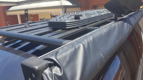

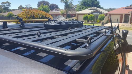

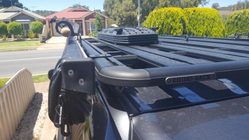

                              Just some more snaps of the rhino rack - maxtrax and shovel on, car washed, ready to go to Goolwa Beach tomorrow for some cockles/pipis
