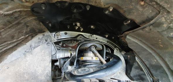

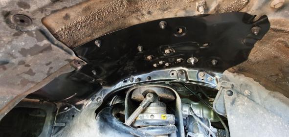

        Took longer than expected, easy 5-6hrs to do both sides. Would be faster if the peices went straight in and the list I used had enough clips so I could just snap all of them and replace.
        - Jack car up, wheels off, both guard liners out - needed to salvage some of the clips as I only had 10 for the guard liners and I needed double that really.
        - Both batteries out, one battery tray out, airbox out, charcoal cannister out.
        - Both skins needed modifcation, drivers especially, as I absolutelly could not get them in place without opening up some of the holes they have for the existing captive nuts on the guards. I was bending the piece so rather than risk crinkling it up, opened the holes to allow clearance.
        Ended up with a few extra nuts and bolts also.
        Also serviced the car, have opted for genuine Toyota oil (10w-30) as it's on par with any decent semi syn I looked at ($145 for 15L to cover my next 2 services). Cannot detect any discernible difference to the Shell Helix stuff the service records show was being used. The Toyota oil is rated for the petrol and deisel so my guess is the petrol guys end up with clean engines as the oil would need detergents in it for the diesel guys.
        Will need to buy a grease gun so I can do the yoke/uni joints etc.
        Anyway, nice to habe piece of mind that there should hopefully be no cracked guards here.

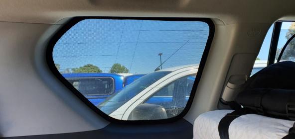

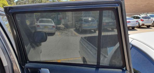

            Haven't fitted sheilds yet, was busy servicing the bike, but did receive and fit the window shades, the fit in quite nicely. Will see how they fair at speed with the window down a bit, I'm told that there's been no issues with them at 100km/h, we'll see.
            I'm told the front window ones fit nicely on the back windows also if having them up front becomes an issue.
            They have magnets in them and just "sit" there nicely, but the kit comes with double sided tap and slide in tabs for them also if needed.

              As for the window shades, with the windows down the there's some new decent wind noise in the upper corner (driver side) which goes away when the shade is removed. They hold on at 100km/h no worries other than the noise. I'm told the front's will fit nicely in the back window with some overlap. I may put them there for the most part but put them in the front on long trips.
              Visually it kinda looks like it needs a 3rd weather shield on the rear cargo window.
