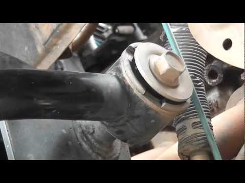

                      • Whilst searching for the cause of very excessive noises in the front I came across a few issues...
                        The tie rods ball joints were worn, especially on the passenger side. They were originals and the seals were broken, so I'm not surprised or worried about having to replace them. New ones are seen below:

                        • This video shows how much movement it's allowing:
                          I contacted the supplier in USA, who contacted the manufacturer, SPC. Their response was that bushes are maintenance components, and they offer newer heavier duty ones at a cost of $20 a set; "SpecRide" they are now called.

                            • Hi Glen,
                              10 months, thats a joke! Probably installed by an apprentice that pressed them in by the inner race, or a cheap nasty chinese bearing. Can you see the brand on the bearing?
                              Also poor form from SPC. Looks like a dog of a job without a press!
                              I see you use Cable Ties to hold your caliper up. You seem to do a lot of work on your car yourself, sacrifice a coat hanger and cut two lengths and make two 'S' shapes with more of a curve on the tail ends with the two pieces. Put one end through one of the bolt holes of the caliper bracket and hook the other over the Spring or UCA. I used the same two I made for years when I was a Tech and still using them to this day. Saves wasting cable ties!
                              • Originally posted by glen_ep View Post
                                Is the inner steel collar free to turn when the arm is bolted on or is it firmly clamped against the chassis mount? If the latter is true it would be important to install the arm as it would sit on level ground, so the bushing isn't being stressed 100% of the time.
                                Either way though, 10 months is pretty poor show considering the OEM ones lasted +10 years.
