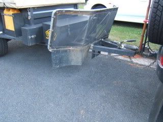

Mudflaps for the trailer to stop stones flying up and for the car to stop them getting back there.
The car flap is made from gate post gal, very cheap at Bunnings with modified L brackets, same source, welded on. All bolted to the concealed nuts under the exhaust tip and the recovery/tiedown points. Thye are mirrored on each side. I needed to buy longer bolts to go through the tiedown bracket and the new bracket.

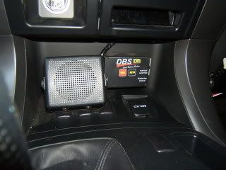

Remote speaker position and Dual battery controller.

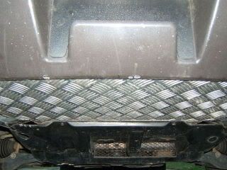

The good old bash plate.

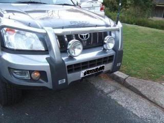

Driving lights- Night Stalkers
