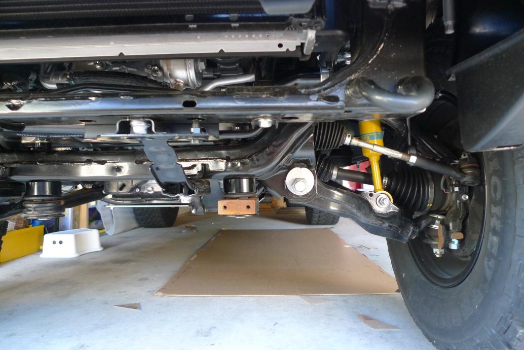

                  • Diff drop now fitted to the FJ and the CV angles looks a bit better.

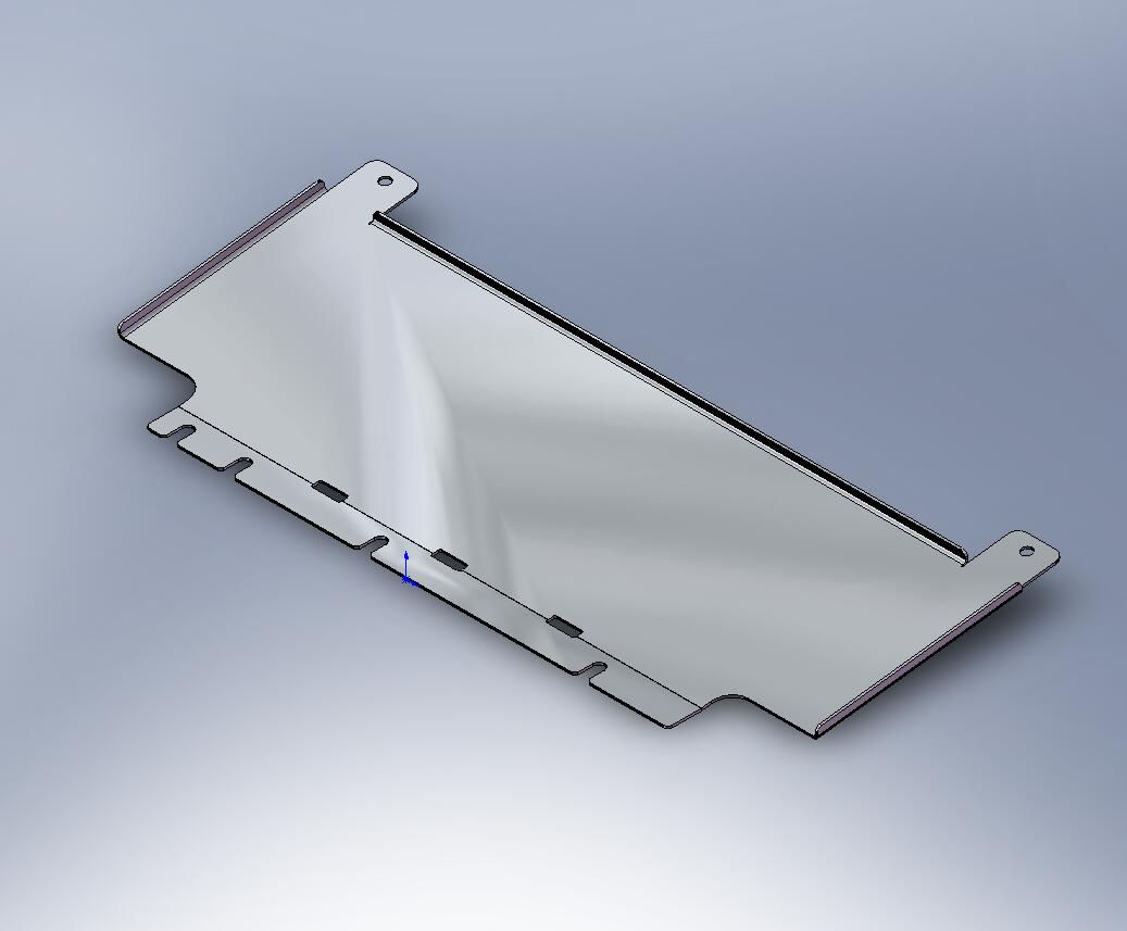

                    • It's been a productive long weekend with the 'girlfriend' now out of Adelaide.
                      The 120 radiator to Sovereign bullbar plate drawing has now been submitted to the fabricator for prototype production. It will require drilling holes in the Sovereign bullbar and is compatible with the Toyota winch cradle. There will be a 3mm rubber washer in between the plate and the Sovereign bullbar to prevent metal-on-metal rubbing. Pricing TBD.

                        i'm in!! Andrew two holes at the front look fine, what size?
                        • Originally posted by pjorek View Post
                          They're M10 bolts going through those holes. That's where the rubber washers will go.
