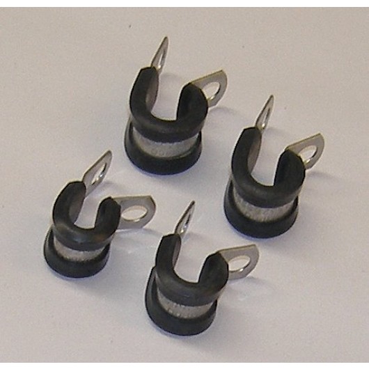

                    A company recommended some of these which apparently fits perfectly to any 1/2" wide hose clamps. Pic below is what I have found on the net. The company did not have their own pic so will take a drive downtown to have a closer look.
Name:	Rubber Strip.jpg
                    • #40
                      I remember seeing this stuff on A/C chilled water pipes for clamping of the copper pipes of various sizes to unistrut etc...
                      • #41
                        Yep that's it. Essentially, I'm trying to achieve this.

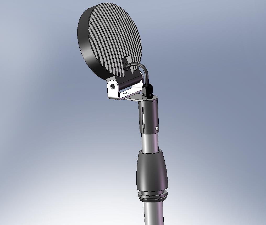

                          The connection of the light to the top of the pole
Name:	light fitted.jpg

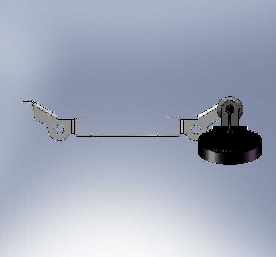

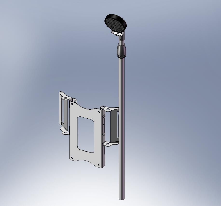

                                Updated pole bkt which allows an antenna to be mounted.
Name:	spacer with pole bkt and antenna mount.jpg
                                Top view (also shows pole bkt mounted on either side.)
