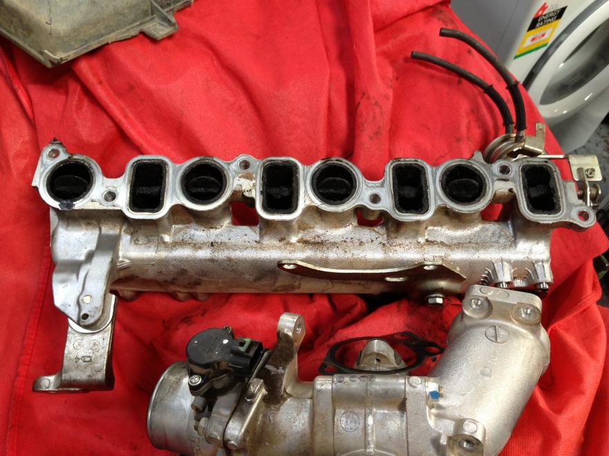

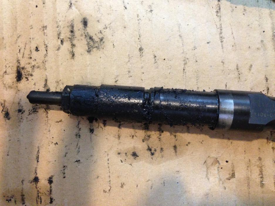

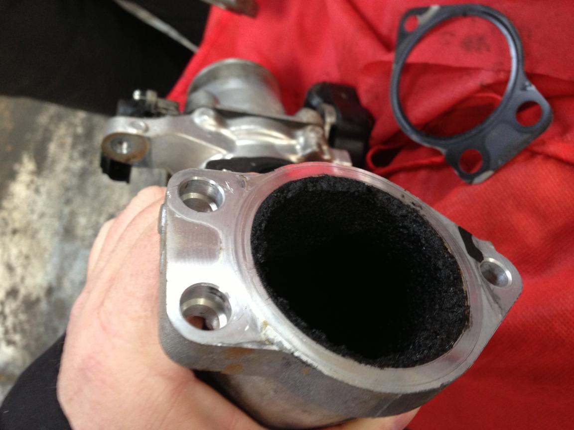

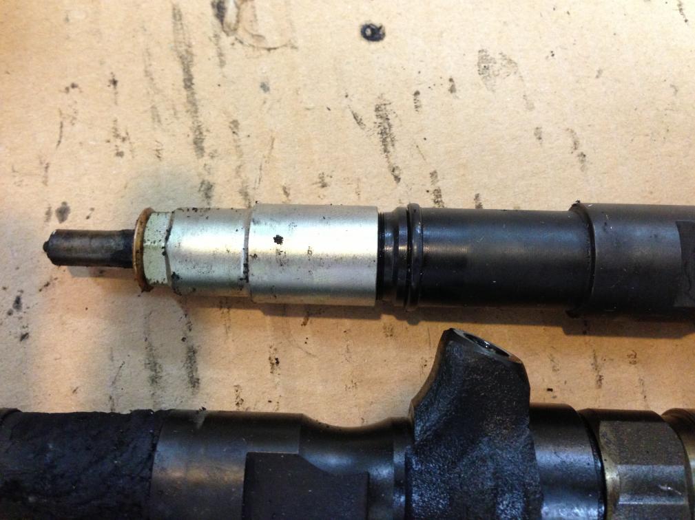

                          • Well, I though I would share my good fortune. Here are some pictures I snapped of my intake manifold, egr and injectors - not a pretty picture...Click image for larger version

                            • Thanks ########## - but I took these at my mechanics - this is far to daunting of a job for me (and I don't have a shed :neutral
                              If you see my earlier posts in this thread, yeah the sump was blocked. I wanted to share mainly the failed injectors, what a total failure looks like. The mechanics couldn't even get out 3 of the seals on the injectors......
