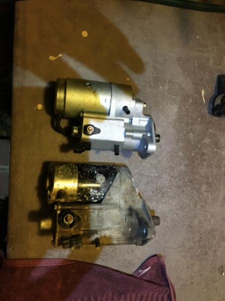

                      Just visited Repco, they do not sell any kits, so in the end I just bought after market one for supposed trade price of $260 (supposed retail price is 403). So I might have to change it tomorrow after work, as at the moment, I need to hold the key in the starting position for about 2-3 seconds before it turns over (mind you mind battery is pretty much on the way out - will need to buy a new one - decided on optima yellow top, but that is another story). Well I will try to fix the old one and keep it as a spare (or I might put it back and keep the new one as a spare)
                        I have spend 6 hours under the car last night, I had to take the bash plates out, then I could not get one of the nuts holding the SM loose. I have a pebbled driveway so the job under the car is not easy. Got the SM out, and when I compared it to the repco OEX one, it is much heavier and good size larger and feels sturdier, even the positive terminal connection is larger then the Repco one. No wonder the Repco one costs only $260. So I was somewhat reluctant to put it in,so I decided to take my apart and see what it looks like inside.
                        Doing it I have stripped one of the Philips head screws that hold in the brush assembly to the front cover, so I had to drill it out, fortunately I had a similar screw to put in. I have never done this before, so it took me a while to figure out how to put the rotor back into the brush assembly once I pulled it out. There was quite a lot of moisture through out the whole SM. I was under the impression that these things are water proof, but they are not, they even have two breather/drainers. So every time one gets into a deep water water gets into these things, so no wonder they play up after deep water crossings. I be bit reluctant from now on to cross deep water, knowing how easy water can get into the SM.
                        I could not take apart the part where the gears are, as I do not have proper tools, and was afraid I might strip the three Philip head screws that hold it together. So I cleaned it and sanded the contacts on the plunger,and after some difficulty put it back together. There was some steel ball loose in the whole into which the plunger goes, and this would interfere with the spring on the plunger, But eventually I figured it was OK when the ball was et the bottom of the whole the plunger would go in and out without any issues.
                        I put it back together praying that it would work, and lord behold, it does. So I might keep the repco one as a emergency spare, or if possible return it and save up money for a genuine Japanese one, because I do not see the Chinese after market one working for too long under harsh conditions. All together it took me about 10 hours, but mostly because I was not sure what I was doing, and was trying to figure out what to do.
