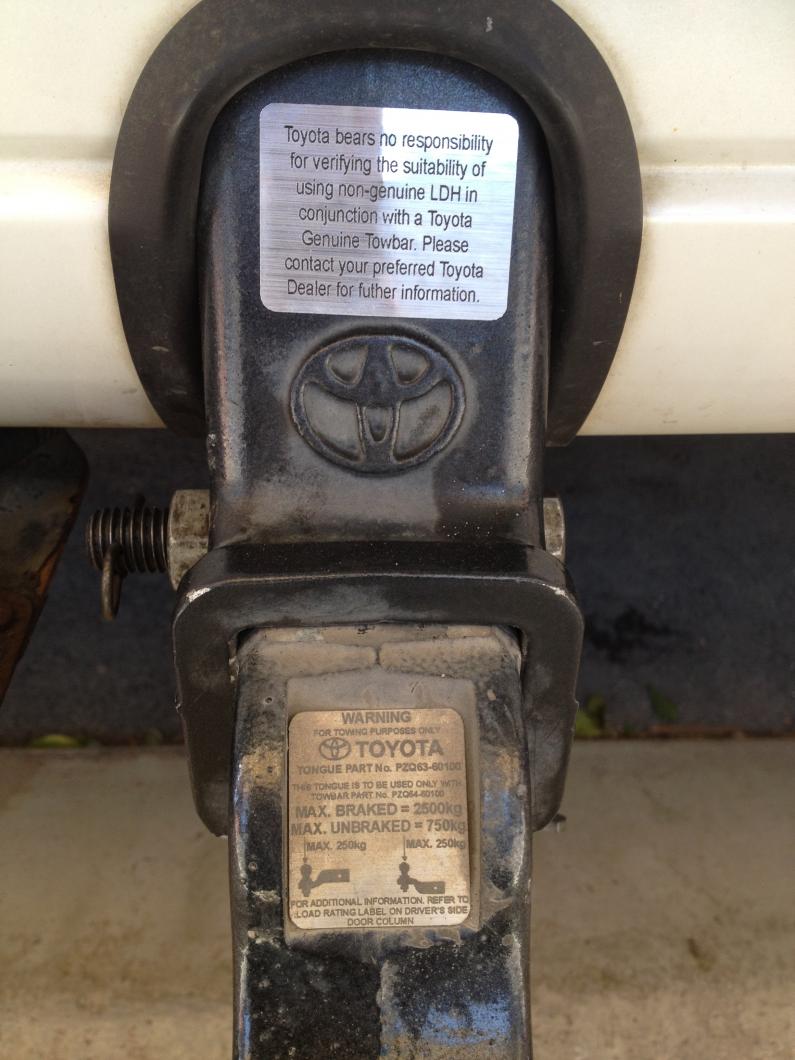

I picked up my 2007 Prado today after a 90 000k service and my tow bar had been replaced. They wouldn't call it a "recall" instead referring to it as some sort of "customer dissatisfaction response" as people had experienced cracking in the tow bar from using load distribution devices. I don't tow anything more than a 6 x 4 box trailer but my bolts were found to have signs of movement so they replaced the whole lot. Apparently it's a more heavy duty version of the old one. It looks the same as far as I can tell and comes with the warning sticker on it. The service guy said that letter's hadn't yet been sent out to customers regarding the issue.Morrie,

Ok checked the other day, it's not a safety issue so no official recall, but as stated above its a customer satisfaction issue. You won't be getting a letter.
If you own a Prado 120 with Gen. Towbar have it checked for bolt tension and any warping or cracking of the Towbar itself. If faulty you get a new Towbar
If you use a WDH, Toyota will replace it free of charge with their Genuine (recently released) WDH.
Pretty simple really, case closed.
Get the service guys to search their service bulletins if you get the common blank look.
(Edit: if you have non-gen Towbar then it doesn't apply)Last edited by Hendo66; 19-10-2013, 10:19 AM.
