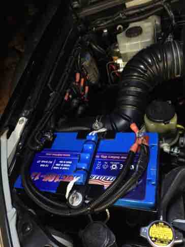

Great battery. Have a 120Amp in the rear.Originally posted by craigm View PostAs per my build thread, replaced my Auxiliary battery tonight with a Fullriver jobbie... (Dc105-12)
[ATTACH]23218[/ATTACH][B][COLOR=blue]Bitumen: A blatant waste of taxpayers money![/COLOR][/B]
