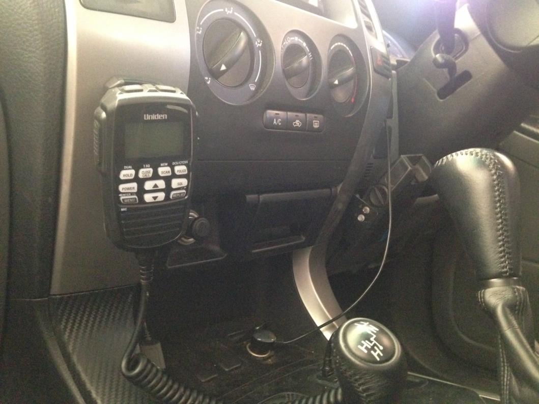

                • finally installed my 2 way radio. had the antenna and box installed behind the dash for a while but finally wired it in, ready for my trip down south next month.
                  Unit is a Uniden UH8080NB
