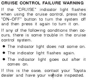

          The owners manual has a piece on this which tells you to turn the cruise on and off to cure this but my money is a brake/clutch(if manual) switch issue. Or brake light bulbs!
          Unfortunately I only have the extract as an image and can't copy and paste it!
