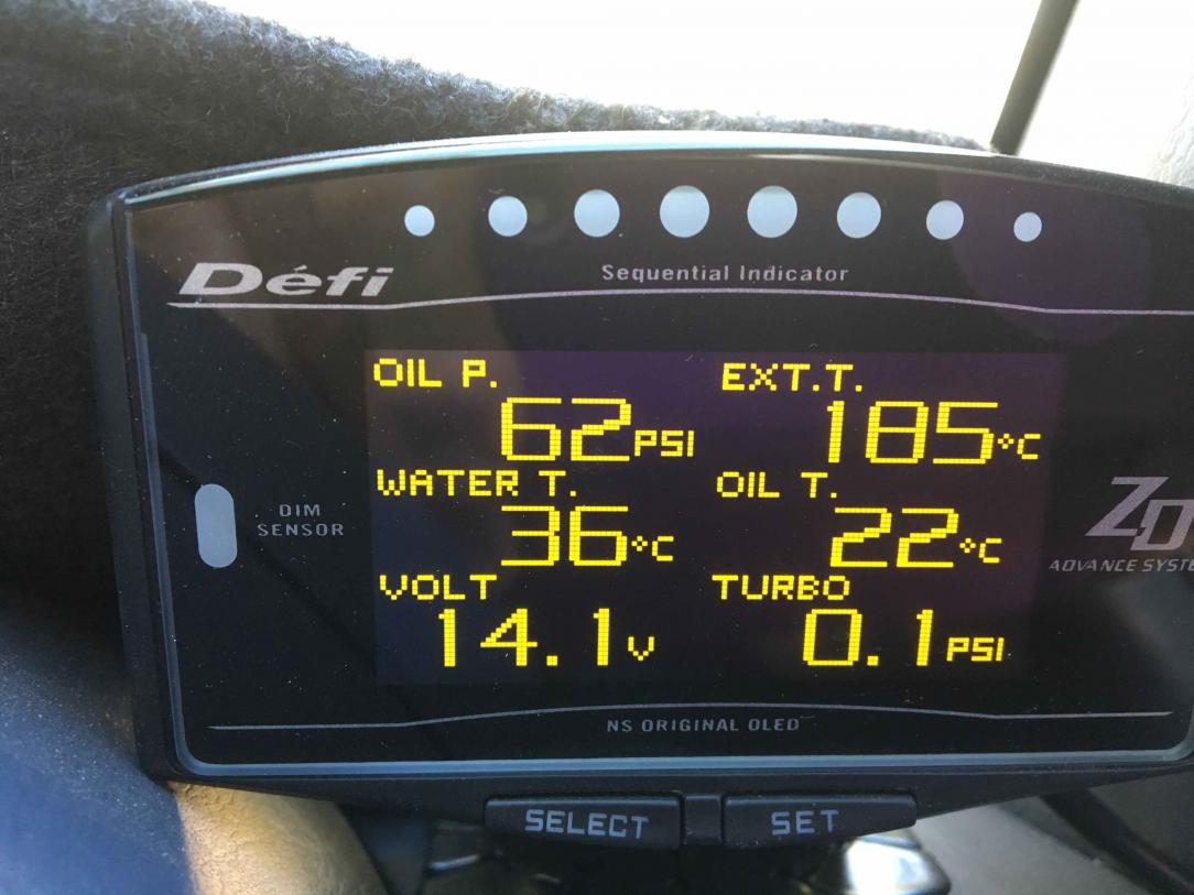

              This setup was cheap and monitors a heap of parameters. The oil temp is auto transmission oil which climbs really quickly when towing and out of converter lock. Can datalog and all functions have adjustable alarms if you're keen enough to bother. You can flip from screen to screen or just leave it with the items you monitor most often which is what I've done.

                Cheers, any more info on this setup. I like the look of it too.

                  Bought on an e-bay store for a bit over $200, Defi knock off made in China.
                  Has a processor that all the sensors run to, then a tiny cable goes to the display.
                  Another cable runs from the display to the hand control which I've tossed in the big hole, top of passenger's side dashboard.
                  You use the hand control to set your various options and after that it's not really needed.
                  Apart from the 6-functions that I monitor, there's also RPM, speed, time and air/fuel ratio.
                  Was cheap enough, a bit difficult to install as most of the sensor wires were too short to reach where I mounted the processor. Once installed though she's works fine (touch wood)
                  I mounted the display on the top right driver's side of the dash, fits perfectly in the space and doesn't block any vision. Double sided sticky comes in the kit.
                  I lifted my dash mat and it hides underneath for those really hot days.
