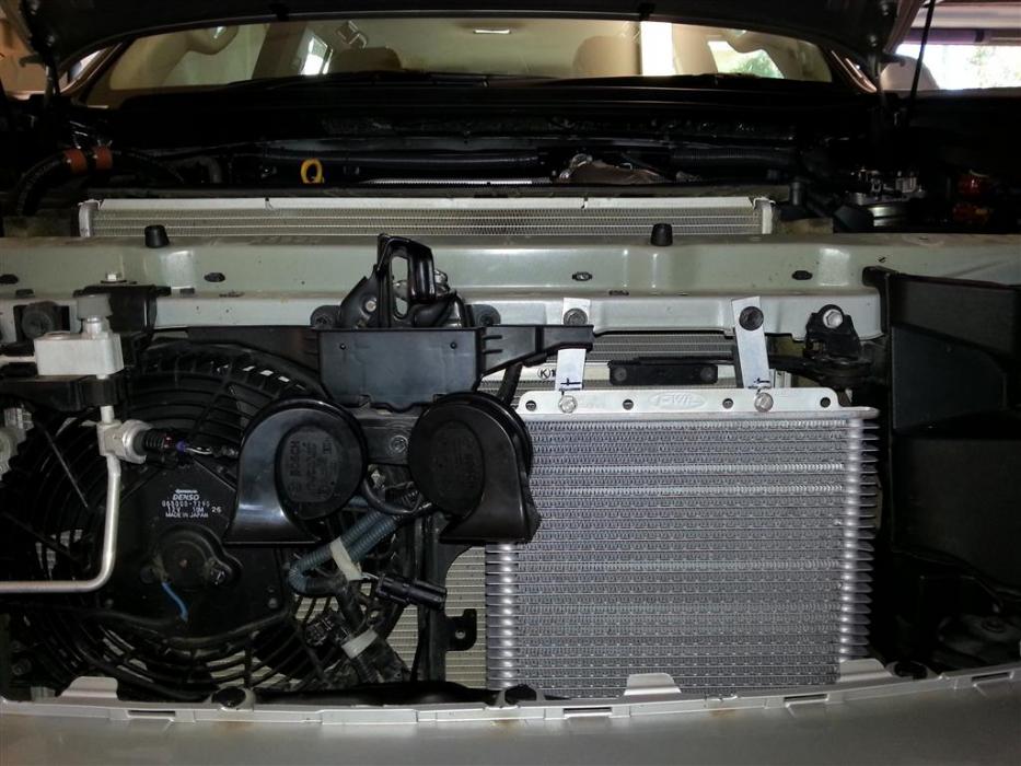

                              I bought a set of these Bosch horns for $30 of ebay, much better sound but I had to relocate them to fit the transmission cooler.
