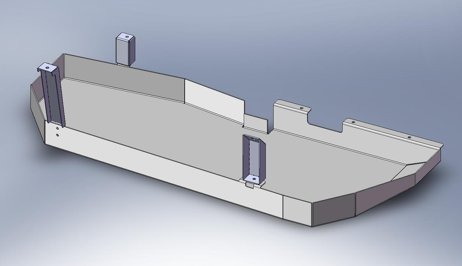

                I've started looking into this. Here's a rough sketch just to gauge from the fabricators what sort of money this is going to be. Then modify to suit to bring the cost down.
                  [ATTACH=CONFIG]15288[/ATTACH]
                  I was just thinking to take mine off & give it to fabricator, to make out if 4mm, then they can get the 6 mounts 100%

                      AMTS do you think there should be some drainage holes? I would be concerned it would perhaps fill with water or stones without the holes.
                      What do you think?
                      Greg - 08 D4D Prado,
                        What do you think?
                        Yes it will. This is just a rough model to get estimates.
                          I'm over repairing the tank guard. Bring it on Andrew.

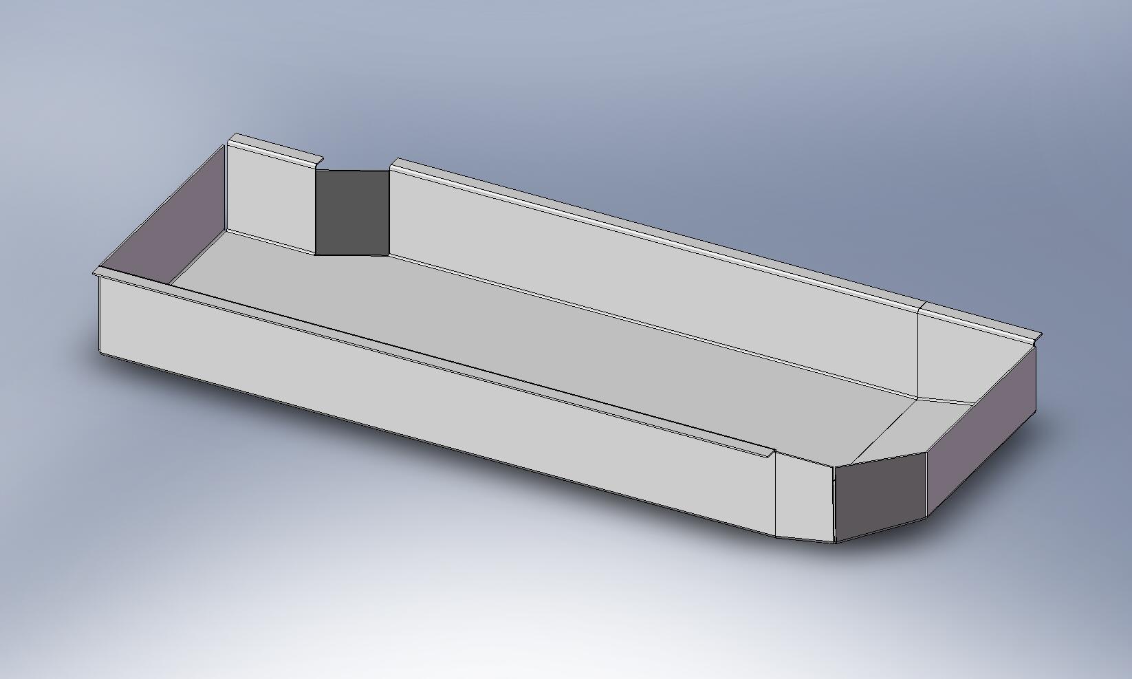

                              It's a lot more complicated in shape than first thought. I haven't added the drainage holes yet.
