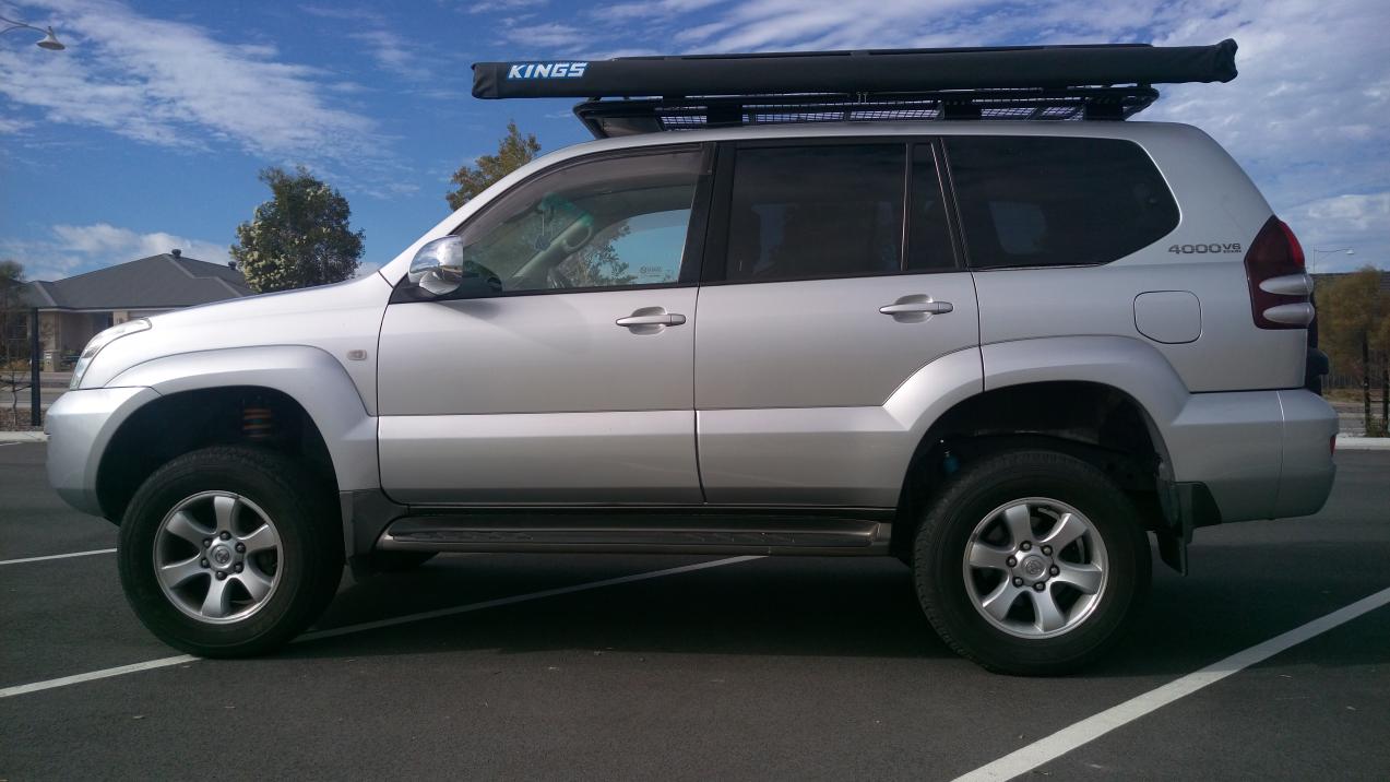

          Thanks amts, just completed a lower control arm replacement and upgraded to King kftr101t springs with a 10mm sensor trick on the rear airbags.
          For general interest the ride and feel of these springs is excellent. Not harsh and maintains a firmish original ride (when combined with ARB bullbar, winch, dual batteries.).
          my front had dropped to 715mm - now 775mm.
          Rear was at 780 now at 810mm.
          Rake is no longer like an F1...
