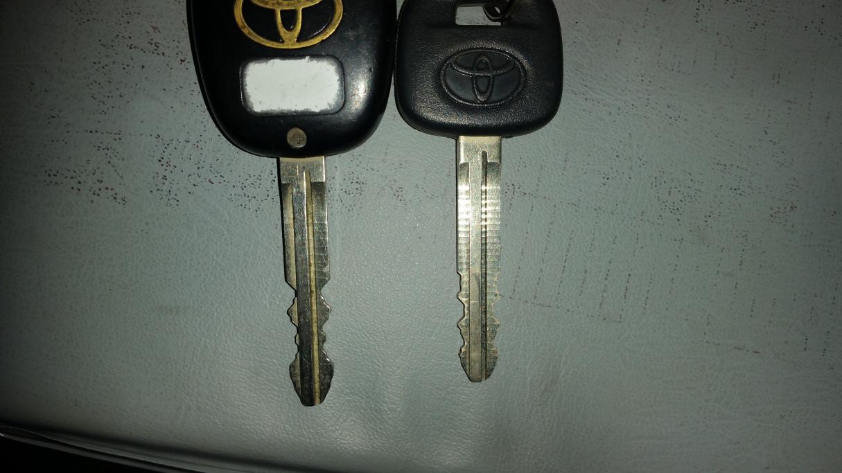

                      Mine has a different key to the ignition, maybe the previous owner didn't give you all the keys or lost one?

                          Mine's definitely a different key
                            [ATTACH=CONFIG]23754[/ATTACH]
                            Mine is not - the 2008 120 uses the ignition key.
