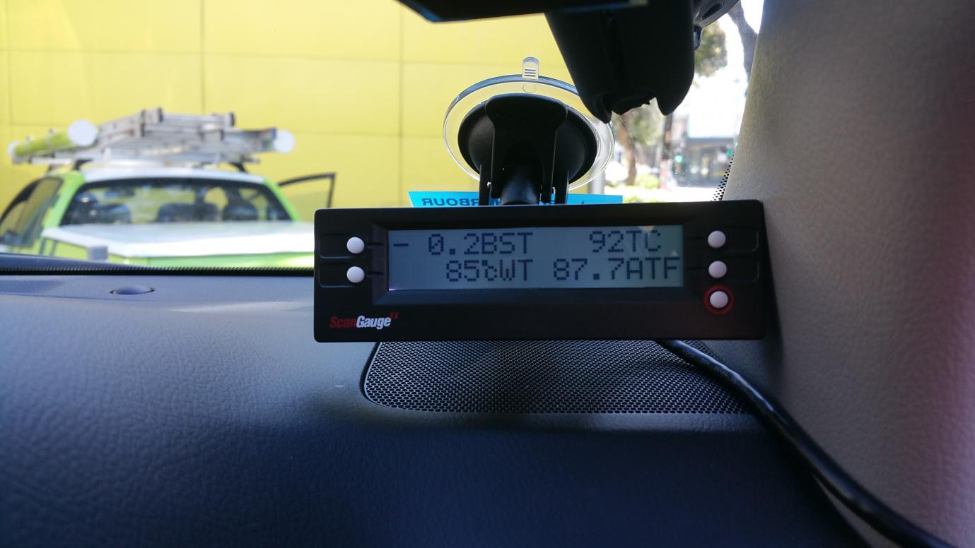

      I purchased the windscreen mount with mine and mounted it on the bottom right hand corner of my windscreenClick image for larger version

            I purchased the windscreen mount with mine and mounted it on the bottom right hand corner of my windscreen[ATTACH=CONFIG]19908[/ATTACH]
            Thanks Nightrod111, my SGII arrived yesterday and i might end up purchasing the windscreen mount too.....

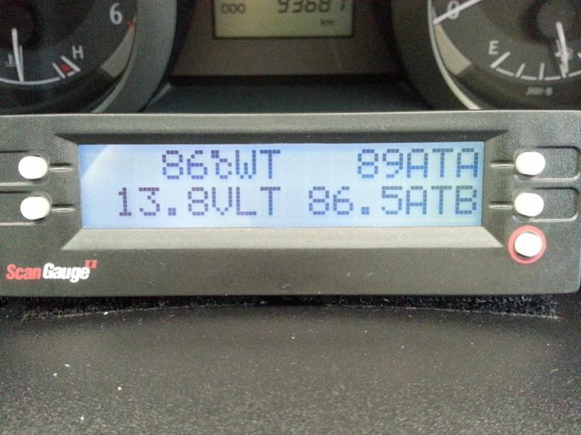

                With the help of this thread and the manual I have setup my ScangaugeII with the following reading which I want to keep an eye on, so in return I thought I'd post my setup used with codes and a picture. Keep in mind that the outside temperature was 43C when I took the photo so the figures may be higher than you'd normally expect.
                The two ATF codes and the ability to read and clear fault codes are the key reason for buying the scangauge but when I found that Coolant temp and Battery Voltage could also be displayed it was a bonus.
                I understand that the stock temperature gauge on the dash only climbs high when things are really hot and almost no resolution around the middle of the scale so it's good to have a proper number. I also had an alternator failure a couple of months ago and it became clear that by the time the battery light comes on on the dash then the battery voltage is extremely low. Now I can see from the scangauge that the normal running voltage is nearly always 13.8-14.0V.
                I found that the scangauge website provided a new ATF code for the Prado150 so I programmed this and the 'Hilux' code mentioned in this thread previously. By what I can see both of these Xgauge code display the same reading so I've just used the two A and B codes for the Prado150.
                My setup uses the following gauges.
                Water/Coolant Temp - CWT
                Battery Voltage - VLT
                ATF Temp A – Xgauge 07E121D9 032100000000 2808 00010001FFD8
                ATF Temp B – Xgauge 07E121D9 032180000000 1810 0003004DFE70

                  Thats how i want mine set up, a question tho, the 2 ATF i take it means auto transmission, and do you need the 2 temps, is one more accurate than the other.
                  Cheers mate
